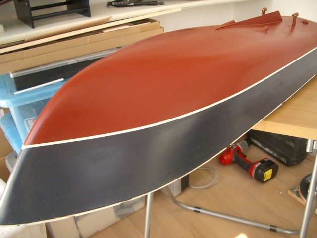

PostSubject: Re: Pilot 40   Pilot 40 EmptySat Jul 21, 2012 3:22 pm
At last the weather has warmed up here in Essex, so today I started painting the hull. I gave it a couple of coats of Halfords Primer Filler, which went on very well. Then masked off the top of the hull, and spayed the underwater area with Halfords Red Plastic Primer, which didn't go on very well. I got lots of spots coming out of the spray, and its left a very rough surface. When its dried thoroughly I will rub it down and give it another coat.
Pilot 40 Imgp2415

PostSubject: Re: Pilot 40   Pilot 40 EmptySun Jul 22, 2012 7:26 am
I wish i had somewhere to spray Barrie, but as it is i have to brush my paint on. You get a lovely finish when you spray paint.
Tony

Tony - I usually spay outside. That's why I had to wait for a warm dry day. If its desperate, I use the garage, but I prefer outside. I have an airbrush and I do use that in my workshop.

PostSubject: Re: Pilot 40   Pilot 40 EmptyWed Jul 25, 2012 3:25 pm
The hull has now been painted ready for some satin varnish, then I will add the boot topping using plastic tape and a final coat of varnish. There is also rather a lot of rubber moulding to go on Smile
Pilot 40 P1000010

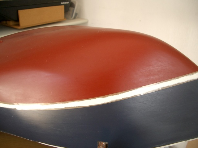

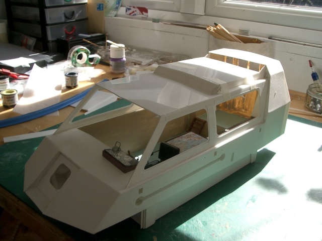

PostSubject: Re: Pilot 40   Pilot 40 EmptySat Sep 15, 2012 2:54 pm
I've been working on the roof of the wheelhouse - a complicated structure. This is where I've got to today. I'm waiting for everything to set firmly before attacking it with scraper and sandpaper to get some of the curves and rounded edges in place.
Pilot 40 Imgp2421
I have also been painting the boot topping. I usually use the stick on plastic strip for this job, but I find it quite wasteful as only a tiny fraction of the widths on the roll get used. I found an alternative technique using Pin Striping tape which has two masking strips at the required spacing on a backing strip. The backing strip is clear so you can see the align it along the joint between the underwater and top colours. The backing strip is then peeled away leaving a perfectly spaced gap for painting!

And finally the finished line. I'm very pleased with the result - I think it is better than the vinyl tape I usually use.
Pilot 40 Imgp2424

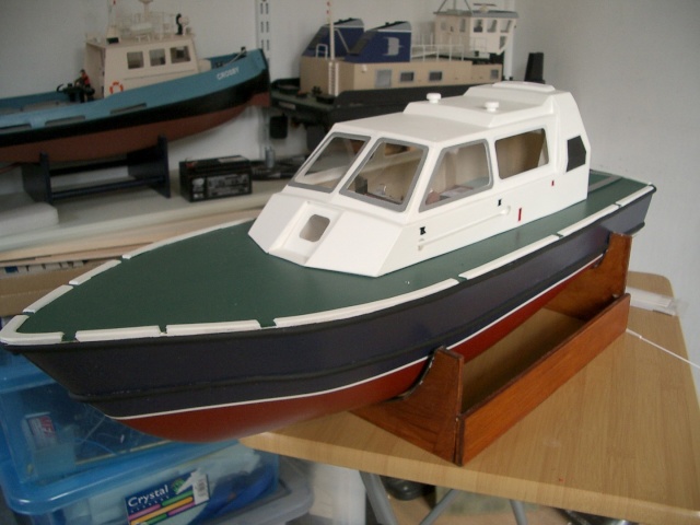

PostSubject: Re: Pilot 40   Pilot 40 EmptySat Sep 22, 2012 12:59 pm
Final post before I go off on holiday again Very Happy
The basic shell of the wheelhouse is now completed and painted - there are some fittings to make or paint, then I will glaze it. Once that is done there are some quite complicated handrails to make and fit.
I have fitted two lots of foam rubber fenders to the hull. These are to be linked by other strips, but I've run out of foam! I'll order some more when I return.
Pilot 40 Imgp2426 Pilot 40 Imgp2427

I've been making and painting fittings for a few days, but today started glazing the wheelhouse.
Pilot 40 Imgp2428 Pilot 40 Imgp2429
The motors and speed control are now fitted - it seems very noisy running on the bench. I guess the hull acts as an amplifier. Hope its quieter in the water Shocked
I'll finish the glazing in a day or two, then its time for the test tank and add some ballast before I start on the railings and finish installing the fittings. I think I now have everything I need to complete the model.

PostSubject: Re: Pilot 40   Pilot 40 EmptySat Oct 20, 2012 5:33 pm
Hi Barrie I must say she's looking good, I wouldn't worry too much about the noise as very often the hull does exactly as you suspect and amplify the noise, plus what seems loud in the workshop often sounds reasonable out on the water with some open space around and no walls to bounce the sound back at you.

PostSubject: Re: Pilot 40   Pilot 40 EmptySat Oct 20, 2012 5:36 pm
Phil - the hull is only an ABS vac forming, so it make a very good resonator Very Happy

PostSubject: Re: Pilot 40   Pilot 40 EmptySat Oct 20, 2012 6:05 pm
I'll bet mate !! Still getting some water around the outside will dampen it significantly if you'll pardon the pun lol!
