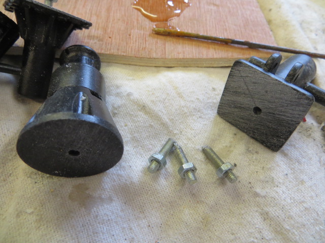

| IT's all the small bits that take the time I didn't estimate on...……. first was adding the threaded screws to the three "bollards" for each boat and then fitting the first to micks boat.    then it was the turn of the two life raft canisters, and the retaining straps and tie links...…..the black straps were made from sticky black plastic and the retaining links from brass wire.    and then i was about to fit them, and i suddenly realised that the floors of the under storage area for the small raft canister AND the entrance to the cabin, had not been painted with the textured aged iron paint, that i had so much problems with........so they both needed painting. however they are so inaccessible for masking and getting a spray can into, i decided to mask off the lower edge of the entrance with tape and carefully brush paint them. i sprayed some paint into a margarine tub and let it go "off" for a few minutes. but even then, trying to paint it with a soft brush left it smearing and clinging to the brush rather than the floor, so, just like stippling grp resin into the matting, I stippled the floors with the flat of the brush rather than the end...…….it looks ok at the moment...…..just have to wait until it cures and dries for the finished result.  and finally, I painted the boat hooks, Baliol blue for the starboard side, and white for the port side. this colouring goes back to the days of pulling/sailing boats when those out on a shout in hurricane gales when little could be heard, the coxs'n could actually shout Blue or white to get the nearest oarsman to use oars for steerage.  might do soe more tonight once the textured paint has dried......gawd, I don't want to mess that lot up. |
