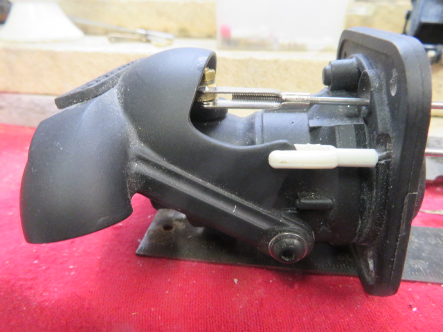

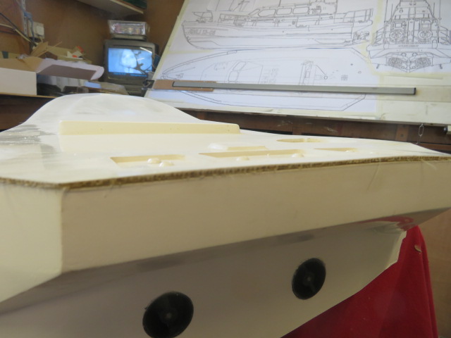

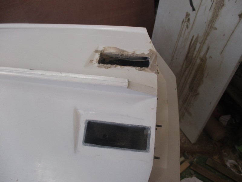

| Time to fit the main induction tunnel bodies. now comes the tricky bit.....the floor of the hull and the rear transom plate where the two parts of the tunnel body fit, are not at right angles to each other, where as the end plate and the intakes are on the actual jets are.......... so I made a surrounding plate 2.5mm thick out of plasticard to go around the intake. This is to give some purchase to the glue where one end sticks above the actual grp hull. I also dispensed with the plasticard gaskets supplied with the kit, in favour of proper repellent gasket material and gasket glue [ahh, remembrance of the times I replaced cylinder head gaskets on my rocket gold star and other old brit bikes, lol]. I did this because the gasket material and glue will contour to the unevenness of the grp whereas a plastic gasket won't. and so it was.....fit the gaskets were fitted with gasket glue both sides, and 5 minute epoxy laid onto the flange and working quickly I got one and then the other glued in and bolted up ready to set in position. on the last shot you can see how even the best of hulls and layers can get one more even thickness than the other........not a problem and unless you are spray laying mould, there will always be slight irregularities in a lay up, and that is why just a few minutes pondering over a subject and the problems that might arise can be overcome without histrionics and cursing the manufacturer.......simple slight problem overcome easily..... I have left the two jets setting until later when I can then fill in those gaps with filler.         |

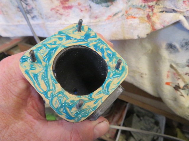

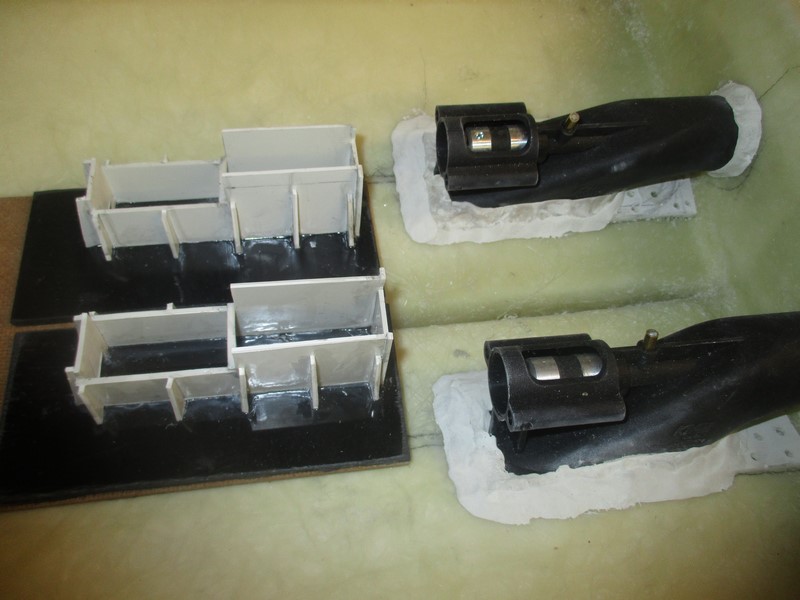

| the jets on both boats have now been well and truly bedded in now, but instead of using filler which, in my hands at least can be a messy finish, I have used Milliput white which is both very sticky and also water proof and acts as a water barrier when pressed home into the cracks............and it also looks far better and neater. first the MBD boat...   and the Speedline jets.   |

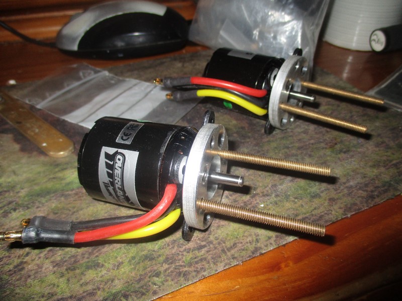

| Began this evening by sanding the surplus filler from around the inlets and outlets to the jets of the Speedline boat and once done, by siting the position of the trays that would hold the servo mounts and the battery holders, Then moved on to setting up the mounting plates for the brushless motors to the main bodies of the jets on the Models by Design boat...………..took a little brain manipulation but eventually got there...….the Speedline boat was much easier, having had the single plate already fitted to the motor. tomorrow I'll set the trays in and screw the servo holders to the trays, before I start working on the hull fittings for the Speedline model...……...the parts are there for that one, but I'll have to fabricate as much as I can for the MBD boat before I stop building until fittings are available for it, and as such, I have gone as far as I can with it, sadly. below, the Speedline hull.   the MBD JETS.  the MBD motors with adapter plates to allow fitting to the KMB German waterjets   The Speedline jets with motors.  below, the Speedline jets with motors.  |

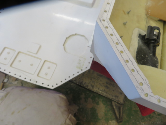

| I've come to the point where I have more to do above waterline and outside of the boats than inside now, and so have made preparations for fixing the deck on the MBD boat.on this boat the deck mould is an integral part of the hull, unlike the speedline model which is a different entity altogether, and as such, once fitted, very few of the workings of the motors, jets and connecting rods will be able to be reached, as the stern counter of the deck covers them and makes then rather inaccessible. so I will wait for the supply of the servos from a 3rd party to come before I fix the deck in place. However this hasn't stopped me from preparing the deck sheet and hull for that moment.first I found the very faint line scored into the deck pronouncing the cut line to oincide with the top of the hull, and marked with a pencil. I changed the blade in my band saw for a much finer toothed one, and then cut ouit the deck.next I offered the deck up to the hull to find that the reverse side moulding of the deck, with the topside recesses for the engine room access wouldn't allow the deck to lie flat on the hull, and so cut out a 10mm piece of the hull flange at the extreme stern by drilling and reaming out to allow the deck to face up fat onto the hull.now comes a point of conjecture...…..I drilled both the deck and the hull flange every 15mm [ didn't count exactly lol] with a 2.5mm bit. some say that they fear it weakens the structure. I say that not only does it strengthen it, it also adds to the gluing and gripping power of deck to hull by around 250% over just a standard lay and but joint......have always found this joint to open up in the event of a head on collision with the bank or a sideways shunt from another equally heavy or fast boat.As in another thread on a US site about how delicate one builds ones boat, I build mine like a brick dunny.          |

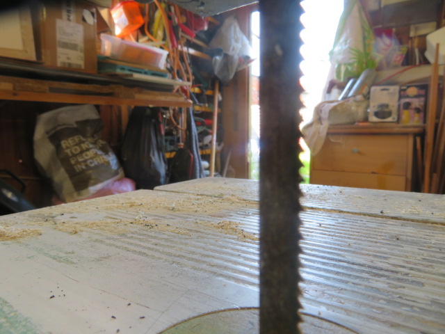

| it is usually one of 3 things, Damien...…..lack of tension on the blade, too wide a gap on the guides to the blade, or quite simply...…...the blade is blunt.
there is a fourth problem and that is the bearings on one of the wheels...……………..but that on a hobby saw is very rare indeed as they take minimal punishment, unless you are sawing logs for the fire all day long...……
check the three above symptoms.

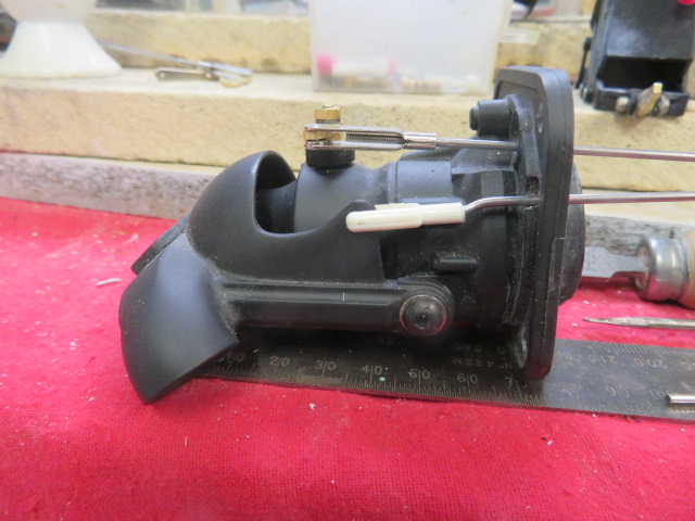

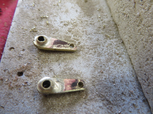

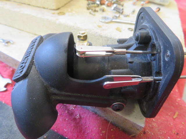

| spent the latter part of the afternoon setting up the link rods and tiller arms for the two different sets of jets. sadly one of the speedline jets has a small fault in that the brass thread and nuts won't tighten on the tiller for directional use of the jet nozzle...…...it also has a crack in the upper mould...……..having moulded fittings for years, it is quite impossible to pick out such a small problem until you get down to the job...……….but have emailed Adrian this evening asking what we can do to get it working again. otherwise I have used either clevis clips and ball and cup connecters on the jets...………..just hate bits of bent wire when you are building kits of such magnitude and standing.     thank goodness for my old sets of magneto spanners.  didn't know whether to use model aircraft snakes to operate the KMB reversing buckets...…….or steel rods...………….in the end I decided on steel rods.  and then it was down to fitting the links to the speedline jets  in the end I settled for a shorter plastic clevis clip for the Speedline reversing buckets.   |
