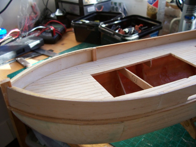

The gunwales have now been fitted - that at the stern was a real problem to fit, and in the end required some filler. I have also realised that I haven't cut the freeing ports and hawse holes Mad. I'll have to figure out how to do that  Shocked There are rubbing strips to fit at the joint between the hull and gunwale.
I have also cut out the bulkheads to improve internal access.

OK - spot the difference, or Barrie's mistake  lol! Embarassed Embarassed I had managed to put the stern gunwale on upside down Exclamation Corrected now and I've started applying the rubbing strips. The stern one is still to do. Given the quality of the wood supplied this is going to be tricky  Rolling Eyes

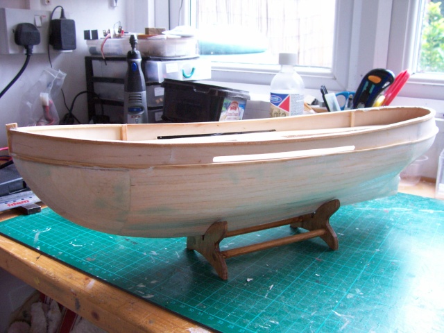

I've now finished installing the rubbing strake at the joint between the hull and gunwale. I have also installed most of the inboard strip to make the gunwale capping - just the stern to do  Rolling Eyes.
I have also successfully cut out one of the freeing ports. It proved easier than I expected  Smile Tomorrow I will cut the other one and try to finish applying all the strips round the hull. Then I will be able to get some paint on it to see what needs filling.
Polish Pilot Boat 100_1033 Polish Pilot Boat 100_1034

I cut the other freeing port this morning. All the strip wood is now on. Just some filler to rub down at the stern - it was tricky getting the strips on round that shape Rolling Eyes. Since taking the photo I have also installed the Bulwark Supports down one side whilst waiting for filler to dry. When they have been fitted on the other side I will treat the top part of the hull with Eze Kote, and then it will be ready for spraying. I am waiting to cut the Hawse Ports until I get some fittings - which is the next job today. Source all the fittings I need to build the superstructure etc. There are non supplied, in fact I realise that all the small parts shown on the ply are to make lamps, ventilators, mast rings etc.
Polish Pilot Boat 100_1035

I finished off the bulwark supports this morning, applied Eze Kote to the bulwarks, and masked off the deck and freeing ports ready for a spray of primer. After a wet morning, the weather has improved to give bright sunshine, although a very cold wind. I took the chance to spray the primer in the sun in front of the garage, after bringing the spray can indoors to warm up Laughing.
As I expected the primer has shown up a number of areas that require attention from the filler Crying or Very sad. So that will be the next job when the primer has a chance to harden. I'm not seeking a perfect hull, but some of the hollows in the planking will need filling.

As you can see in the previous photo and this one, there are quite a few holes that need attention Shocked Today I just added some filler. It is actually quite difficult to see where it is required when you are close up. It will require some serious sanding tomorrow  Laughing
