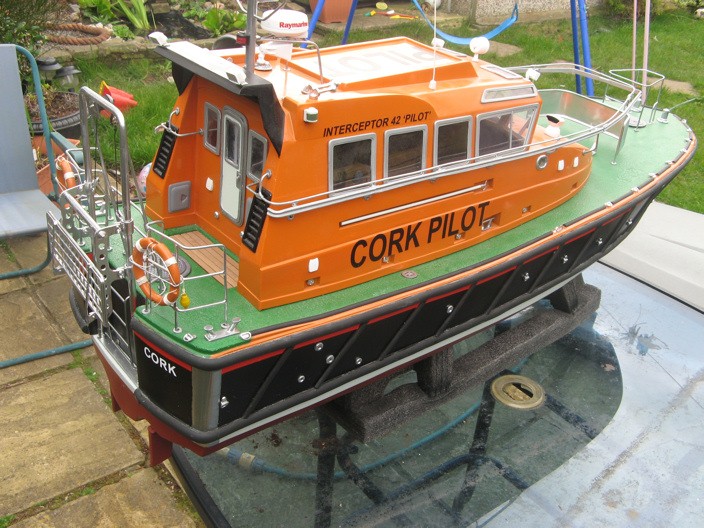

| hi John..... when I designed the full kit of the Interceptor 42' Pilot boat which models by design now market ( I made the plugs for Dave metcalf to sell, but he never got round to it) the superstructure on that was quite an unusual shape, and dave had that made from from a silicon rubber mould and was made by a chap who works ( or did work at the time) for one of the F1 GP teams.........and it did cost a pretty penny. However afterwards we decided that it could have been made in a 3 piece split mould. ![Shannon Build E_copy10](https://i.servimg.com/u/f18/15/04/81/87/e_copy10.jpg) ![Shannon Build Img_0010](https://i.servimg.com/u/f18/15/04/81/87/img_0010.jpg) ![Shannon Build Img_0011](https://i.servimg.com/u/f18/15/04/81/87/img_0011.jpg) the black spray shield above the rear w/t door id an added on piece of plasticard. ![Shannon Build Img_0013](https://i.servimg.com/u/f18/15/04/81/87/img_0013.jpg) |

| JOHN.........THAT IS ABSOLUTELY BLOODY MAGNIFICENT.......
I can't say anymore...........just lost for words. |

| Great to see you back John Your photos are well worth waiting for.What a wonderful model.I admire all your builds,but this one is out of this world. I cant wait to see it Hope you are feeling better now my friend,good to see you back Mick F. | |
