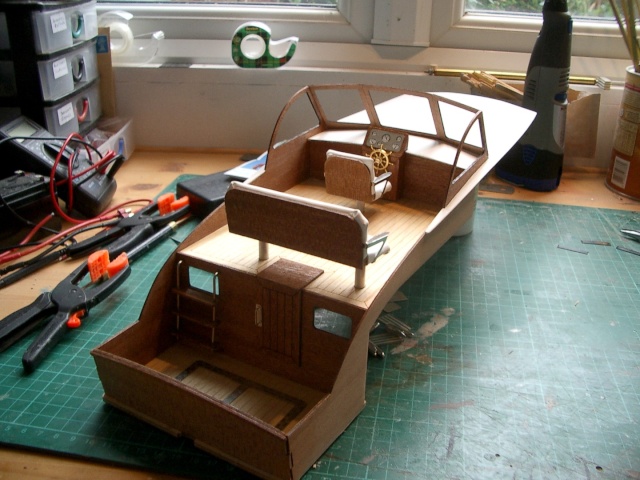

The window frame has broken in the worst possible place. It will be quite difficult to make a sturdy joint, whatever glue you use.
Is it possible to make another fame complete and fit this ?
Cheers and Merry Christmas .
Ken

Posts : 2582 Join date : 2011-11-26 Age : 82 Location : Thaxted, Essex
Subject: Re: Aero-Naut Victoria Sun Dec 22, 2013 9:18 pm
Kenny
Its actually part of quite a large piece and I don't have the material. It will gain some strength when the window frames are added, and if necessary I will add a stiffener on the inside where it wont be too noticeable - I hope.

The final items have been completed over the last few days. The bottom of the hull has had three coats of varnish, the remainder two coats. I used an exterior varnish which has a slight yellow tinge which is not a problem for the mahogany or the red, but I didn't want to tint the white roof, so that was finished with Humbrol Satin Cote.
The windows all went in smoothly. They are laser cut and have protective film on both sides, so I glued the edges with RC Modellers Glue and when dry removed the films leaving almost perfect windows. Actually they are rather too good as there are a lot of them so all the insides are clearly visible - it would have been better if they were tinted.
Despite having plenty of room, I still haven't achieved the tidy wiring I always hope I will achieve
I am considering adding names to the bows and stern - not quite decided yet - the etched name plates don't really show very well.
