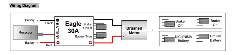

|  Neil Here is an extract from the User Manual (the bit of paper which you probably threw away first....). You will see that the two thick red/black leads each side of the 3-wire cable go to the battery, while the two at the other end go to the P95/2 and thence to the motors. Don't use that switch for the main power supply - it's totally unsuitable. Put it back into the deep dark hole where you found it. I'll send you a big, fat toggle switch to fit into the Red cable between the ESC and the in-line fuse. That will operate the connection from the battery to the ESC - and thus also the radio receiver (via the BEC-thingy inside it). The two little blue tabs are headers which control the brake (don't ask....it's a car ESC) and the type of battery. You should set yours for Brake = Off and battery type = NiCd/NiMH. BTW with that Hitec radio you won't require any P96's because you use the computer EPA (End Point Adjustment) on each of the three channels to set the throw of the servos operating the VS units. Just plug the servos into the receiver - the Fwd/Backwards servos fit via a Y-lead into the same channel - and RTFM. I'll re-do the wiring diagrams for you. Touch nothing until you get them! Postie has been but your communication wasn't with him. Maybe tomorrow, eh? Great will be my reward in Devon......(??) DM | |

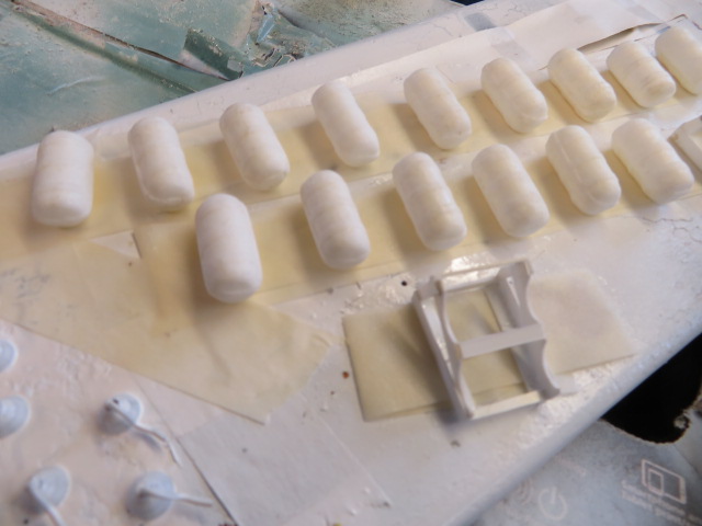

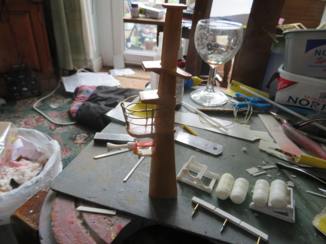

| made a bit of a boo boo yesterday when I painted the mast.............forgot that I had detailing to fit to it before spraying.........so set too last night to do what I had omitted, and then when finished will cut the hardened paint back and respray. I also made the two small life raft canister racks for the aft quarters of the boat deck. Next job will be the main overhead life raft racks..........bit more tricky as they will have to be self standing units instead of being attached to the wheelhouse as well as the boat deck. oh and the strange looking thing with 3 right angled "rods" are the main wheelhouse front window wipers.     |

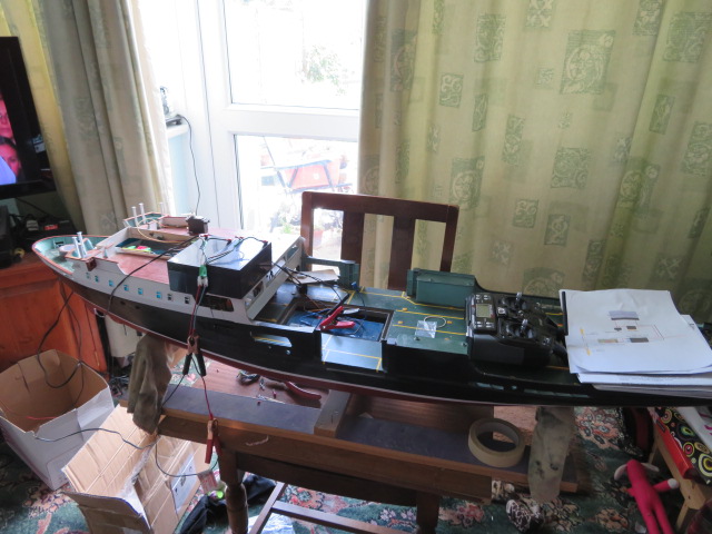

| I DON'T BELEIVE IT!!!!!!!!!!!!!!!!!!!
HAD the TX batteries on charge all yesterday and today, with an intermission over night, put it back in the receiver this evening to set up and......................the TX has lost it's link with the RX and there is a continuous bleeping from the TX.... which on reading the manual, means low battery...............I feel that the battery pack that came with the TX off someone on another forum is about done, and unless they hold any sort of juice, it's going to be another trip to Frodsham for the model shop owner to mate the two up, after buying another battery pack..................will my woes ever end with this bl**dy ship.
just a little frustrated tonight................and I thought I was doing so well.

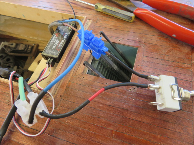

| Well guys,I had made a couple of muck ups. Dave had sent me an addendum to the diagram I had already got and I thought that they were the same so had taken little notice.......I read that I had fitted 2 leads in the wrong sockets of the ESC and so transposed channel 2 and 3 and the motors fired up...........and run beautifully. The second mistake I had made was that the Y lead that runs both servos for fore /aft motion of the boat also had a fault purely of my own making........I had inadvertently connected one servo in the plug ..........black, to white signal wire and therefore neither servo on the Y connection was receiving a signal......thus no movement. Dave told me to check the Y lead where I found my mistake. I sorted these out last night with the continued help and heckling from my friend Dave [who must by now have concluded that I really am a total idiot with electronics], and this morning with the help of the manual [YES I REALLY HAVE READ A MANUAL], remote servo with the wooden calibrations on it I used this remotely plugged into each channel individually on the R/X to set the centre point and then the EPA [ End Point Adjustment], which is critical to the joystick on these voiths so as not to put any pressure on locking them up r binding the blades, and this process went remarkably easily for me....a bear of little brain, lol. so it is now all set up and adjusted on the workshop........but probably need fine adjustment on the water to get the Voiths' blades to idle neutrally without movement of the boat. thank you, thank you, thank you, Dave Milbourn......you are a true star.     |

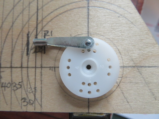

PS Don't forget to reduce the end point on the throttle channel (#3) to about 65%. Umi (aka SWMBO) reckons that the VS units shouldn't be run at more than about 8 volts, so chopping the top speed down by a third on the End Point Adjustment will have the same effect. Apparently they can suffer damage if revved too high. had overlooked that channel, DAVE........now I know the mystical sequence, i'll do that. cheers. |
 | Subject: Re: Jupiter, a Caledonian macBrayne Ferry Thu Jun 08, 2017 2:35 pm | |
| just done it, and by the revs coming out at the top end [63%] I think that she will have plenty of power without reaching those top end revs.

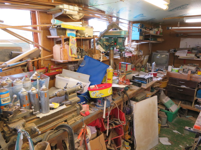

| Everything is now set to enter the final stage of the build..................and then I entered my workshop.......OMG!!!! I HADN'T REALISED..........just how messy and disorganised I had been in the last stage..............boxes upon boxes and trays full of painted fittings.....a lot of cyano is needed................plus a mask, as my sinus's are allergic to superglue odours. Think the tidying and clearing is going to be much more than an hour,.............so off to work I go! Maybe a few days before I hopefully emerge, unscathed.lol.     |
