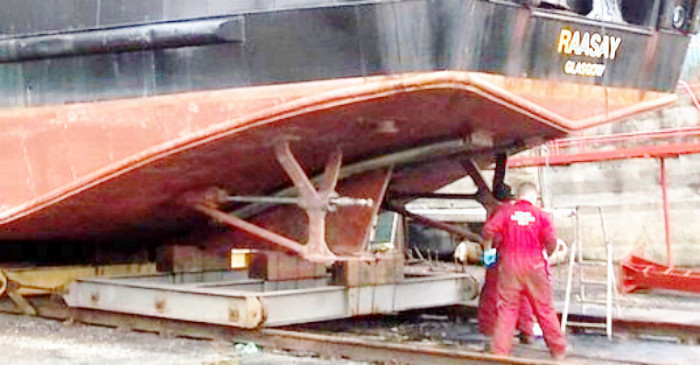

Up early this morning to pick up fibre glass hull Smile. This is going to be my first build with just a plan and no parts cut for me, so I can see a lot off trial and errors happening.Just to warn you this is going to take some time to build so the posts won't be as regular as the speed boat. The plans I presume are the same as yours Barrie. They have made the stern less square on the hull so hope this will solve the reversing issue Question ,time will see. I want to change this area to the same as the photo "nhp651" is that Neil? posted on his Mv Eigg build. What materials should I use and do I need to remove the hard coating in that area. It's in 1/48 scale and not 1/32 as I thought. Will have to start looking for fittings doors,ladders,rails,lifeboat etc in that scale on the net anybody got any recommendations.

With that hull shape you shouldn't have any reversing issues. As for doors - I made my own, as I did with some fittings, but finding bollards and such like is easy as all you need is the correct size, never mind the scale.

At last I've managed to start work on the hull. After looking at the photos of the stern I decided to do a bit of chopping and reshaping to create the V shape. At the moment this just epoxied, will be sealing with fibreglass and filling when prop shafts are fitted.

Any progress on  this build? I've just taken the saw to mine to try to improve its performance going astern. I'm aiming for a profile similar to your hull.
