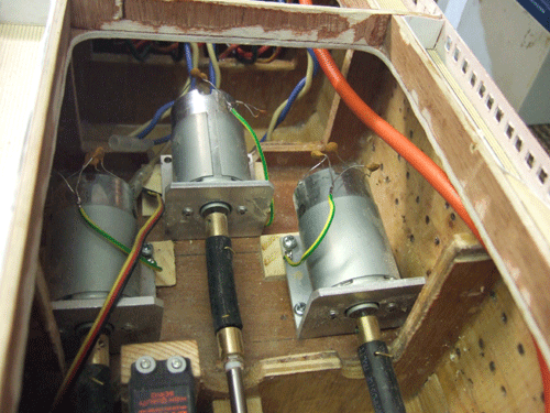

| What voltage battery did you use? try putting them in groups of 3 or 4 or even 5 in series so each group is on the battery voltage, they should draw less that way as they are running on lower voltage.
They are either off or on, so you can be putting too high a voltage through them without much benefit until they just blow. | |

| Brilliant idea. I have now done that and routed four in series and connected these in parallel all down the sides of the boat. It wouldn't run five so it must be alright on four.  I've measured the current draw and it's now only 0.4 amps. Not bad for 50 bulbs. Should last all day on my 7 A/Hr battery. The motors have been fitted along with the rudder servo and the wiring is still in progress. There are three Speed controllers to be connected.   ken | |

| Thank you to everyone for your nice comments. I like the idea of an add on keel. Maybe I'll try one. I'll keep you posted. Came down this morning and the pool had gone down overnight and all the water dispersed. An omen perhaps  I shall continue with the final detailing as there are still parts to go on. cheers ken | |

| Today I stripped out the internals, motors and wiring and weighed her without the top decks. She came to 11 pounds (5 killo) which was not exceptionally high, so it must be the fact that she's tall and thin that overbalances her. A sailing keel is the obvious choice so I'll see what can be done. Ken | |

| Worth thinking about Ole. Thanks for that.  No, I'm not dis-heartened. I rise to every challenge. cheers ken | |
pugwash Midshipman
Posts : 60 Join date : 2011-06-19 Age : 76 Location : amble Northumberland coast
 | Subject: Re: RMS Titanic Mon Jul 18, 2011 12:35 am | |
| Kenny Just to add to my entry about fitting the keel on my destroyer - I took 1/12 lbs of lead sheet out of the boat to make the keel - with this same weight in the boat it turned over. Imoved itdown onto the keel and it is very stable - I could not add any more as it would have taken the boat too low in the water The bulb is about 4 inches long and about 1 1/4 inches across so the top of the lead is only 2 inches below the hull - it doesnt take much of a keel to make it stable. what I did was start with a 6 inch deep keel and keep shortening and trying it in the test tank ( 4 pieces of wood on a flat base with a pvc lining) until I got what I thought was about right without it being too stiff Hope that makes sense. She is too nice to just sit as a display model !! Geoff | |
Tug--Kenny Lost But Never Forgotten R.I.P
Posts : 284 Join date : 2011-06-11 Age : 80 Location : Newport, South Wales,UK
 | Subject: Re: RMS Titanic Mon Jul 18, 2011 10:47 am | |
| Hi Geoff, I spent all day yesterday cutting out the guts of the boat and 'thinning out the frames to reveal more of the bottom. This gives me much more space inside now. This revealed more of the inside edges of the portholes so I have been coating the walls with more clear epoxy to seal the windows better than just from the front.   Doesn't look her best at the moment, but there is light at the end of the tunnel. Now she will be totally waterproof I shall be loading her on the water with lead to find the maximum allowed. (ref your floating below the waterline) and I will then know if an external keel is required. keep you posted. ken | |
pugwash Midshipman
 | Subject: Re: RMS Titanic Mon Jul 18, 2011 11:51 pm | |
| I found the keel quite easy to make - made the half moulds out of plaster of paris - left it a few days to make sure it was bone dry - didn't want a molten lead explosion. then just melted the lead with a plumbers gas blow torch. Worked a treat. drilled it through the plywood and countersunk the bolt holes and filed any rough edges and covered it and the ply keel in West epoxy which was rubbed down and painted a dark grey colour Geoff | |
 | Subject: Re: RMS Titanic Tue Jul 19, 2011 11:55 am | |
| Yes, it's the way to go. The load arm length would have more effect than placing weights in the hull.
The connecting of the temporary attachment would have to be unbreakable when sailing as it's loss would be catastrophic.
Ken | |
