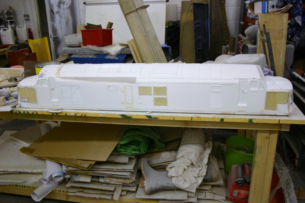

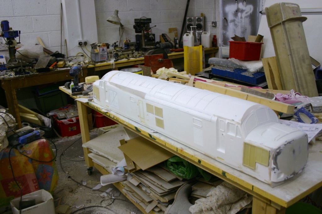

Hi all, been a bit quiet on here of late, sorry..... Anyway, the last couple of months I have been working up a plug for a 5" gauge class 37 loco body, another biggie, it is sitting on an 8' workbench.. Should be ready to make the moulds in a couple of weeks, (just for you Neil it will be a 15 piece mould!!!! yes 15!!)
Sorry the workshop is in a mess...
Mark..

Hi Neil, no the Deltic is a class 55 but they do look similar, this one is 5" gauge (approx 1/12th) motive power can be 4x or 6x 250 watt 24v motors depending on how deep your pockets are (the motors are £45 each)..
David, the plug was initially made from MDF. Then I lay GRP tissue followed by flowcoat gelcoat, this is pigmented white as I find it the easiest colour to see & fix blemishes using the guide coat method, a light spray of black paint & then flatted back until all the black paint is gone..
Mark..
