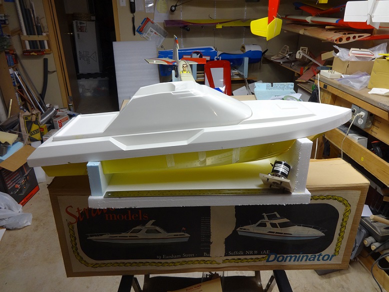

I am building my first boat.  Have been building and flying RC aircraft for many years.
The boat is a "Dominator" kit from Statos Models, Bungay, Suffolk, UK.  Probably from the seventies.
It is a cabin cruiser type with fibreglass hull, 34 inches long with 10 inch beam.  designed for 0.19 to 0.40 marine IC engine.  I will be using an electric brushless outrunner.  Would appreciate any suggestions for propellers, prop max RPM and ESC with reverse.

Thanks for the input so far.  The SK4250-650 is simply a motor I have doing nothing.  With a 6 cell Lipo the unloaded RPM would be 14,000.
This boat will be used for relaxation on a small pond, so speed is not an issue.
I have tried to attach pictures without success!  They are on the Hosting site, but then what!  It is not only boats about which I am ignorant!
Carl (Newboater)

Hopefully this will link to the picture of my fiberglass boat hull - 36" long by 10" beam.
Carl (newboater)

Good to see you have worked out the photy thing 2thumbsup and Barrie has put you in the right direction, good luck and keep us informed please Very Happy perhaps you would put up a thread on your build for all to follow Very Happy
