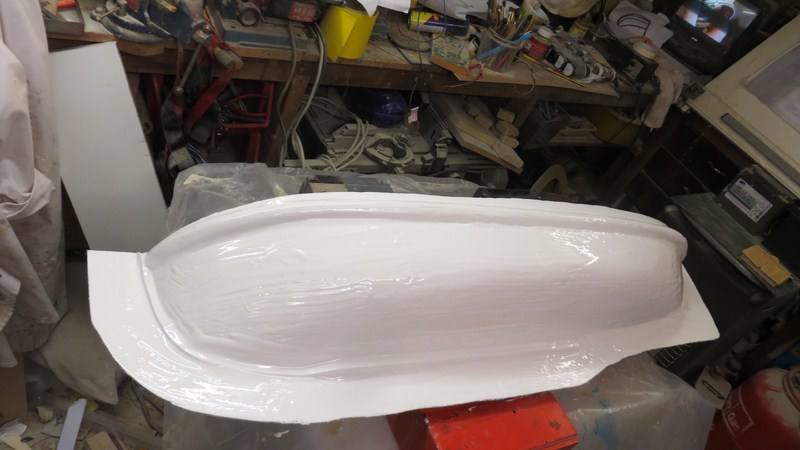

| Day two, 09.00 hours: trimmed up the mould and sanded it all over to remove sharp shards and splinters of matting "needles" which hurt a great deal if you get them into your fingers. Remove the MDF flange and remove any overspill dribbles of resin from the "virgin" half of the plug. wax up another coat.......... |
| Subject: Re: MY NEW PROJECT...or two. Wed Nov 28, 2012 6:22 pm | |
| day two, 16.00 hours..........after a day of waxing the plug, having given it 8 coats of release wax I gave the plug 2 coats of PVA release agent..........hoping that even though I have made the mould in only two halves rather than four pieces.........it will separate with ease. well!!, that's the dream and hope. 17.30 hours the second side of the plug was covered with white gellcoat......here's hoping. |

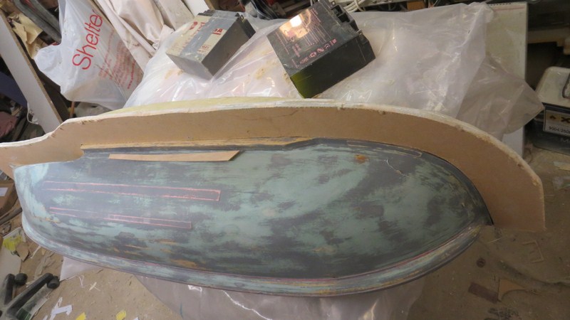

| Just come in from the workshop after starting the layup at 09.30hours.......... on the first hull mould.Two hours ain't bad I suppose. With these lifeboat hulls, where there is such an indentation in the bulwark tops for the belting I tend to do one side at a time down to just past the halfway and encasing the keel which has the ballast weight moulded into it as a feature. Once the firsat side has gone off I trim it up to the bulwark level with a stanley knife (carpet knife) and then start the second side of the mould.....by doing this, I can lay the mould on it's side to stipple well into the belting mould without fear of the other side falling away from the mould and ending up with airbubbles all along the top edge, or worse still half way down the hull side. the mould can then be left for a few minuted whilst the second side is going off before putting the mould on an even keel for it all to cure for the afternoon.........tonight I'll hopefully split the mould and extracate the hull moulding, before I start all over again tomorrow with waxing etc for the second hull...........it's all go. |
