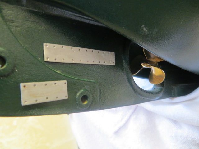

And now and until I start rigging the boat, it's just a case of glueing all the pre made and painted fittings onto the boat, and that's what I was doing this afternoon after fitting the drop keels.,
Hatchets, knives, steering boxes, and foot rests for the rowers, have been fitted......along with a couple of fittings on the engine casing.

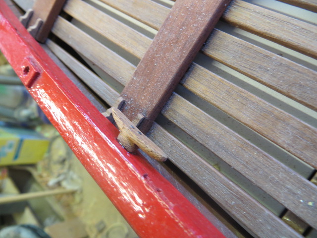

I added the grab rails and offset fairleads to the two boats today, by firstly masking off with ordinary low tack masking tape to stop the drill bits slipping,the grp tops to which they seat, were then marked of with pencil for the positions of the pins in the grab rails were drilled and set into these with cyano and the fairleads were also glued on with cyano
After this I then set to making some wooden cleats for the masts and rigging tie offs.
the mast cleats have been made from laminating two pieces of mahogany together using aliphatic glue, and then, after sanding to width, cut and shaped with abrasive paper..........nothing harder than that........just laborious.......and painfull to the fingers.
I miscounted and made 13..........3 for each mast plus, as it seems...a spare one

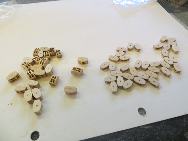

I have only ever given up on one model in my life, but I sat in my workshop the other day and had it not been for the help of HowardQ stepping in and being go between with Keith Jewell at Modelling timbers, I just might have done so.........the thought of having to make over 3 dozen working blocks for the rigging tackle had beaten me, and I just couldn't face it.
It gave me a spur on to know that I was in receipt of these soon so that I could get the rigging up and working. Had they not been available I was very tempted to put the two boats on the back burner.

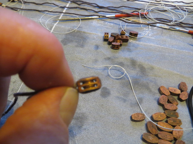

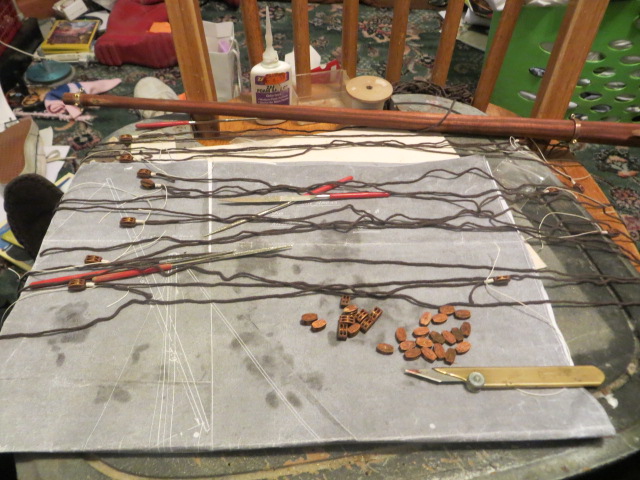

As it is, I have spent the last four hours whipping them into the rigging yarn that I have had for a while, and all is now set to rig all four masts and gaffs and booms ready for taking sail.
there is little to do now on the boats other than the rigging and a few fittings, but as well as whipping the blocks, today I also fitted the wooden cleats to the masts and bulwark sides for tying off the halyards and also gave one of the boats another form of motive power in case the oarsmen went on strike.
Paid a call on my mate wodney,this evening and was a little fed up but he cheered me up and then told me of his own problem of having to wait over a month for a model hull supplier to send him his hull, for which he;s paid up front........and after 31 days no sign of the hull of the trawler..........at least Modelling timbers sent my fittings over night.
It certainly put my moans about my boat into perspective???
anyway, below are a few shots of todays finger aching work.

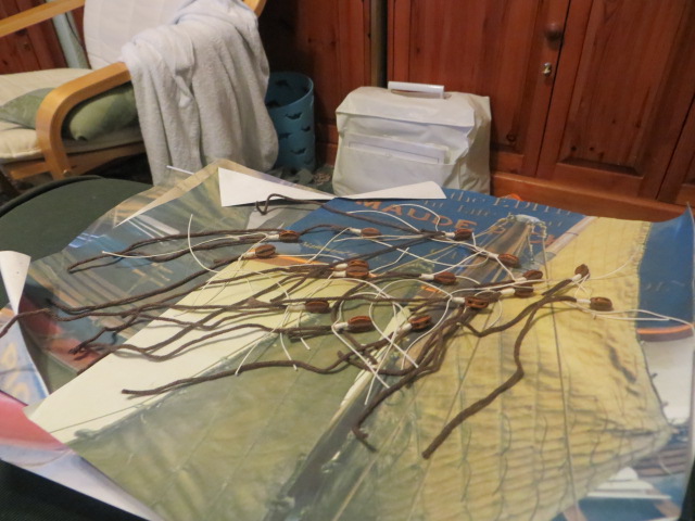

having now whipped all the blocks onto their ropes for the sheets and halyards, today I began rigging them with the necessary turnbuckles and shackles to the spring clips I am going to use for working rigging.
I claim now for the purists, that the rigging on these boats wouldn't have had turnbuckles set into the boats but as I need to drop the masts to fit them into my car to take to the pond, I felt that it would be the easier way rather than untighten the blocks and tackle every time I rig up and so have gone against the scale for this area and used working brass turnbuckles to allow the dropping of masts easily..
the clips to hook up to the rings set into the boats end boxes are from fishermens tackle rigs and have a strain pull of 60 lbs force which should be ample for this sailing rig.. I have begun methodically by starting off with the main mast and will rig that first.
