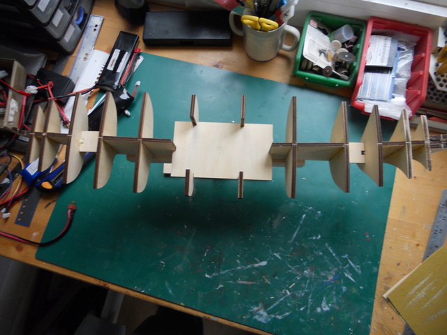

OK -after all the chat, now to business. Back from my hols and I've emptied the shed into the garage, so now I can have a little time for modelling. lol! 2thumbsup 2thumbsup
After unpacking everything I continue to be pleased with the quality of this kit. All the timber looks to be good quality, it was well protected in the box, as are the smaller fittings. The first job was to remove all the bulkheads and keel parts from the sheet. They were very nicely laser cut, juts small tabs to remove to free them, although being 3mm thick it required a bit of pressure to get through.
I have fixed the first 5 bulkheads to the keel, along with the stem extension piece and some doublers. They are glued with aliphatic, but I did wonder if this was needed as they are so tight and this will be a static model.
The stern most bulkheads are not fully seated they will be level with the false keel top.

PostSubject: Re: My Next Project - Marina II   Mon Sep 26, 2016 4:05 pm
All the bulkheads have now been fitted.There will be quite a lot of sanding required before planking can start Rolling Eyes I also fitted what are described as decks, although I don't as yet see the purpose of these.They are below openings in the deck, but the two smaller ones are not big enough to be useful - if I was planning to RC it.

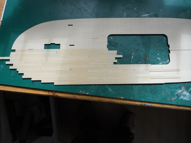

Before the hull planking, the deck needs to be fixed, and that is also planked onto a ply sub-deck. The instructions say to use full length strips, then use a pencil to mark nails to simulate the planks. I decided to use my guillotine that I bought many years ago to cut the planks into strips and use those. Probably more work, but a better result I think.
Here's the guillotine - its not very good really, but these planks are only about 0.6 mm, and it works well. I managed about a quarter of the deck in just over 2 hours this morning. In fact I deliberately took a couple of breaks so I could weight down the planks and let the glue dry - I'm using aliphatic not contact as suggested in the instructions.

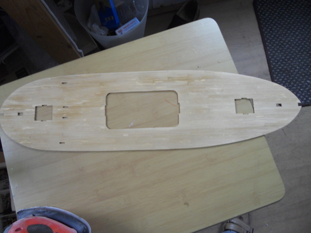

Over the last couple of days I have completed the deck planking. It turned out pretty well I think, just a few gaps caused by fitting the central plank first, then working from the stern to the bows. In the photo the right hand side has had a light sanding. Some trimming to do, then I need to decide if I am going to simulate nails before applying some stain. As the model will not be going in the water, I don't plan to varnish the decks.

I've now trimmed up the planking and given it a coat of Light Oak stain - not sure that's obvious in the photo. Next job is to fit the deck, but that requires the tops of some of the bulkheads to be sanded. One in particular is too high. I am sure it was correctly seated on the false keel as I used a hammer to knock it home.  Crying or Very sad

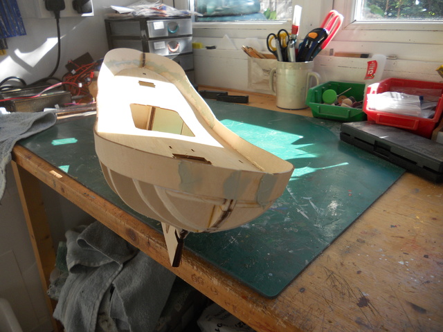

Well, the hedge still needs cutting, but the deck is on. I hope its stuck Rolling Eyes In the end I used Gorrila Glue, the liquid version, and lots of tape Very Happy I did just manage to get a couple of clamps to hold, but there was a lot of tension so I just hope its stuck when I remove them and the tape lol!

Apart from a couple of bulkheads, the deck was firmly stuck. These have been re-glued. I have started the task of shaping the bulkheads ready for planking - this will take some time as there is alot of material to come off  Mad
You can see the gap in one of the bulkheads - that has been cleaned up and re-glued.

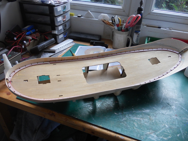

With some difficulty Shocked  I have finished the bulwarks - apart from lots of sanding. The ply is only about 1.5mm so joining the two edges and getting the correct shape was not easy. I used superglue, which of course doesn't fill gaps very well, so I have also applied lots of filler which I hope will also help the joint. Once hard this will be sanded down. The joint will also be strengthened by the bulwark supports which are about the next item to be fixed.

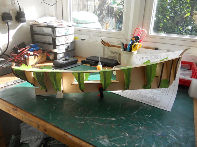

Next job is to fix what are called Waterways - after painting. Strangely these are fitted on top of the planking  Question Exclamation Shocked I did consider removing the planking and fixing them straight to the deck, but the bulwarks are fixed to the edge of the deck including the planking, so I didn't think it was a good idea.
Here they are after painting.
Before fixing them to the deck I covered them in masking tape hoping this will make painting the bulwarks and ribs easier.
Then I started cutting and fixing the supports - the first three from the bow needed bending to follow the curve of the bulwarks. I also fitted two strengthening pieces in the bows. The supplied pieces were very stiff, so I made new ones from 1mm ply. The tops of the supports need sanding down when the glue is dry.
Just the other side to do, then paint the bulwarks before attaching the inwales etc.

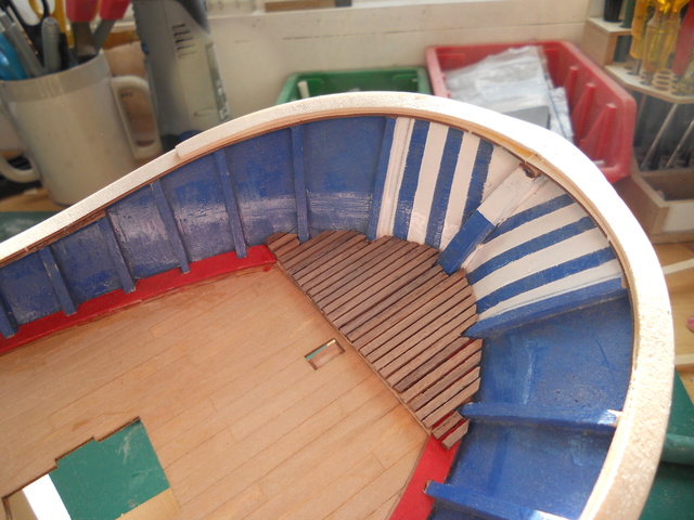

After touching up the paint on the waterway, I made an attempt at masking the bow area for the white stripes. I don't think I got it quite the same as the pictures, but hopefully it will look OK after the tape comes off.
As I couldn't do any more sanding in preparation for fitting the inwales, I started to make some of the smaller units that go on the deck. These are for hofding the fish I believe. At the moment they have sharp edges, but as I suspect they are moulded from fibreglass, I will be rounding the edges a bit before painting.

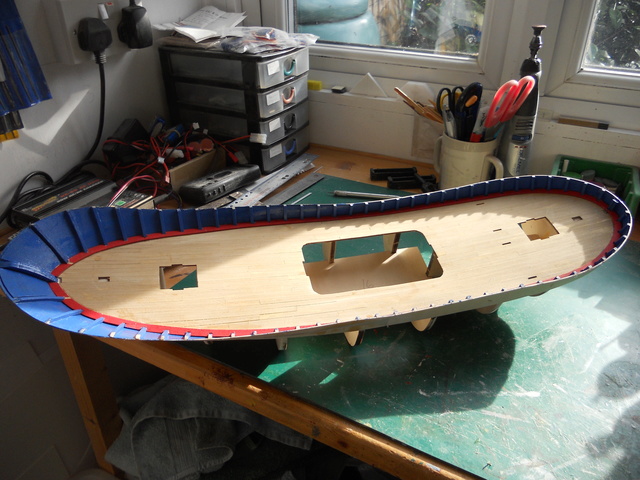

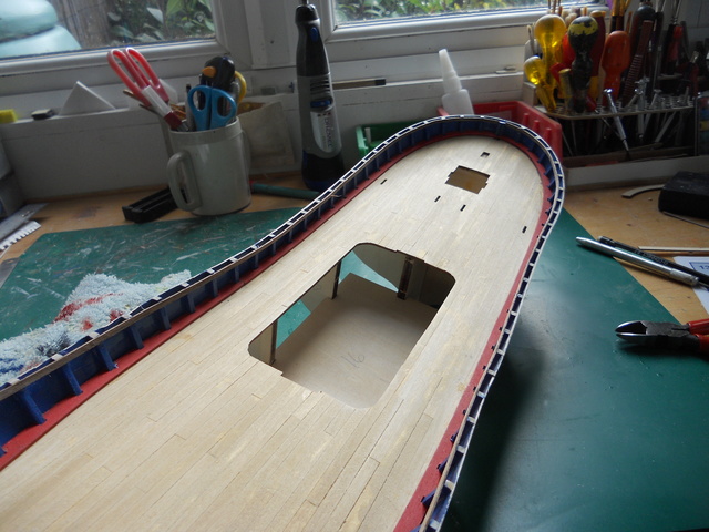

After removing the tape and a little touching up of the blue, I am quite pleased with the effect.
The 'wells' have been sanded to remove some sharp edges, given a couple of coats of sanding sealer, and one of blue paint - another coat of paint will be required. I have also started making the two companionways - these are just the basics - lots of detail to add.
and finally for today, I finished sanding the tops of the bulwark supports and then fixed the inner support rails for the inwales ready to battle with the latter next session Shocked .
There is still quite a bit to be done before the planking starts.

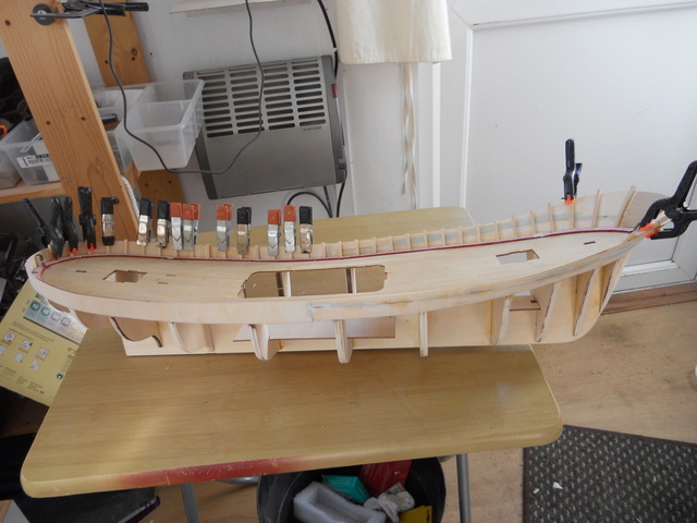

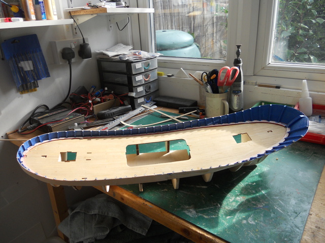

Three quarters of the inwales installed Thumbup The fourth didn't want to go, so I left it for another day. I did a bit of sanding and filling on the three that are fixed, and gave the wells another coay of blue.

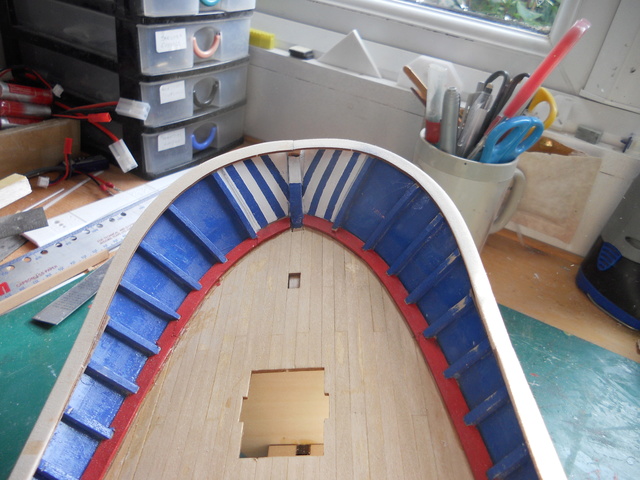

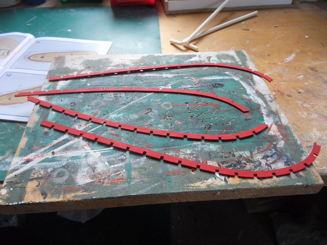

I have at last managed to get the last piece of inwale fitted - but only after cutting it into three pieces Crying or Very sad I think my troubles stem from the issues I had fitting the bulwarks. Obviously these were not fitted correctly. I hope that I will be able to make it look OK after lots of filling and sanding lol!

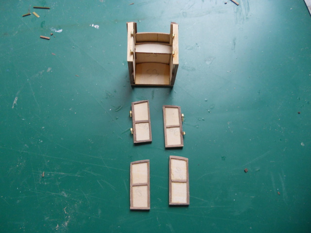

The companionways have had more detail fitted - just the doors and hinges to go.

After sanding the latest filler round the inwales, I turned my attention to the companionways. The doors have now been fitted with framing, and I have made and fitted the hinges for one of them. These are turning into a project in themselves.  Laughing
Posts : 1216
PostSubject: Re: My Next Project - Marina II   Sun Nov 06, 2016 12:46 pm
That's one ready for painting Thumbup I made 6 sets of hinges with not too many problems, but numbers 7 and 8 are not going well!  bounce
I have filled the area at the bows which was not covered by the inwale, so that is now finished until I apply some paint to show up all the problems. There is another layer to the inwales at the bow and stern. The bow is done, stern still to do, and I have started making a raised area of deck at the bow. When these two jobs are finished I think its on to planking  Rolling Eyes To give me something else to do whilst planking, I have bought a vac moulded lifeboat - this is actually the first model I made when I re-started building  model boats after my retirement.
In the last photo you can see the kink in the starboard inwale caused I think by the incorrect fitting of the bulwark. When finished Tthe model will be displayed port side out lol! lol! lol!

Raised deck section now complete. I was going to fit the second layer to the stern inwales, but they don't fit Crying or Very sad, so I will have to make some new ones. Before I do that I will start planking. Shocked Laughing. I think it will be a long session. The pins supplied have a domed head and appear to be left in after planking is complete - I think I will use my normal method and pull the pins after the glue is stuck. I am also thinking of using balsa for the bow and stern, but I will decide when I see if the planks will go where they should. I don't think the planking is intended to show in the finished model, so it wont really matter if I do use some blocks. Rolling Eyes
Still not sure if the hole behind the decking should be there, or if I should have planked over it Rolling Eyes
Posts : 1216
PostSubject: Re: My Next Project - Marina II   Tue Nov 08, 2016 1:09 pm
Two planks have been fitted each side. The supplied timber is quite good quality and with a short soak in hot water bends nicely. However, there will be a lot of filling required if these first two planks are any guide Mad Mad So far I have used superglue, but I think I will change to aliphatic until it get more tricky.
The next planks will probably be at the keel line and then I will alternate, planking from both directions as it were and meet in the middle hopefully.
