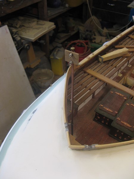

And onto what I have done over the last few days.
First was the signalling/running light at the fore peak.........a simple construction of brass/copper tube, with a small 1.8mm ply plate with holding brackets of brass glued to it. the small hooks to hang the lamp onto are from fittings to the Anne Letitia Russell, and small brass rigging eyes. the upper fixing bracket is from the hand rails to the Rother class lifeboat, and the base socket is from a fitting I made for the Mary Stanford ( I think.???)
Why make new ones from scratch when similar ones will do??.........
I ain't a rivet counter so modellers licence comes to help here.
