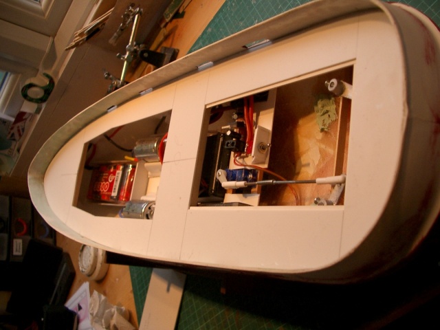

Posts : 1634 Join date : 2011-11-26 Age : 78 Location : Thaxted, Essex
 | Subject: Re: Dean's Marine Tug YARRA Wed Dec 19, 2012 8:08 pm | |
| I have now completed the wiring etc. The BEC I was going to use proved inadequate for the job so has been replaced by a home made one which seems to be OK. I have now fixed the deck down . I used a gel Cyano glue and it is now ready for a little filling round the edges, although it is a pretty tight fit. Since the photo was taken I have started on the coamings for the wheelhouse and shaped the wheelhouse to fit the shape of the deck. I have also applied the anti-fouling colour. I used the Humbrol colour suggested by Deans, but it seems a bit odd to me. I usually use Halfords Plastic Primer, the problem with this is 1 - you need reasonable weather to spray, and 2 - its difficult to touch up if you scratch it  Barrie |
nhp651 Captain (moderator)
Posts : 3432 Join date : 2011-06-11 Age : 67 Location : Fleetwood Lancashire
 | Subject: Re: Dean's Marine Tug YARRA Wed Dec 19, 2012 9:04 pm | |
| i'm glad someone is organised when it comes to putting radio gear and batteries into a model..........I just hope for the best and fit what goes in the best I can..........totally disorganised to a fault.
neil |
 | Subject: Re: Dean's Marine Tug YARRA Wed Dec 19, 2012 9:18 pm | |
| I'm not sure about organised - I really struggled to fit everything in this one. I can just about access everything I need to with the deck on. It would have been easy if I hadn't decided to use the ACTion ESC/Mixer. An mTroniks Viper would have fitted easily. As it is I have not managed to fit a fuse so will just have to hope the props don't get jammed.
Barrie |
phil winks Master
Posts : 586 Join date : 2011-06-12 Age : 62 Location : Taunton
 | Subject: Re: Dean's Marine Tug YARRA Wed Dec 19, 2012 9:27 pm | |
| To be fair barrie I've never fitted a fuse, I just ensure the esc can handle the stalled amps of the motor and touch wood so far never had any sort of an issue. in fact the only esc I've ever fried was back in the early days I parallel wired 2 bty banks to increase run time with out a schottky diode and because of a slight imbalance in the charge the resulting back charge through the esc from one bty pack to the other resulted in the obligatory white smoke, I'll never make that mistake again lol. |

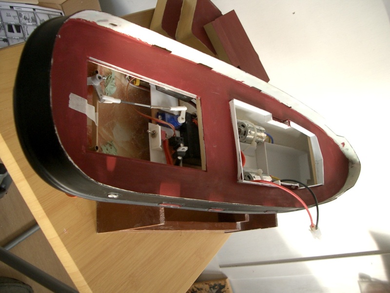

 | Subject: Re: Dean's Marine Tug YARRA Fri Dec 21, 2012 2:21 pm | |
| I have now fitted the coamings for the superstructure, and trimmed the moulding to fit. All the freeing ports and the hawse openings have been finished - the hull painting can now be finished when I've marked the waterline. I have started constructing the wheelhouse - lots of bits and lots of windows. The instructions say to fit each window individually, bu I think I will probably just stick the glazing sheet to the inside. I would like to use tinted glazing but I'm not sure if I will be able to find any. The prototype had bright blue windows which did not look quite correct to my eyes.  Barrie |

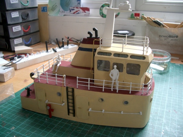

 | Subject: Re: Dean's Marine Tug YARRA Sun Jan 13, 2013 2:11 pm | |
| Today I started fixing the railings - not my favourite job especially with white metal stantions  Part way through to give me some encouragement to finish, I tried the wheelhouse and funnel to see how it would look.  I did actually finish this level - there is another set on top of the wheelhouse  The railings still have to be painted! Barrie |
 | Subject: Re: Dean's Marine Tug YARRA Tue Jan 15, 2013 5:55 pm | |
| Railings now fitted and painted to upper level. I've started making the mast assembly and have been painting more fittings. Today the micro strip arrived at last - its over a month since I ordered it. The first supplier waited two weeks to tell me they were out of stock and couldn't get any more, the scond took over a week to deliver. I can now detail the bulwarks and finish painting the hull. Barrie |
