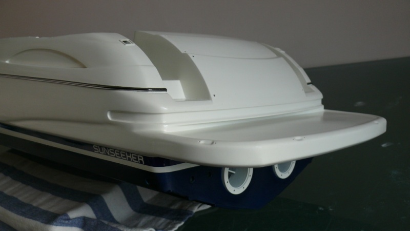

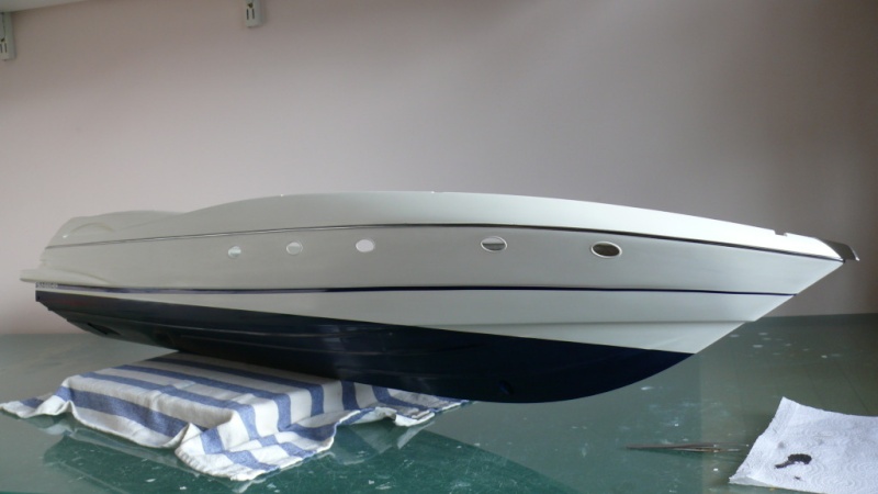

Finally the hull gets a top-coat above and below the waterline.
Graupner Manhattan 74 - Page 2 P1000221
Masking off the rubbing strake took quite some time and makes it look oven-ready.
Graupner Manhattan 74 - Page 2 P1000222
I used Alclad paints for the chrome effect, and was quite pleased with the results at this stage.........
Graupner Manhattan 74 - Page 2 P1000223
...........right up until I peeled off the masking tape 4 days later. What can I say? I didn't get a good edge, and that's the first time
that this has happened to me using Tamiya tape. Considering just how many stripes there were on my last model boat, each one perfect,
to have this go wrong now on a gin palace is seriously frustrating.
Either I didn't press it down hard enough, or wiping the strake with a paint-prep wipe was a mistake - the moisture of the wipe lifting the edge.
Whatever, I don't have the budget to repaint the hull, so I'll have to live with it.
Maybe I can tidy the edge a bit with some very fine wet and dry as the white top-coat has already been flatted with same to take the final
clear-laquer coat.
The Sunseeker stripe is dark blue vinyl. I'm now glad I didn't try masking that as well. lol.
Graupner Manhattan 74 - Page 2 P1000224
Graupner Manhattan 74 - Page 2 P1000225
Graupner Manhattan 74 - Page 2 P1000226
Graupner Manhattan 74 - Page 2 P1000227
As you can see, I did not like the colour scheme in the box-art, so found a different one on the net.

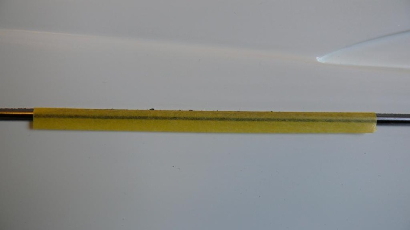

Thanks Damien, it would look much better if it wasn't for my silly mistakes.
The previous photos don't show it very well, but I've found the macro setting on the camera now, so....
This was the problem - nasty blow through. Yuk!
Graupner Manhattan 74 - Page 2 P1000228
Desperate measures required. Tape up desired edge
Graupner Manhattan 74 - Page 2 P1000229
Wet-sanded the scruffy bits with 1500 grit
Graupner Manhattan 74 - Page 2 P1000230
Incredibly it seems to be working. Who'd have thought it!
Graupner Manhattan 74 - Page 2 P1000231
Wow, it actually looks okay. Skin of teeth job to be sure, but much less hassle than repainting everything.

Hi Neil,
Well, okay then. A little something to be going on with..
Graupner Manhattan 74 - Page 2 P1000437_zpshethcl0x
Graupner Manhattan 74 - Page 2 P1000417_zpsbul3g72b
Graupner Manhattan 74 - Page 2 P1000453_zpsquqne6cj
Graupner Manhattan 74 - Page 2 P1000482_zpsnbeoibtr
Graupner Manhattan 74 - Page 2 P1000488_zpsus0ywzcw
Graupner Manhattan 74 - Page 2 P1000466_zpsl3sirvyi

Lol, thanks Neil. I'll take that as a compliment. None of those pics show kit parts.
The kit makes no provision for any kind of interior at all. It just has opaque black plastic widows that you stick on with tape.
A little like the black stickers that go on the lexan bodies of modern RC cars.
But we like scale boats here, so that was never going to cut it. I'm just winging it and hoping for the best.

Apologies for the delay, but have recently started cracking on with the build again. I need to dig out my camera after the move; lots of stuff yet to be unpacked after
a year. Rolling Eyes
Hi again Andy. Hope all is well. I'm unlikely to be back near Yate again for the foreseeable future as I've moved to Amsterdam. Not sure if I'm coming back at all yet
unless the EU business goes pear-shaped. Maybe the best I can do is a video when it's finally finished.
Hi Drunkenmatelot, no clue what marinetric means. Am just following the monkey see, monkey do, or in this case monkey build. Just basically copying this example
http://www.boatbookings.com/yacht_search/yacht_view.php?pid=2583 to the best of my abilities. With a dash of modeller's license to help what little sanity remains.
I've used the kit styrene portholes to give a clean shape to the apperture, and I've got myself an elipse stencil so I can cut a slightly smaller one to fit behind the main opening.
I may or may not paint this inner one chrome. I haven't decided yet.
