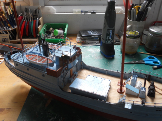

| The ladder on the port side and its handrails have been fitted and painted. Two more winches have been built and the anchor winch has been painted as have the forward railings. Next job is to rig and fit the forward davits - presumably used for cargo loading. When they are fixed all the other deck items can be fitted. Barrie ![RCMP St Roch- an Artic Patrol Boat - Page 2 Dscn1341](https://i.servimg.com/u/f89/17/07/25/93/dscn1341.jpg) | |

| Thanks Neil, but the photos really don't show how poor some of the modelling is. I am not interested in warships, so I tend to seek out the unusual. However, I think this will be my last POF, and probably my last Billings. Next up will be a Graupner Krabenkutter which has an ABS hull ![2thumbsup](/users/1413/25/46/12/smiles/2302161080.gif) I also like the Aeronaut Pilot Boat, currently subject to a build log on Mayhem, but its quite expensive and all ABS. Barrie | |

| The boom has been re-made and re-painted. The boom support has been fitted and also some railings around the platform which protrudes from the foredeck. The only part not made and fitted is a sledge. I have also found some life rings. I have started my simplified rigging, but not yet tackled the ratlines ![Shocked](https://2img.net/i/fa/i/smiles/icon_eek.gif) . Barrie ![RCMP St Roch- an Artic Patrol Boat - Page 2 Dscn1347](https://i.servimg.com/u/f89/17/07/25/93/dscn1347.jpg) | |

| nothing wrong with your build quality, barrie………...anyone who can put a billing POF model together as good as that is, to me an excellent builder......
why do you think I always build with GRP hulls...……..easier to get a nice finish on them. |

| I need to post some close-up shots then you will see why I am not happy. Will try to do that tomorrow. The overall impression from the photos is OK and would it be fine for a model on the water, but not as a display model.
