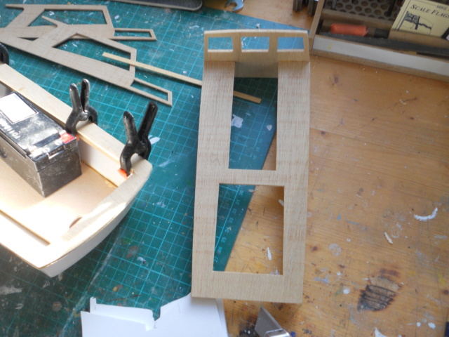

|  More progress today. Decks rubbed down - I think they will be OK now. The cabin sides joined to the bulkhead annd rear deck - hopefully NOT to the main deck  - there is some tape under the rear deck and at the bows. Next job - if these bits are stuck securely - will be to sort out the windows at the front of the cabin. This is where I had the problem yesterday. I have made a new one, but can't be sure it will fit until I can try it out. Barrie | |

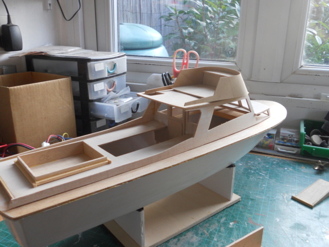

| Another good session this morning. All major assemblies now constructed. In particular the upper steering position. I though this was going to be difficult, but in fact it went well. I decided to use CA with accelerator, and stuck it in sections. The floor needs to be planked so I will do that before fixing it to the upper deck. The main well has to be fixed to the underside of the deck. It too needs a planked floor, so I think I may do that before fixing in place. The rear well just drops in and will allow access to the steering servo, and possibly a switch. Soon be time for painting  That is going to be a bit of a problem as the weather is unlikely to let me spray outdoors, so it looks like brushing. At least most of it is white  I do have a strip of moulded plastic to go over the deck to hull join. I am undecided whether to fit that before or after painting. It is sort of white and I don't know how well it will take paint. Barrie  | |

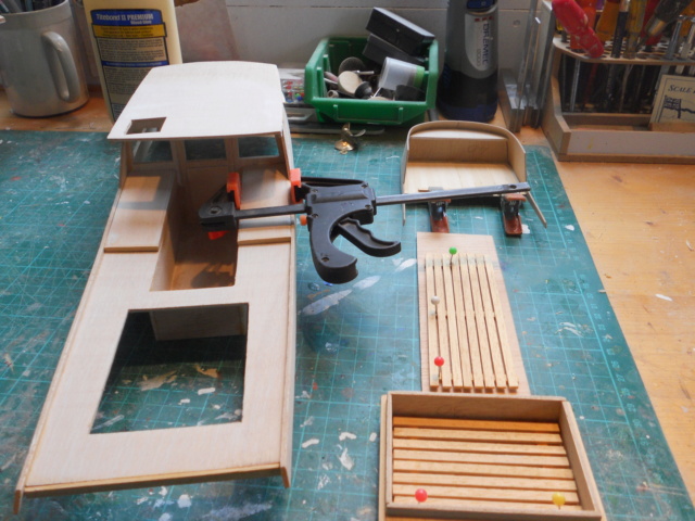

|  The steering position deck has been planked. I used some lime that I had as I thought the supplied mahogany was too dark. I will stain it teak. I also made the two floor gratings for the wells. The main well has been fixed to the cabin structure, and two ramps made and fixed, along with the cabin door. There should be a rubbing strip on the hull at the stern, but I can't find the stripwood detailed so I will have to see what I have in my stock. The next major job is to install the running gear and sort out motor and servo mounts and decide where the batter is going. There is plenty of room for everything as I will use a small 7.4 volt LiPo battery. Barrie | |

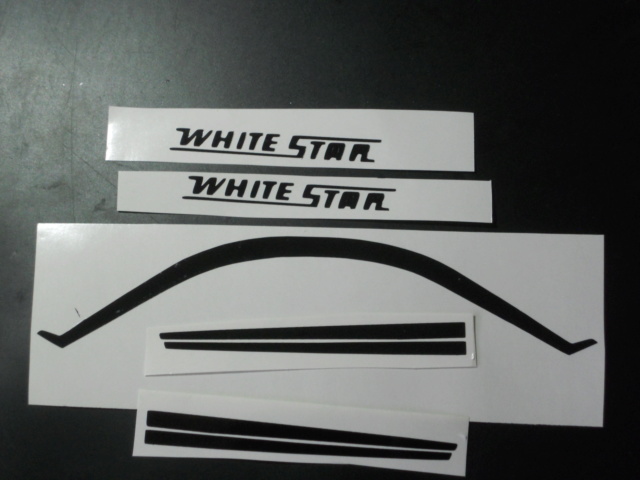

| I wasn't happy with the decals supplied with the kit. They are printed on clear plastic film. The sheet had been folded and some were coming away. I know from Will Everard that the adhesive deteriorates so I decided to try and cut them in new vinyl. A couple of hours with two computers, a couple of programs, a scanner and my vinyl cutter and this is what I have.  I still have to 'weed' the names to remove the inner parts of the A and R, but otherwise I'm quite pleased with these. I think these will look better than those in the kit and will last longer. This adhesive has a five years plus outdoor life. Happy Christmas to all, Barrie | |

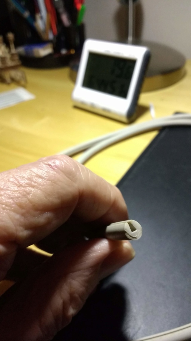

Not sure what its made from Neil - plastic I presume. This is what it looks like  I was thinking of using either canopy glue on the edge of the hull/deck join, or running thin superglue round the edge of the moulding underneath, hoping capillary action would take it in. Barrie | |

|  The moulding is on - or most of it is  . It is not stuck and I don't think it would be possible to stick it as it was attached as it was struggle to get it on. The channel in the moulding is 2mm, the deck/hull thickness varies from 3m to over 4mm where the glue is thick. My idea now is to run thin superglue into the joint shown here between the moulding and the hull and hope capillary action will take it under the moulding  . I don't really want to do it at the deck/moulding joint as it will leave glue marks on the deck.  Barrie | |

| ahhh, cheers...………...wondered whether it might have been rubber or silicon based. cheers. |

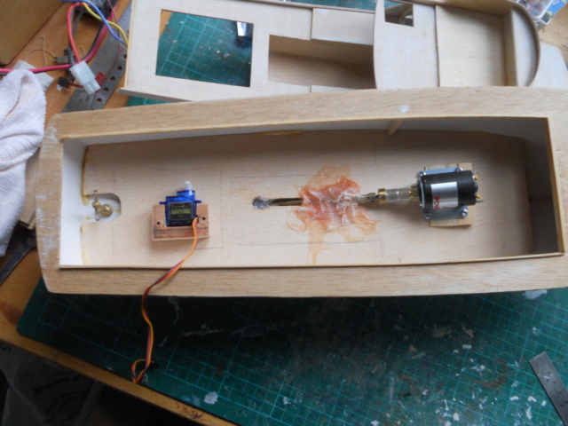

| I was going to start on the railings, but decided I should finish off 'the works' before I made access more difficult  . Although there is lots of space I still had some problems fitting everything in. This was compounded by the wiring on Mtroniks ESCs which is pretty rigid, and the need to use plugs and sockets for the battery.  I still have to fix the ESC - I'm waiting for some epoxy glue to come - and also build a box for the battery before I complete the wiring with a switch and possibly a fuse. Barrie | |
 | Subject: Re: White Star Fri Jan 04, 2019 9:45 pm | |
| always fit a fuse mate..……..its worth the tiny expense to save the heartache of a blown ESC. |
