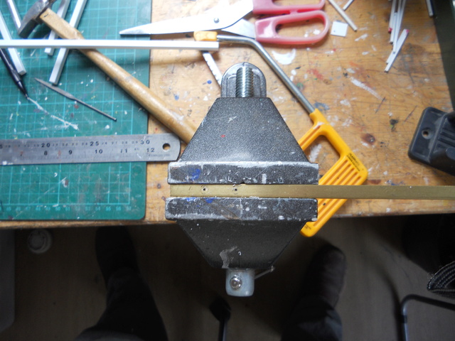

A bit of a hold up - I made a mess of shortening the prop shaft so had to order a new one Embarassed, and then I made a mess of my thumb trying to take control of a rogue clematis lol! lol! lol!

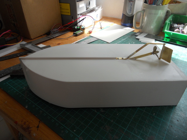

My new prop shaft arrived yesterday so this morning I managed to make a little progress - still struggling with the thumb Crying or Very sad
The propshaft is tacked in place and a support for the inboard end fitted. I've started on the mount for the motor, but it still need lining up accurately. The rudder tube is in but not fixed - I added some scrap card to give better support, and will probably add a support from the transom.
Next jobs are to finish the motor mount, permanently fix the propshaft and build a servo mount. Then I can add the deck and and sides.

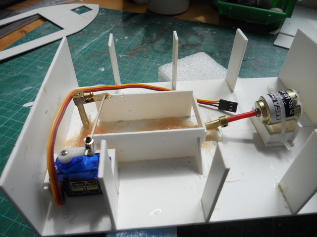

The prop shaft is now fixed in place with P40. I roughed up the card before applying. The motor mount is fixed in  place and a coupling made from cable insulation.I added a collet to the prop shaft so it doesn't slip.
I tried a couple of options for the battery location, but ended up as you see it. I built a servo mount which is not yet finally positioned - I need to make up a tiller arm before finalising its location. The ESC and Rx should go either side of the propshaft when I source them Rolling Eyes
Once the servo linkage is sorted I can fix the deck and sides, and get onto the interesting part - the superstructure.

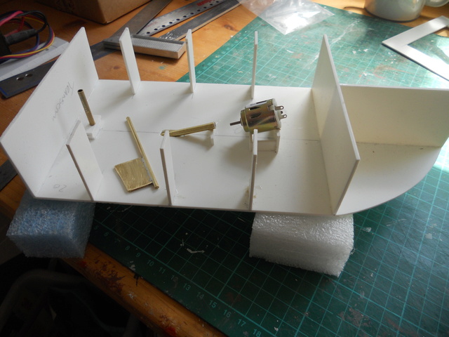

The servo has now been installed. I had to cut down the mount I had made. It is unlikely that I will be able to remove the servo as one of the screws is well hidden when the deck is on Embarassed.
Since taking the photo I have stuck down the deck. Next job is the sides, then I can see if it floats lol! lol!
. I also made a skeg from brass strip which need fitting.

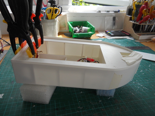

Despite it being 32C in my workshop, I have now fitted the sides to the hull. Its not the most attractive hull, or the most efficient, but the purpose of this build is the superstructure Shocked
When I had fitted the first side I realised I had made a mistake with the transom as it did not come above deck, so now it has an extra skin lol! lol!
I also fitted the skeg that I had made earlier, so I think I am ready for the test tank - the kitchen sink should suffice in this case lol!

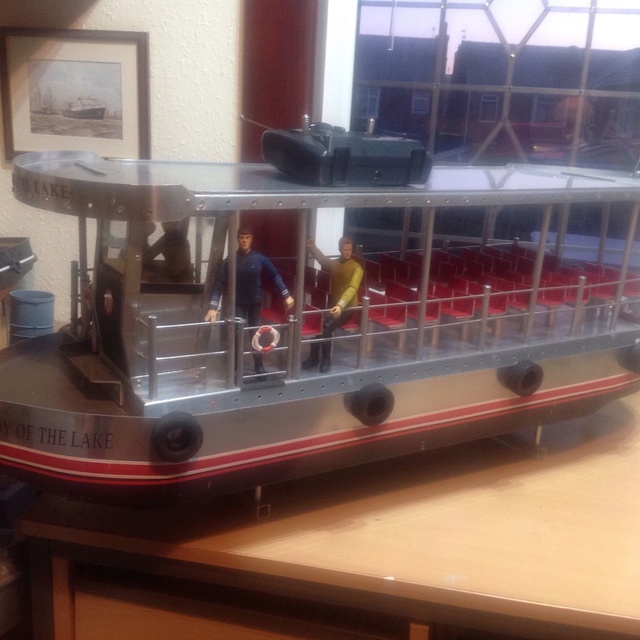

he solar cell arrived today - from China via London as I suspected. bounce
The passengers have boarded, along with the crew. The roof has been painted and lettering applied - you can't see in these photos but she is called Solar Queen. The roof and solar cell are not fixed yet as I am deciding how to fix the solar cell so that I can remove it later if I want to try solar power for real. Rolling Eyes
When the hull bottom paint has hardened I will re-mask and paint the upper part which will be silver with a green stripe.
