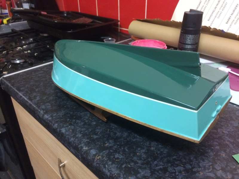

 | Subject: Re: AeroKits Sea Urchin Wed May 16, 2018 5:30 pm | |

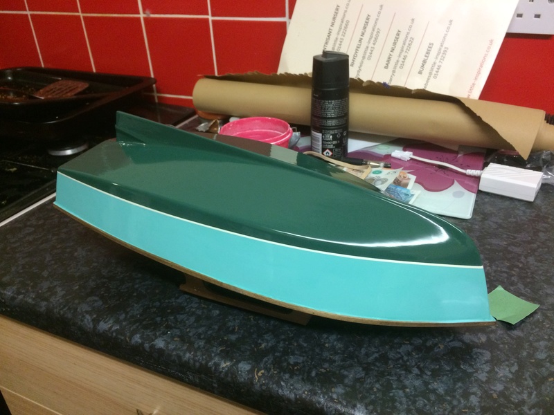

| After the rub down. As you can see the hull is now totally flat, and the boot topping line is pretty much part of the hull with no ridge, there are a few tiny spots along the line where it is a little raised but those will fill in over the next few coats, I’ll now go and finish the boat in thin coats until I have the surface I require for a good polish. It wasn’t that much work, took about an hour with some 1000 grit and water to clean up, I’m glad I attempted this now as doing it earlier would I expect resulted in rubbing through the paint, here I only had one tiny spot of rub through at the bow to which a paint brush and a drop of paint sorted and I sanded that back, feathered into the hull and you now can’t even see where this was. It’s slow progress but it will pay off in the long run, this is the first time I’ve attempted to coat a finished painted surface on a boat with this varnish,( first attempts were on stands to which I had good results for trials) so going slow and steady and learning by what I can and can’t do is paying off for a good finish. I’ve used this on deck work countless times but varnish on bare wood is much more forgiving for a sand though mistake where as on paint removing the paint is a disaster. Overall besides the amount of work and time it’s taking I am confident for a decent final finish to the hull and pleased on how it’s turning out. But you know what they say “slow and steady wins the race” and in this case slow is working well although I’m having to fight my usual impatience! On a side note my Mrs gave me one of my birthday presents early, it finished my Star Trek collection off nicely, although I know she overpaid but totally worth it, now I just need to find a shelf big enough for 140 star ship models!!!     _________________ I'm Not Anti-Social, I'm Anti-Stupid.
Posts : 1716 Join date : 2011-06-10 Location : Aberdare South Wales
 | Subject: Re: AeroKits Sea Urchin Wed May 16, 2018 11:19 pm | |

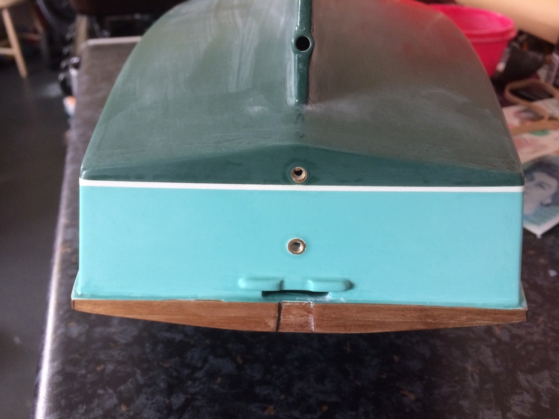

| Things were going so well... I guess my little paint repair didn’t feather in as well as I expected... As you can see on one side of the hull perfect, the other in the 2nd photos by the bow now shows a different shade of light green where I thought I had fixed the little rub through! To say I’m disappointed is an understatement given how much work I put into keeping the hull tidy, This leaves me with one option, to mask up, sand down the light green and respray to get an even colour on the top half of the hull, it’s a days work added to current this difference In shade to which will have to wait a couple of days now while I wait for more tape to arrive in the post. Frustrated yes.... heavy handed yup.... It could be worse I could have to respray the whole bloody boat but it’s fortunate I only have a single colour to do and this time I hope no mistakes.... Not a costly error as I still have a couple of pots of the colour left for such an event but annoyed about this over a single little 2mm white dot to forcable respray half the hull to correct the shade difference absolutely, my only assumption is that the repaired area was sprayed onto the epoxy coat and not to the base primer has kept it from turning the slightly darker colour that it was on the primer, only good thing to come from this is that repairs later to paint work will avoid having an entire hull respray to correct a patch that’s not quite the right shade as now any paint on top will be the same shade all over as the epoxy will be below the paint work and then above... What can I say shit happened... and it’s not the first time paint work gives me headaches, oh well a few days on the grinder and be good as new... I was almost tempted to omit this from the blog but I do like to be honest even when I make a mistake...   After I’ve fixed this mess I made I’ll revarnish the hull to seal it all in, give it only a few coats and just buff it up and avoid a glass finish and just go for a decent gloss shine. My options are limited when forced to a repair like this it will still be a nice looking boat and the finish will still be excellent although just not as good as the deck. What can I say I only have myself to blame and I’m kicking myself right now about it. _________________ I'm Not Anti-Social, I'm Anti-Stupid.

 | Subject: Re: AeroKits Sea Urchin Thu May 17, 2018 1:05 pm | |
| Well this is the extent of the damage on the light green I’ve sanded back flat and almost to the paint in some places, as you can see from the photos how bad my issue was, I did avoid sanding below the boot topping as the dark green is pretty good but also had the thicker layers of epoxy due to the way the boat was varnished The damage isn’t that bad but these 3 patches show the extend of my injury to which I can only repaint the light green till it’s a level and even colour surface once again. It is annoying and most my own fault being a little careless with how mi h pressure I used during my sanding, the good news being from this it’s given me an opportunity to reduce the paint build up under the decks rub rail, fix an off patch of paint on the far top side corner which was there from day one but I ignored and finally repairs later now will be of the same shade as the paints hitting the epoxy and not the base coat so this I hope will allow repairs later without this being done again. However I was surprised how quickly I got the boat back to flat and ready for paint showing at least should I be forced to do this again it only took me an hour to pull it back and a day to come to respray, and back to varnish. Overall it’s a mistake of my own doing for something as simple as to much pressure and another lesson learnt, but like I had said before this was my first time epoxy varnishing a painted surface to this extent and shape. so I’ve learnt a lot about what not to do. Although it feels like 10 steps backwards in reality it’s a days work to fix to which in the grand scheme of things ain’t that bad for a mistake correction. Anyway I can’t do anything else for a few days while I wait for some more masking tape ( I ran out redoing the rudder) but it will give me time to cool off from the boat and plan ahead a little clearer. When it comes to resprayinf I’ll put as many coats on until I have that level uniform colour, and I’ll feather the bottom edge into the boot topping every coat to reduce any build up as this issues was a used by trying to bridge the boot topping to start with! In any case should I get a ridge line during the varnishing, I will simply light sand it as flat as I can and live with a ridge line, I’ll also not attempt to get a super mirror finish, instead just go for the much simpler high gloss, it requires less varnish, less work and this time I know less chance of mistakes because if this happens a 3rd time I’ll just cry    _________________ I'm Not Anti-Social, I'm Anti-Stupid.

 | Subject: Re: AeroKits Sea Urchin Sat May 19, 2018 4:24 pm | |
| Respray of the top colour in progress.. 3 or 4 coats should even all this up, I’ll know more after a couple of coats during rubbdowns if any odd colour patches appear. All I can do is keep going until I’ve got the even coat, then back to varnishing.   _________________ I'm Not Anti-Social, I'm Anti-Stupid.
 | Subject: Re: AeroKits Sea Urchin Sat May 19, 2018 8:45 pm | |
| 4 coats later and all fixed, just needs a light rub down and I’ll put a coat of varnish on to seal, then attempt to carefully feather the mask line a little, should be ok now. The paints still wet so forgive a couple of the photos as they look like the surface is all over the place but I can assure you it’s dead flat and smooth!    _________________ I'm Not Anti-Social, I'm Anti-Stupid.

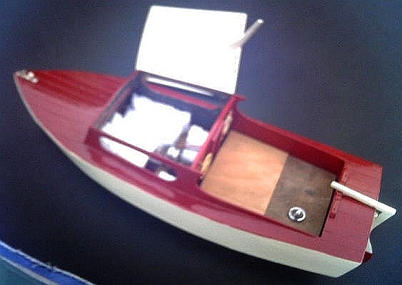

| My wee Sea Urchin, 58 years old. Restored to its original colours and format 2 years ago using correct off white and the "Heather Bell" Burgundy dark red made for us by Mark of Tramar Coatings who made all the paint for us when we restored the famous historic canal boat of that name, on which we lived for 5 years. Mark could actually MAKE paint for you if he liked the cut of your jib and I guess he must have liked ours as he'd often bring us fish and chips as we had no road transport when we were stuck in the boatyard.  I really must take some better ones, but it's up in the loft currently in it's carry case. That switch is original. The divided floor enable me to put in an Ever Ready flat bell battery Of course these days it has to be a 3 cell box with 3 AAs in. What we used to call U16 batteries. I can't recall what we called the flat bell batteries. They had thin brass contacts and there are fine slots in the floor cross member to take those, to keep the battery in place. Small croc clips connected the switch to the brass contacts and it all sat beneath the floor out of sight. I could get at least half an hour of fun from that set up. The motor is a tiny Kako. All that white on the photo is the addition of polystyrene for floatation. I have to get some glass cut for the windows as it originally had real glass glued inside the holes. It still has its original shaft and twisted tinplate prop. Free running, of course. Great exercise on a pond as big as Valentine's Park, Ilford. I have old 8mm cine of me as a proud 7 year old carrying the model back up the climb from Borth-y-gest beach to the car park! I'm now nearly 66! If the house caught fire, this would be saved right after the Mrs. and the dog.
Cheers, Martin | |

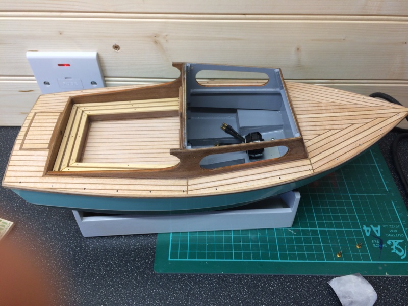

| Back to the urchin now workshops built... I’ve opted to stop epoxying the boats hull, I have it two more coats bringing it up to 5 coats on the light to 12 now on the dark green, I took some time to buff and light polish the rudder which only had 4 coats and the outcome was a nice high sheen which is a good overall finish for a boat this scale. I’ll leave the hull for a week to harden up and buff that in the same way, leaving only the wood work to finishes varnishing which will be a higher gloss finish. I also had a slight mishap with the roof when I went to polish the brass work and slipped with the buffing brush and leaving a polish burn in the paint.... roll eyes here.... Needless to say sanding and repainting the roof is the only fix it’s not a huge deal since fortunately it’s white, but it is an annoyance I could have done without. None the less this gives me opportunity to epoxy the roof over the laqure which burnt so easily where as the epoxy dosnt do that, since the rudder was machine buffed with no I’ll effects. I’ll crack the roof out this week while the hull hardens off and then start the deck work and roof finishes.   _________________ I'm Not Anti-Social, I'm Anti-Stupid.

| Roof issues fixed, I’ll give it some epoxy as I start doing the deck work, possibly tomorrow. A little annoying but the air brush makes the job much less of a ball ache. Well let’s hope I can get this build finished with few interruptions as possible now fingers crossed.  _________________ I'm Not Anti-Social, I'm Anti-Stupid.

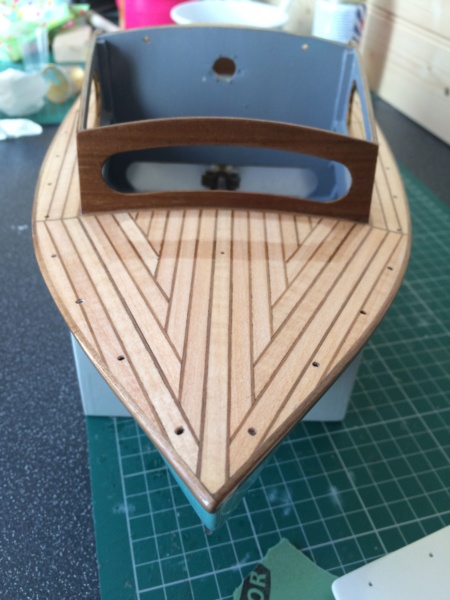

| Back to the Urchin for tha badly neededt push to finish. The roof has had a coat of epoxy, and will have subsequent coats as I progress with the boats deck and cabin. The boats deck and cabin have had a good run down to remove oversprays and any marks it’s picked up over the hull work ready for some epoxy, at present it’s drying out from its wet sand , but a little later today I’ll get it’s first official coat on. I’ll make an effort to mask up some of the hull to stop drips of epoxy catching the finished hull although limited as the rub rails have had over 15 coats so skipping over the edges wouldn’t be an issue once I get a singular coat on all over.   _________________ I'm Not Anti-Social, I'm Anti-Stupid.

| And that’s the first of 20 coats for the deck work! With this heat and hopefully no dirt build ups I should be able to do 3-4 coats a day it goes hard within an hour with the heat we’re having. Should I get any dirt buildup ( partials) I’ll have to stop and rub down the next day, this will be more promenant in the roof rather than the hull, but fortunately the roof will only need 4-6 coats similar to the hull to get a decent sheen. As you can see after the rub down and it’s first coat it’s already picking up a shine!  _________________ I'm Not Anti-Social, I'm Anti-Stupid.

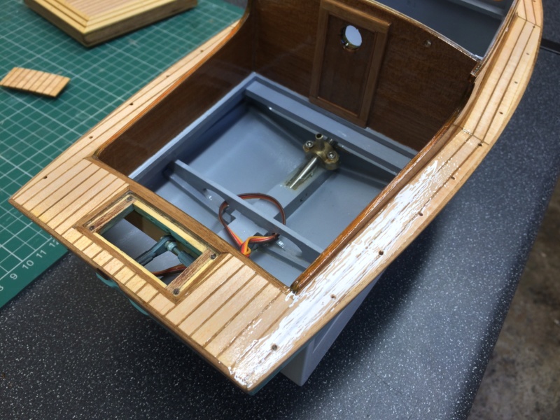

| I took some time to test the hardness of the hulls epoxy so gave it a light rubbing compound, T cut and polish with some bras-so results are good and the hulls started to pull up very nicely, I expect another week and another polish with some wax will bring up the hull perfectly. Back to varnishing now tho...   _________________ I'm Not Anti-Social, I'm Anti-Stupid.

| Got to 12 coats on the epoxy yesterday and decided enough is enough, i’ld rather buff this boat to a semi gloss than full glass also due to its scale going full gloss may detract from the models “scale appearance” Once polished up it will be similar to the hull a decent flat coat with a good shine on it. Couldn’t be happier with that and I’m not prepared to put an extra 3 weeks into the deck just to mirror it. So today I started fixing the light fittings, I hated the way the firsts set came out, their size (15mm) is far to tricky to solder cleanly tiny 1mm pins also the pins struggle to be handled once they have been heated and break easily. So I opted for a 2nd attempt which was my original thought but I decided against it as the support would have poked through the rear side wall, but with a tiny tweak to position this is what I’ve gone for... Took two of the hand rails and sanded one edge flat, and soldered to the base of the light fitting, the. Drilled a new hold into the hole which lines up with the hulls support frame. Given a light buff for now and bingo decent mount for the Nav lights and also left the hole under free if I decide to fit led’s later without effecting the hulls finish. I think by the photos you can agree with me the 2nd attempt looks much better First attempt....  i Finished 2nd set...   _________________ I'm Not Anti-Social, I'm Anti-Stupid.

| This evening I took the time to buff up the roof and reinstall the hand rails Finally the roof saga is over!  _________________ I'm Not Anti-Social, I'm Anti-Stupid.
