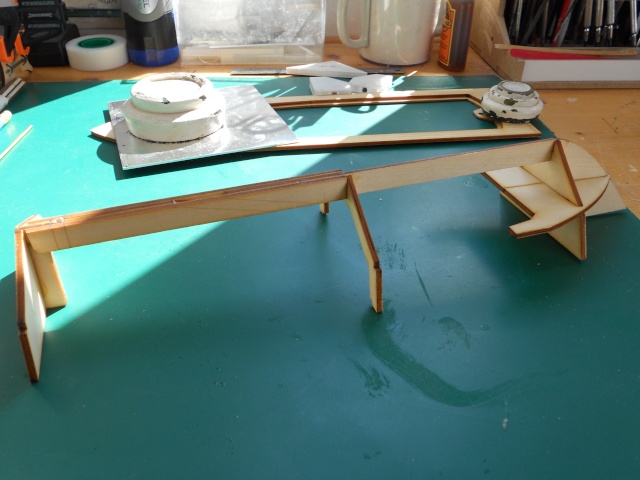

| I've made a start - without Crosby! I thought the keel assembly was a little tricky, so have done that so we can start on something more straightforward. Barrie  | |

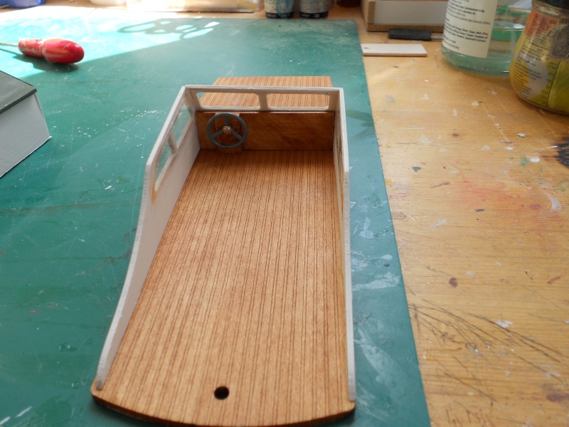

| We did sa little painting earlier in the week, but interest is waning and I was asked to finish it. Today I sprayed the hull with primer and painted it using Humbrol enamels. Colour chosen by Crosby! In fact he wanted the sides to be bright orange, but I vetoed that and have said it can have an orange stripe The cabin has been stuck to its floor, and the windows glazed. I made a console to take a steering wheel, and the front deck has been fitted. Just a little more painting and its ready for the power plant etc. Barrie  The photo of the hull was out of focus  | |

| Yes - its quite a good little kit. One or two things could be improved but for £15 inc postage from Hong Kong, good value. Today I've done some more painting - second coat on hull bottom and sides. He wants a red stripe, but I haven't got a suitable colour so will have to find a Humbrol stockist in the area. The deck needs another coat of stain, then its ready to fit the motor etc. Barrie  | |

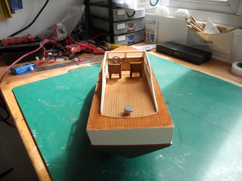

| Rather than buy red paint, I cut some 'go faster' stripes from vinyl and applied them. The hull has been covered in Humbrol Satin cote, and the decks have had another coat of varnish/stain. So the outside is ready for the customer's inspection.   I removed the rudder ready to re-fit the prop-shaft and propeller, only to find that the prop didn't fit  Fitting the bottom skins has reduced the clearance so a 30mm prop doesn't clear the hull I had deliberately left minimum clearance to get the motor as low as possible. So - I've had to order a 25mm prop. I have however fitted the motor, ESC and receiver, and created a platform for the battery - initially this will be 4 x AAA NiCds.  Next job is to try and float it. This will probably require some ballast, and possibly moving the battery forward. I shall leave this for Crosby to help with on Wednesday. Barrie | |
