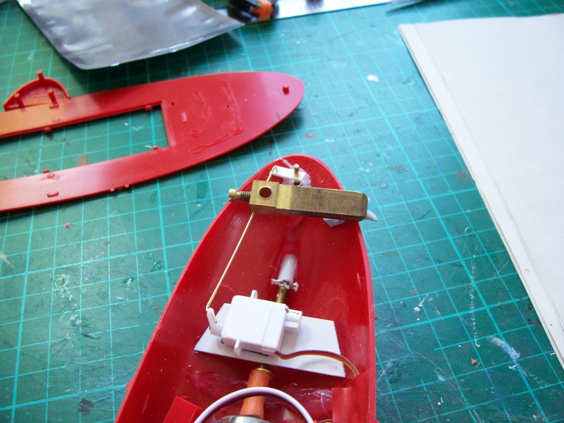

| No progress today but I realised that if I can find a way of extending the rudder shaft, then I can go higher giving me more room for the tiller.
Posts : 2616 Join date : 2011-11-26 Age : 83 Location : Thaxted, Essex
 | Subject: Re: Plastic Magic again! Wed Jun 03, 2015 6:01 pm | |
| I had to abandon the original plan. I have removed the moulded in rudder shaft and replaced it with a piece of brass rod. This has enabled me to raise the tiller and allow more travel. I also fixed a platform for the servo, next job is to change the connector on the servo, mount it and make a linkage. Barrie  | |

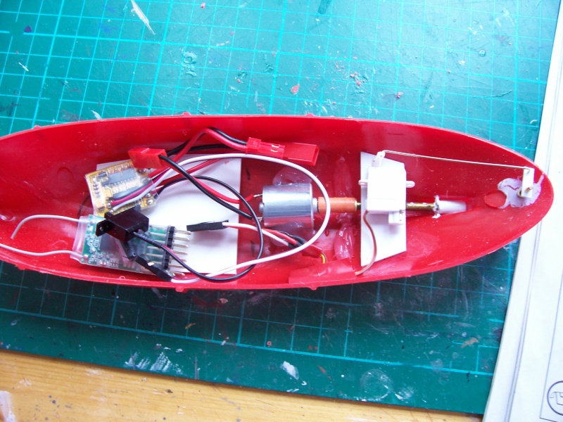

 | Subject: Re: Plastic Magic again! Fri Jun 05, 2015 6:30 pm | |
| The servo connector has been changed to a standard Futaba type, and the servo stuck down with double sided tape. The linkage is made. Using the brass rudder post has given me the problem I was trying to avoid by using the moulded plastic one - getting the tiller to stick to the post. Super glue didn't seem to be holding.  I may need to make a brass tiller so I can solder them together. As you can see, there is just room for all the bits, the battery will sit on top of the receiver and ESC right into the bows. Next job is fitting the deck - when I tried it today, it seemed to be too big, which I guess means the hull has distorted. Barrie  | |

 | Subject: Re: Plastic Magic again! Fri Jun 05, 2015 8:46 pm | |
| Can you get the tiller arm down to rest on top of the shaft. Then cut the surplus from above the arm. Also, to save height problems, you could connect the linkage below the tiller arm.
Just a few thoughts.
Cheers ken | |
 | Subject: Re: Plastic Magic again! Sat Jun 06, 2015 7:01 am | |
| - Tug--Kenny wrote:
- Can you get the tiller arm down to rest on top of the shaft. Then cut the surplus from above the arm. Also, to save height problems, you could connect the linkage below the tiller arm.
Cheers ken Ken, The surplus isn't really a problem as there will be no deck above it - the rope deck sits clear of the deck by about 5mm. If I lower the arm, I get less throw. My problem is getting the arm fixed to the shaft. Barrie | |

 | Subject: Re: Plastic Magic again! Sat Jun 06, 2015 11:02 am | |
| If you use the brass pin from a 13 amp plug, there will be a screw in the end. This can be tightened onto a small flat on the shaft.  cheers ken | |
 | Subject: Re: Plastic Magic again! Sat Jun 06, 2015 4:27 pm | |
| - Tug--Kenny wrote:
- If you use the brass pin from a 13 amp plug, there will be a screw in the end. This can be tightened onto a small flat on the shaft.
cheers
ken Hi Ken - its a good idea - I use it on larger models, however in this case there is a small issue of size  As it happens, the super glue seems to have worked. Barrie | |
