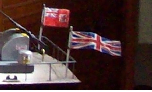

Hello all i don't if this has been posted before but here goes. It's the way i make my flags which is cheap, and easy, and saves you paying the extortionate prices for cloth flags that unravel.
Browse the internet for the flags you want, download it/them, and resize them. Print them of on Normal paper, cut them out, and use clear varnish on one side, allow to dry then varnish the other side. This gives you a natural furl for the flags when you stick them with wood glue. Now the varnish gives the flag a bit of strength when you attach thread or whatever you want to string them with.

Excellent idea Tony BUT when you do copy your flags make sure you put the right flag on your boat as you never
get a union flag on the stern of a boat - only on the bow and then only when tied up alongside or at anchor.
Geoff
PS for 10 years I was a signalman in the RN, a very small part of my job was flags!!

I stand corrected Geoff, but i'm sure i remember reading somewhere that an elongated Union flag goes on the stern of the Boat. I may be wrong. Anyway i will take it off, can you suggest a Flag?.

PostSubject: Re: Flags   Flags EmptyThu Jul 19, 2012 7:48 pm
Tony there used to be an elongated union flag but with a white border that was used by visiting foreign merchant ships
to indicate they required a pilot - I don't think is has been used since the Act changed in 1970.
If I had a model of a british pilot boat I would have it flying either a trinity house pilot flag or a red ensign on the stern
and if it was actually carrying a pilot onboard flag hotel (red and white) usually on a small mast on the cabin roof.
Geoff
