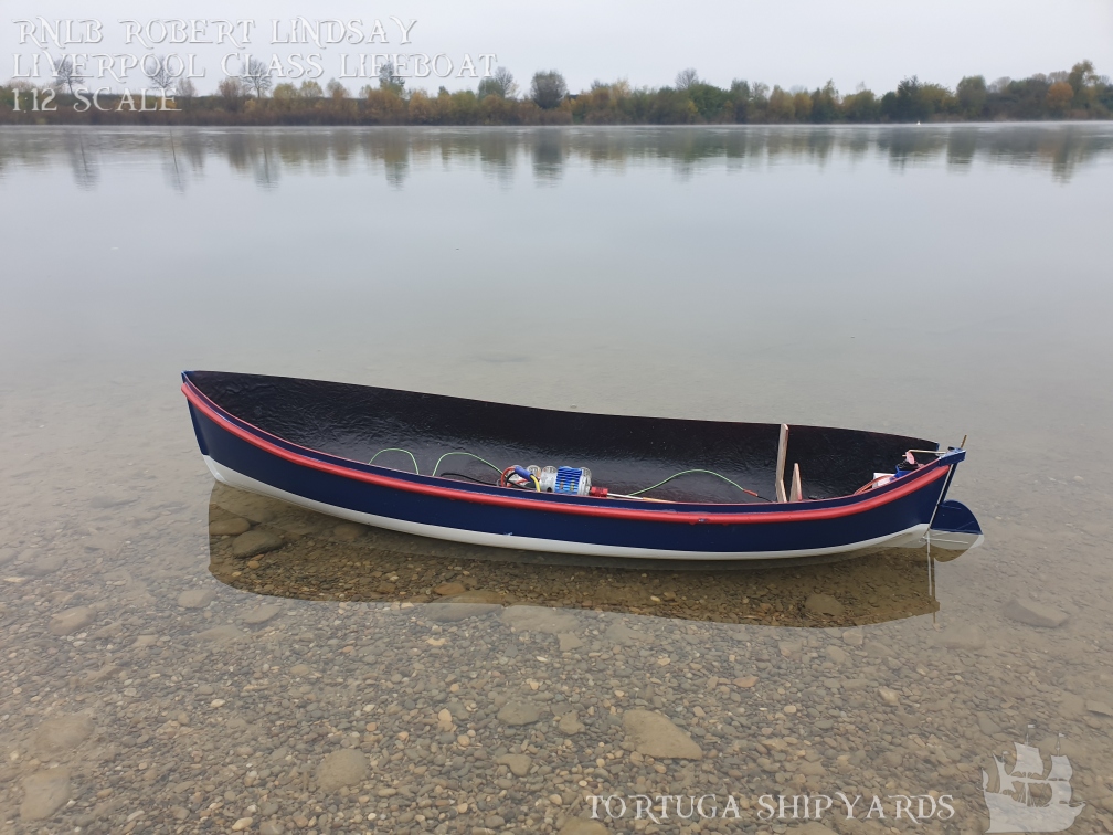

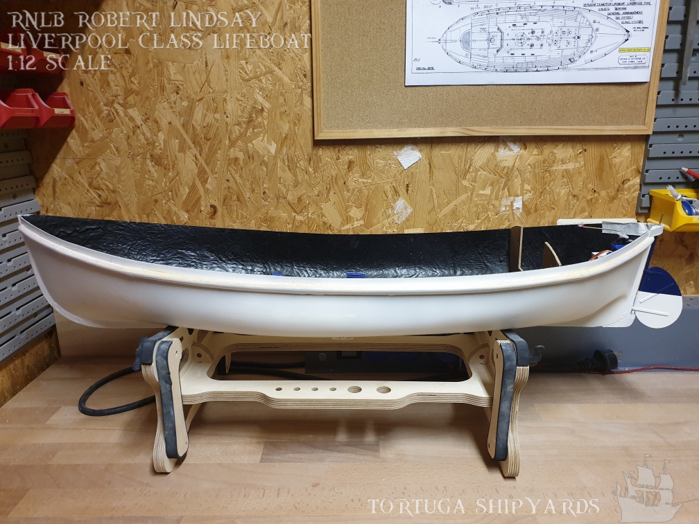

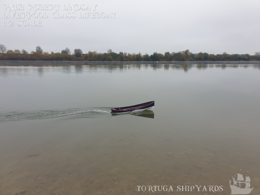

| With my model of the Mary Stantord almost finished I made a start on my next project - the Robert Lindsay from Arbroath. The hull is from orion mouldings and the bumprails have been added - they are made of balsa and a bit simplified, but I'm fine with that.  As my first model of a liverpool lifeboat was a quite slow I decided to use stronger motors and brass props ( 35 mm diameter and 30 mm pitch). After adding the first coats of paint I could head of to the lake for the first sea trials.  The powerful motors and brass props pay of - the boat achieves a decent speed  Cheers, Max | |

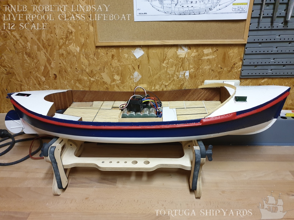

| The deck has been planked with abachi and the insides of the bulwarks with mahogany. Next step ist to add styrene strips to the deck and to build the flotation boxes  Time for another round on the lake. Perhaps I should have added scuppers, after 20 minutes of sailing there was quite a bit of water on deck.  cheers, Max | |
