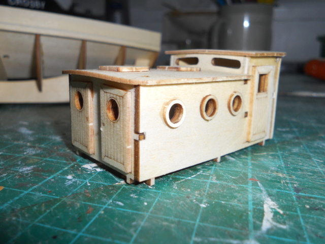

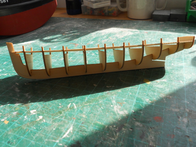

| David - its Chinese  . The laser cutting is excellent. In fact I made a mistake above. The planking and the thinner wood is solid wood not ply. Only the hull components and the cabin structure are ply.  One side of the bulwarks has been fitted together with the first plank. Planking is going to be tricky as its difficult to use clamps and pins. The structure is also quite fragile so care is needed. I bent the first plank using heat from my soldering iron and super glue to stick it. I will be trying aliphatic for the next plank - less risky when using all fingers and thumbs to hold the plank I finished the cabin as well. You can see the construction method using tabs for correct alignment.  Barrie | |

| hi barrie, as regards the planking barrie, have you ever tried using string. I make a slip knot then fix around the end of hull as can be seen in photos then just keep wrapping it round, its some thing I have used a lot as it holds the planks tight in place some times a pin here and there helps it not to slip. then when glue is dry you undo and no damage is done. (if you want to remove this barrie I will not be offended) thought it might help others.   I fined it better than clamps more often than not. the tighter you can do it the better. david | |
Posts : 2580 Join date : 2011-11-26 Age : 82 Location : Thaxted, Essex
 | Subject: Re: Chinese Fishing Boat Sun Mar 03, 2019 12:08 pm | |
| Thanks - I will try that David. The first one was OK as I could hold it and run the glue from behind, but that will get more difficult.

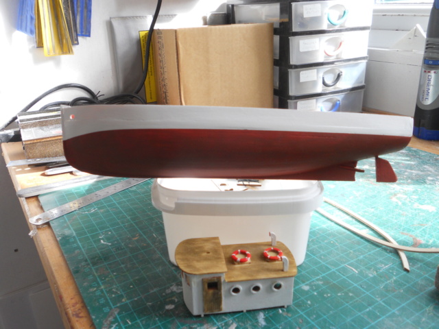

|  I've started painting the hull. Top part has had two coats of satin white. I also made the mast and painted it. The ventilators have been painted white and the life rings also. They need red adding when the white dries. I haven't fitted the bulwark cappings as I think I am going to stain them so will wait until the hull is painted. Barrie | |
 | Subject: Re: Chinese Fishing Boat Wed Mar 13, 2019 8:44 pm | |
 | Subject: Re: Chinese Fishing Boat Thu Mar 14, 2019 5:36 pm | |
| The hull bottom has been painted - hope its covered OK as I don't have much of that colour left  The ventilators and life rings are painted ready for fitting tomorrow. I think I should be able to complete this tomorrow. Barrie  | |
