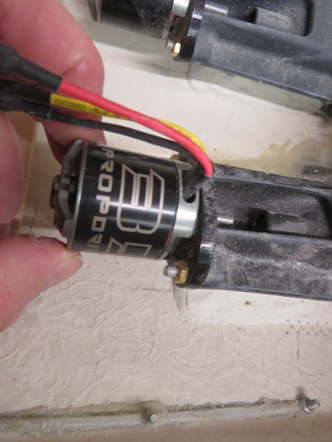

| Right guys...……...I don't need reams and reams of choices...…...I won't understand as i'm an electraphobe……….but the speedline 1;12 Shannon comes with these motors......outrunners I believe as the can on the outside rotates...…    simple answers to simple questions please; 1] what one way [no reverse] ESC should I buy. 2] what batteries should I buy, 2s,3s 4s...……..[god knows what they mean], and do I have one pack per motor,.... and do I need different chargers to my normal nihms and sealed cell batteries that I use with brushed motors. 3] what is the cycle for these lipo batteries...……….do you run them to flat, or can you charge them after each run. 4] do I run the receiver off a separate 4 cell battery pack as normal without bec.5 ] and finally is there any fire risk to leaving these batteries on charge unattended.please, very simple answers, and no arguments...….these questions were asked by someone on mayhem, and god knows how many different answers there were...…...and I was totally baffled by all the different answers and arguments, making it extremely difficult for thick sods like me.simple explanations please as I truly DO NOT understand electrics or electronics...……….I can understand how an automatic gear box on a motor works...……..but I am useless with this sort of stuff.thank you in anticipation for clear basic shopping list. |

| First up yes those are outrunners you have, and a very similar spec to the ones i usually recommend to people (they are also my go to brand for a decent motor that do not fail! (overland thumpers)
depending on the brushless Draw rates it could be as little as 20amp up to 400amp!
however after a quick google of your motor this is the spec that turned up...
Model: NTM Prop Drive Series 35-42A 1250Kv Kv: 1250rpm/v Turns: 6 Max current: 56 Max Power: 500W @ 12v (3S) / 600W @ 15v (4S) Shaft: 4mm Weight: 148g ESC: 60A Cell count: 3s~4s Lipoly Bolt holes: 18.9mm & 25mm Bolt thread: M3 Suggested Prop: Prop test data coming soon!
