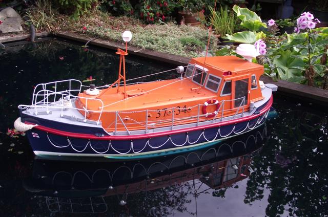

| hi samc, welcome to this site. is this what you are looking for, I only posted this picture 2 days ago on a question about speed controllers on here. the set up is 2 x 380 re 3v x 7.2 v motors 2 x 3000 mha batterys and what is called a dual esc separate wires two the speed controller. you will need a left and right propeller as one will rotate in the opposite direction to the other you may need to swap wires on motor round for left side motor. hope I have said this wright but just ask if you are not sure still. also you can run two motors on a single esc if cost is a problem but you must have left and right props.   this is the boat that has this set up in and I get a good scale speed, and not a speedboat as some people think they should be. david | |
