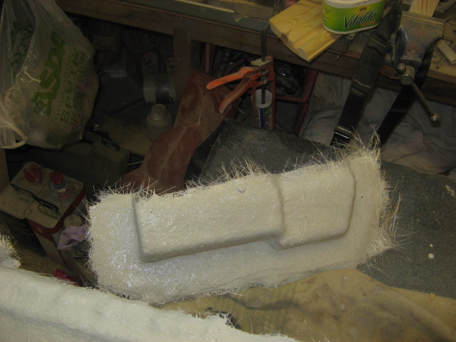

Now has come the point where I have to get down to the messy job.
I have produced a second hull that has been waxed up with a release agent so that my friend could make a grp mould from it for production of hulls in GRP. I gave it to him, thinking that he would be able to do it himself, as at the time I was too busy with other projects to clear my workshop in order to do the job myself( something that I have done many times)
However I misunderstood and he was actually going to get someone to mould for him. Sadly those that he approached wanted to rip him off and the lowest quote he got for making the two simple moulds was £1200 pounds......totally rediculous, so I have been given them back and I will over the next few days make a production mould from the "plug" and then make a moulding for my daughter so that we can work on it together.
So firstly I had to make a flanmge to go down the centre of the hull and the superstructure. The first half of the mould will be laid up against this flange. It is held by a back bone of a strip of wood, and the flange is screwed onto it.
the flange is then set into possition by a gooey gluey substance called Bluetack( for our US friends who I am posting for as well as RCMB forum mates)
Once I have set the flange down the centre it is held by moulders plastecine.
Don't be bothered too much of the gaps between the flange and the hull.......this is filled with more plastecine for a nice even and flat surface between the plug and the flange.
Once the flange has been fitted, the hull/superstructure and flange are all given more coats of release agent wax. DO NOT use ordinary furniture polish to do this waxing job.....it will contain silicons.....and these will react with the first layer of gelcoat and leave a rippled orange peel effect. The wax that we use for mould releasing is a NON SILICON BASED wax, that actually comes from the USA

As i know nothing about making moulds I am finding this very very interesting Neil, looking forward to your next post.

It'll be all go from Friday, alan......i'm going to southport for the day with the good lady and our kids so am picking up my resin, gellcoat and matting from glasplies whilst I'm there....will do a bit on Friday night.

Now that I have got hold of my supplies of polyester resin and gelcoat, it's down to business making the moulds for the boat and cabin.
First job was to paint all the surface of the first half the mould to be moulded, with PVA release agent..this is not to be confused with PVA glue..this stuff is meant to release parts by forming a film between layers, not to stick them together.It is blue in colour and leaves a thin film on all surfaces to be gelcoated.
AMBULANCE LAUNCH FLYING CHRISTINE. - Page 2 Releas10
Once this has dried, the whole area is coated with the first layer.....the waterproof Gelcoat layer.....
Although this is not actually the boat, a gelcoat layer is always appled to my moulds to give a hard glass like finished outer layer.
AMBULANCE LAUNCH FLYING CHRISTINE. - Page 2 Releas11
AMBULANCE LAUNCH FLYING CHRISTINE. - Page 2 Releas12
the odd looking shaped hump is the rear cabin for a lifeboat I will be building when this project it finished so thought I'd mould it at the same time.
AMBULANCE LAUNCH FLYING CHRISTINE. - Page 2 Releas13
whilst the gelcoat is "going off" I spend my time cutting 450 gram chopped strand matting into smaller manageable pieces for ease of laying up. some strips, others in small squares and some in larger pieces.
However to give greater impregnation of the resin I tend to split the matting into thinner layers, giving a more open weave to the matting.
I still use the same equivelant number of layers, just better bonding power.
Tomorrow it's down to laying up the first half of the mould with matting and resin.
AMBULANCE LAUNCH FLYING CHRISTINE. - Page 2 Releas14

this morning I laid the first layer.......the hull giving the most concern, because the thin belting and spray rail on the lower hull kept forming bubbles around the raised objects...a lot of stippling and rolling was needed with the first layer...second layer went on well after the first had gone off. the other moulds went well.
the first shots though are the tools of the trade, with weigh scales for calculating catylist to resin, the measuring jug and the resin + white pigment.
AMBULANCE LAUNCH FLYING CHRISTINE. - Page 2 First_10
AMBULANCE LAUNCH FLYING CHRISTINE. - Page 2 First_11
the first layers of matt and resin applied to the plug. this will be ready for splitting from the flange later tonight.
AMBULANCE LAUNCH FLYING CHRISTINE. - Page 2 First_12
AMBULANCE LAUNCH FLYING CHRISTINE. - Page 2 First_13

I cleaned up the mould edges on the first halves of the mould, and have now had a look at it.......there were one or two bubbles formed between the gelcoat and the first layer of mat, at the flange edge.
Before starting the second half of the mould I poured some neat gelcoat into these bubbles, and alowed to set, before waxing up the second half of the mould once the flanges have been removed.
A quick wax up, and a PVA release layer, and back to the gelcoat for the second half, and then laying up with matting.
filling any air bubbles at the edge of the moulding
AMBULANCE LAUNCH FLYING CHRISTINE. - Page 2 Faults10
AMBULANCE LAUNCH FLYING CHRISTINE. - Page 2 Faults11
Flanges removed, edges of first half of mould cleaned up, and waxed up and a release agent added ready for second half of mould
AMBULANCE LAUNCH FLYING CHRISTINE. - Page 2 Second10
AMBULANCE LAUNCH FLYING CHRISTINE. - Page 2 Second11
AMBULANCE LAUNCH FLYING CHRISTINE. - Page 2 Second12
