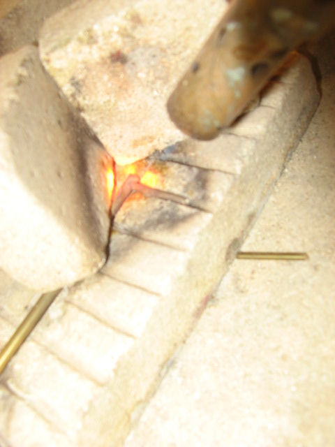

hi peter...it's not really. you just but up the pieces of brick to make the hearth. I have some large pieces which I can prop one up with at right angles to the other, and some smaller brickette pieces which I put around small pieces that I am soldering to catch the heat from passing through. if I need the long back board piece I prop it up with some old batteries..the stuff is so good that even direct heat on one side to white hot, will not transfer through to the other side making it easy to prop the stuff up with weigthy items.
the two brickettes of it in the 1st pic below are about 50mm square.
AMBULANCE LAUNCH FLYING CHRISTINE. - Page 4 00112
AMBULANCE LAUNCH FLYING CHRISTINE. - Page 4 00312
Being able to place the bricks anywhere makes for easier arrangement of the "portable hearth" for soldering larger items together.

I wouldn't glue them together dave.....
if you leave them free standing it gives you any amount of options for soldering, and then they store flat in a box till next time you want to solder away.

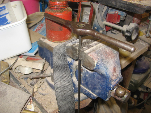

also shown is my tapping M4 threads on some stainless for the prop shafts.....exposed end to the outside of the boat of course, lol

Enjoyed the lesson in silver soldering Neil, will have to get myself some of them there fire bricks.
Get some soft jaws in that vice before you ruin that prop shaft Smile
By the way, theres a fellow on Mayhem wants some help on prop shafts and such lol! but not from you lol! lol! lol!
