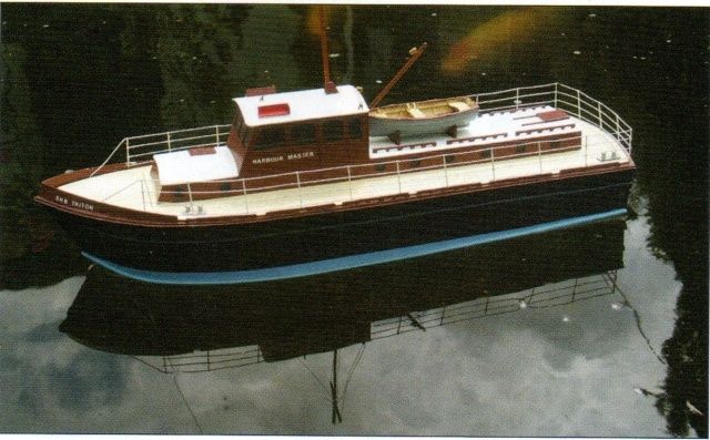

For my next project I am going to build Richard Webb's model of Triton. I had the plans and David kindly scanned the pages from the original magazine article. This should be a fairly simple build all in plasticard.
I have cut out the main pieces from 1 mm plasticard, now the most tricky part of the build, fitting them together - there are no bulkheads in this, the pieces are just glued to each other. This does make a strong hull, but does require quite a bit of fiddling to get it right.
Power will be a 385 motor and an Mtroniks esc, or possibly one of the 10 amp Chinese jobs.
Southampton Harbour Board Triton Dscn0012 Southampton Harbour Board Triton Triton10
