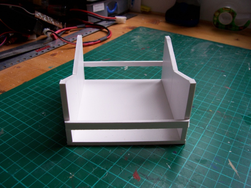

The PVC pipe cement finally arrived. I thought I would be able to buy it at B&Q, but no so had to order online Sad
I have now stuck the frames the the deck, and am ready to attach the cabin floor.

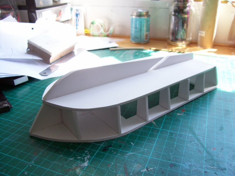

The cabin floor has been fixed to the formers the transom made and installed, and the keel cut from 5mm Foamex and glued in place. Next job is to make and install the knees, then ready for the skins. I am going to have to use Epoxy glue for those as polystyrene glue doesn't work on PVC, and PVC glue doesn't work on HIPS  Sad
