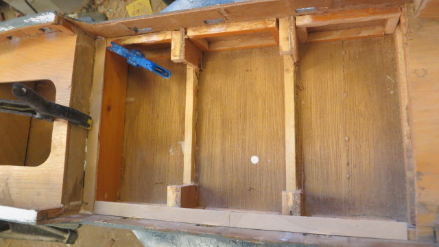

Today I spent time ripping up the car deck as on looking hard at it, it was twisted upwards at the aft end. I have put some inserts in to raise a new deck at that corner and will lay a new deck shortly.
However, the main alteration is at the aft end......the Eigg has a flat transom whereas the little hull I picked up had a rounded one.......so am gluing in some fillets and making a new stern glued onto the old one.....should take some of tomorrow before I can start sanding it down.
I then have the problem of the wrong shaped bulwarks, but this shouldn't be too much of a problem once the stern has been sorted out.

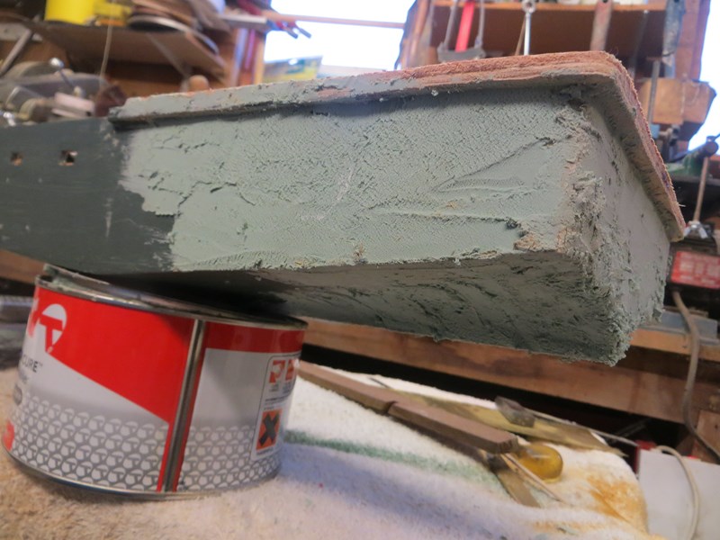

only a tiny bit done recently but have now fitted the false bottom onto the boat. this will allow me to position the twin prop shafts under the counter more easily. it was made from a piece of 15mm ply and has been faired in at the stern, but have now run out of filler so will do the rest, later, and then sanded down. I have no idea as to what paint was used to give it it's Olive Drab green look, but presuming it was brushed enamels I will then sand down to bare wood before sanding sealer and spray paints are used.......it's coming on, and circumstances change next week and so I'll then have a greater time to give it's bigger counterpart, the Jupiter much more time..........yippee.

Well, back to the build.......have finally got over Christmas and a new year and back to a little model making.........Firstly the Eigg has been filled at the bow to fair in the block of wood making the false bottom.
this will need to be sanded down to make a good finish.
