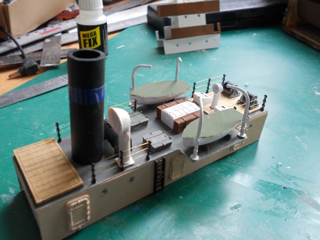

 | Subject: Re: SS Redshanks Wed Jun 29, 2016 1:01 pm | |
| All the railings are now complete - and have been painted since I took this photo.  I have also glazed the bridge so I should be able to fix the roof next session. I have been thinking about the mast and boom - particularly about a way of making it possible to move the boom out of the way to allow access to the hold for the battery etc. I think I might experiment with magnets. I have a selection of small high powered ones which I think I could insert into bit of plastic tube. Barrie | |

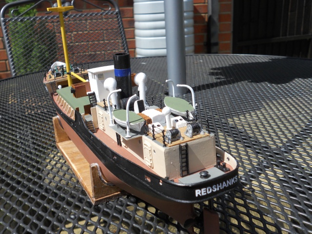

 | Subject: Re: SS Redshanks Tue Aug 02, 2016 12:58 pm | |
| I have finally found time to complete Redshanks. All that was left was the rigging for the mast and boom, and the lettering for the bows. I successfully cut some 3mm high letters just before I went on holiday, and these have now been applied. This is the first time I have managed to cut letters so small, and they look good. I think I have now reached the lower limit for my cutter - anything smaller and it would be impossible to weed the letters(remove bits like the centre of an O). I have kept the rigging simple as at this scale its very fiddly. I did find some small blocks which are better than those supplied in the kit. I still have to ballast the model, and I want to change the Rx if there is room. It currently has a very small DSM2 receiver, but I really need to limit the throw on the steering servo, so if I can fit it in, I will use a Flysky receiver as that Tx allows me to set end points. Just waiting for it to come from somewhere in Asia I've still got lots of painting to do in the house so it will be a while before I start a new project. At the moment I don't really know what I want to build. Barrie  | |

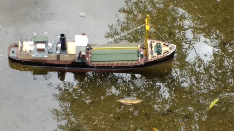

 | Subject: Re: SS Redshanks Tue Aug 16, 2016 7:41 pm | |
| Finally got Redshanks ballasted (quite tricky finding space) and balanced. Took it to the lake last Sunday and she sails quite well. I used the end point adjustment on my Tx to avoid her planing and she looks good on the water. A rather poor photo - I still haven't mastered taking photos and sailing the boat. Barrie  | |
