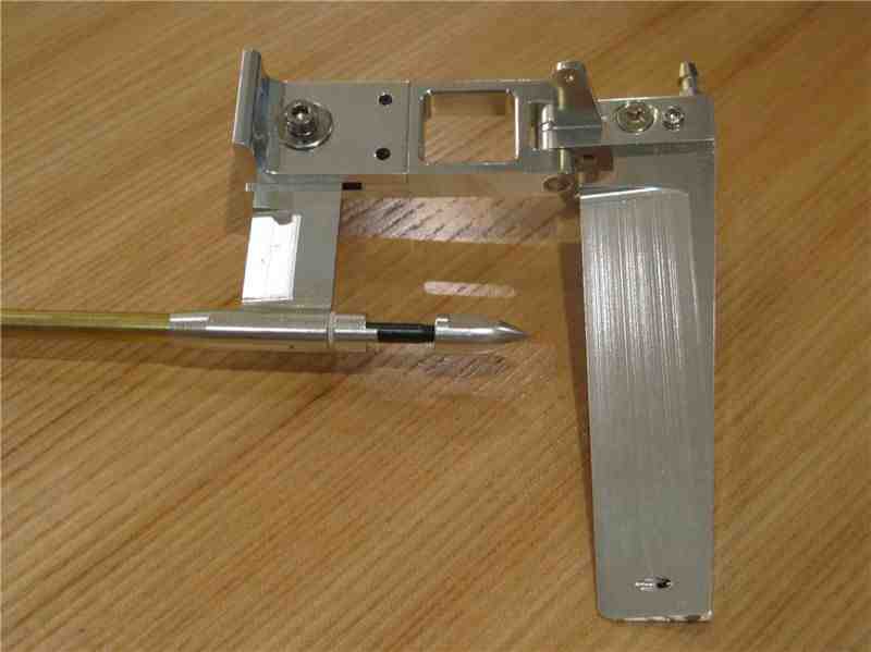

350mm Strut unit with 4mm flexi with adaptor sleeve to take either 4mm props or 3/16. One short, 42mm from transom, 78mm long rudder, Alui 52mm turn fin's, small 25mm trim tabs, running the 2860/4050 380 can size motor rated for 85 amps with a 100 amp esc to boot, prop going with a 35X carbon prop to start with, working up to the X435, running off a 2s 5000mha lipo but i can boot up the rpm to a 3s 4600 later if needs be, the prop will give me some indication as to what's going on.
