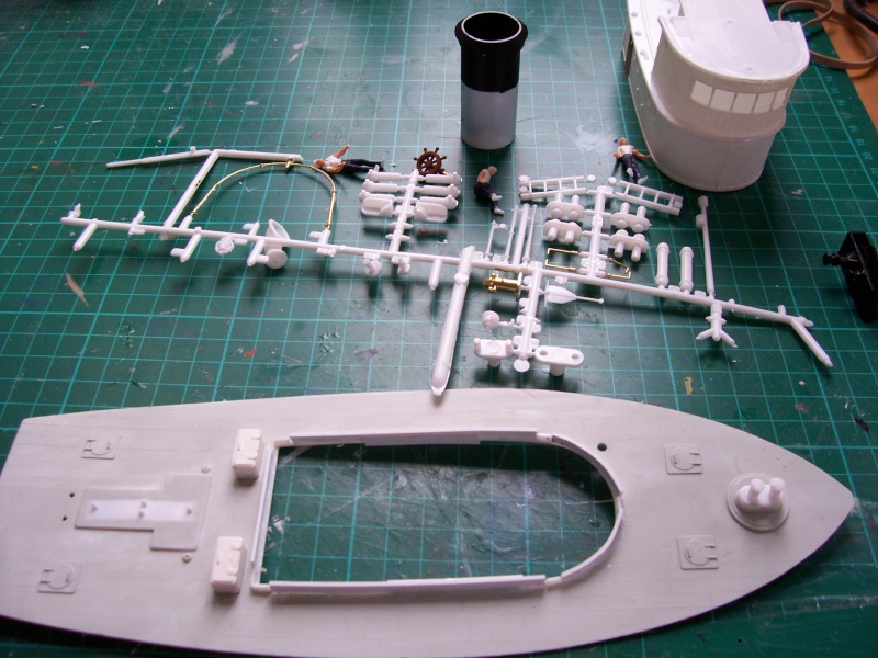

Here are the contents of the box - all shiny white plastic Laughing  One or two pieces seem to have suffered a little warping with storage, but nothing too serious I hope.
Lindberg US Coastguard Tug 100_0710
I have encountered my first challenge with this build. The deck has to be fitted BEFORE the hull is stuck together Crying or Very sad  This is going to make it quite difficult to fit the motor etc. Because of this, no progress today. I am now waiting for my prop shaft etc to arrive. I plan to use a motor from a servo and an Action Pico ESC.
There is a reasonable access hole under the superstructure, so if I can fit the prop shaft and rudder tube to one half of the hull, and work out a mounting for the motor, it may still be possible. If not, I'll have a nice static model. lol! lol! I believe that at one time Lindberg did market some of these kits with motors, so I am hoping its still possible.

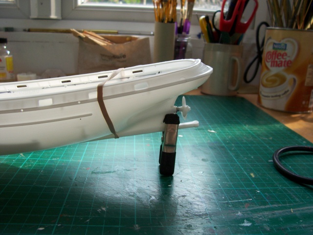

PostSubject: Re: Lindberg US Coastguard Tug   Lindberg US Coastguard Tug EmptyTue Mar 17, 2015 3:17 pm
The prop shaft arrived yesterday so today I had a go. After opening up the hole meant for the supplied rod, it fits nicely. There was what looks like a support for the shaft included, so I have fixed that to one half of the hull and enlarged the hole at the top to take my shaft. I have also glued to one side a shelf placed to take the motor, which will be fixed with silicone.
I will be using the supplied prop, as I don't have anything small enough. Its a good shape, and I was able to open out the hole to take the M2 thread.
I have also drilled out the hole for the rudder. I am making a new rudder as I couldn't see how to fit a proper shaft to the one supplied.
I think I am now in a position to stick the hull together. There should be enough access to fix the remaining items.

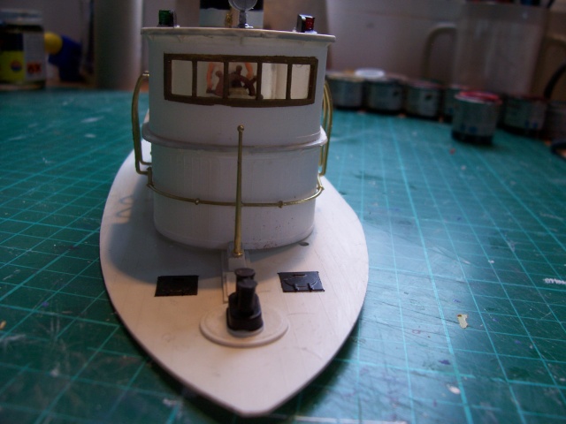

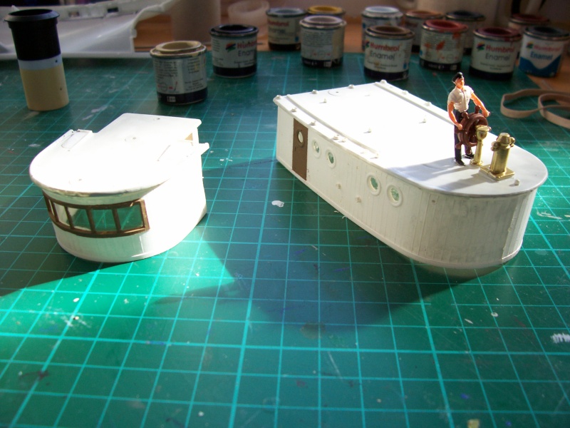

More painting today and a little bit of construction Wink
Lindberg US Coastguard Tug 100_0719
The porthole surrounds are supposed to be painted brass, but there is no way I can achieve a respectable finish on something that size and shape so they will stay white Shocked  Tomorrow I think I can make good progress putting it together, many bits are just waiting for the paint to harden.
That will leave the hull for which I need to get some paint, and of course the servo so I can make it work Cool

Lindberg US Coastguard Tug 100_0720 Lindberg US Coastguard Tug 100_0722
The superstructure and deck are now almost complete - just a couple of items to add. If I make another of these type of models, I will discard the railings etc and replace with proper brass rod. These look very poor, but the objective is to see how ell it works as a R/C model.
This is how it will now stay for at least 2 weeks until I return from holiday. Then I need to source some paint, Decal Fix and a servo to be able to finish it Smile .

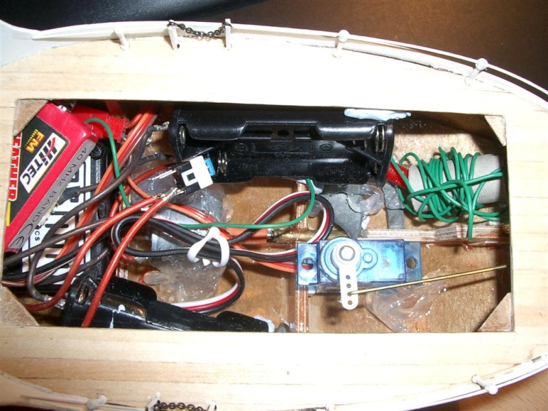

Final thought before I go. This is the internals of my smallest boat yet - only 7.5 inches long. That's a 40Mhz 4 channel receiver, the Action ESC in its case and the battery holders are both 2 x AA.
So its surprising what you can get into a small space Thumbup

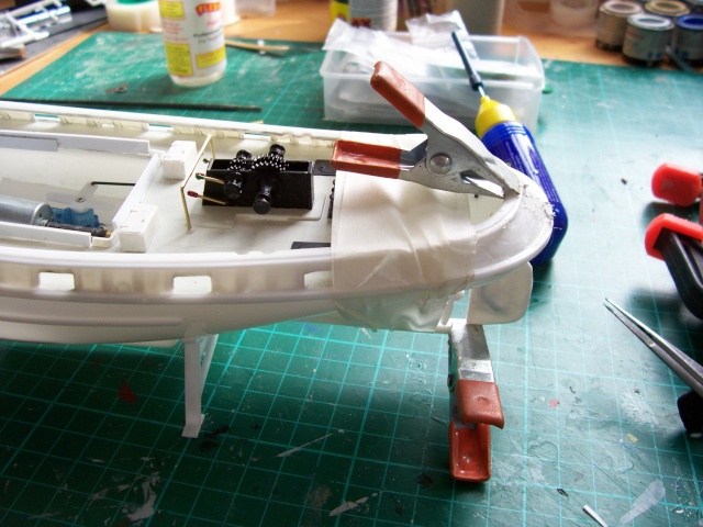

Well, back from hols and before I go into hospital, I am trying to finish the tug. I fitted the servo and made a linkage for it which was the only thing stopping me putting the hull together. As I expected this was a bit tricky keeping the two halves and the deck in the correct place. I ended up sticking it in stages as it was impossible to clamp it all.
I still have problems with the stern which I think is down to a warped moulding. I am hoping the tape will hold it together until it sets, if not then I will fill it. Rolling Eyes
If the paint comes tomorrow then I can get some colour on the hull - it looks a little strange in white Very Happy
I also need to see if its watertight - I hope so as there isn't much room to get inside to seal it.

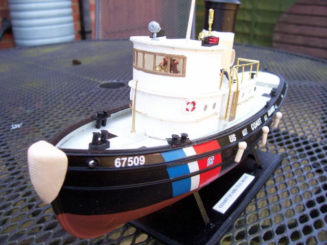

Thanks Damien - I put the final touches on today. A coat of Satin Cote, then applied the decals and another coat over them. I think I have solved the fixing of the rope deck at the stern. I have tacked it in place with Copydex, so I should be able to remove it if I need access to the tiller. Laughing
I have also had another idea for battery and ESC. Shocked I have a couple of very small 2S LiPos, and have just bought a Chinese forward and reverse ESC rated at 10A (Chinese ones obviously) with a BEC, which is only about 25 mm square. It only cost me £4, so its worth a try.This will be first option when the ESC arrives, hopefully when I am mobile again after the knee op.

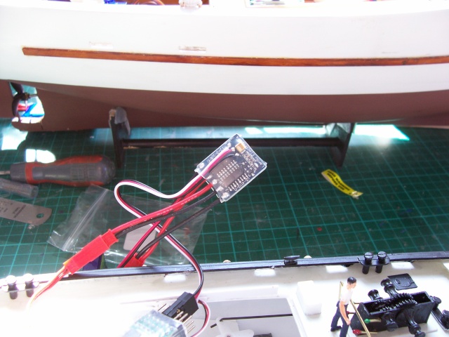

I had a very pleasant surprise this morning when the postman delivered my ESC - only 7 days after I ordered it from China 2thumbsup 2thumbsup
Its is little bigger than one of the UK Large Letter postage stamps, so was easy to fit into the tug. Tested and it works well. The only downside (which I knew about) is that it has a brake function. This means that you have to hit reverse twice. I also think that reverse is less than 100% of forward max speed - again I knew about this and in this model its not an issue.
Here is the unit
Lindberg US Coastguard Tug 100_0734
...and installed in the tug. Can't wait until Sunday to try it out. bounce bounce
Lindberg US Coastguard Tug 100_0735

The maiden voyage went reasonably well, although one member thought it was air powered there were so many bubbles coming off the prop Rolling Eyes  More weight required in the stern. Thumbup Also 7.4 volts is a bit too much, so I have to remember to go easy on the throttle.
I've adjusted the ballasting and will try again next week. I will also try to get some photos and video on the water if my daughter and grandson come with me.
