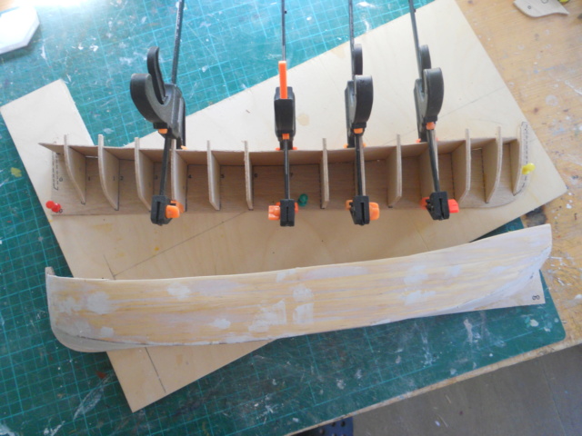

| Fingers now clear  Side 1 sanded, filled, sanded and filled again waiting for final sand. Side 2 almost ready for planking. I used CA glue this time which speeded up fitting the frames,the deck is glued with Aliphatic. I am pretty sure there will not be the same gap as side 1, as I removed the assembly from the building board to check for fit  . Of course, this may have introduced a twist Barrie | |

| Not much done over the weekend as it was too hot, and I ran out of CA glue  New supplies arrived today, and it was a little cooler in the workshop an hour ago, so I got the planking started. I need to wait now for the bottom piece to set hard - I used aliphatic for this - rather than CA. I think this side is going a little better than the first, still having problems with the strips though. They are very brittle even after soaking in hot water, and it is very tough getting the pins through. I didn't leave any pins inside this time Barrie  | |

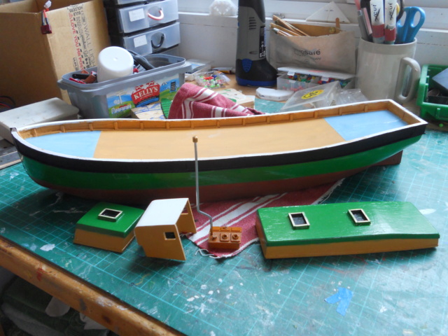

| The workshop was reasonably cool this morning, so I managed to do some painting. Firstly I painted the insides of the bulwarks and the middle section of the deck  Then I marked the water line and painted the bottom.  Finally I tried the cabin roofs, after painting the lower part of the sides. I gave the tin of paint an almighty shaking, which seems to have improved it, and the coverage of the green is now much better.  This is a boat that needs painting as you go along as there is so much detail to be added it will be impossible later. Barrie | |

| More painting! Not sure about this green  Finished (?) the skylight.  More paint required then start with he fittings. Barrie | |

 | Subject: Re: Will Everard Sat Aug 04, 2018 1:53 pm | |
| If the green is too much in colour you could always dull it down by giving it a black or brown paint wash, then rub most of the paint off which should leave the paint duller and fill some of the grains with giving a nice contrast. _________________ I'm Not Anti-Social, I'm Anti-Stupid.

| I think it will be OK when its had another coat then some satin varnish - I think my customer likes it anyway Barrie | |
