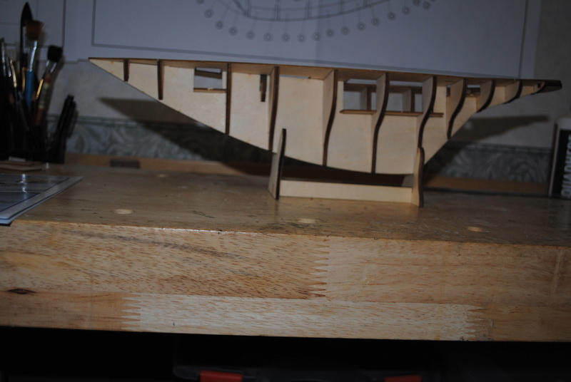

| Hi All, Been looking through this site, really good and given me some "Inspiration" for Marina II, don't know when I'll get on to this, but, I'd love to actually get something "Operational" if you know what I mean. I still have my A/L Sanson to complete. (My Modus Operandi is to complete one thing at a time, otherwise I loose my focus....) I'll share this with you all soon enough, I have embellished Sanson with "Hi Intensity LED's. Anyway, this is not about Sanson but my "Fun" with Pen Duick. It started out really well but I got into issues when I spayed the wrong Lacquer onto by completed Hull. The paint under the lacquer "Crazed," sanded back, re-spayed, (No Lacquer), same thing.... Not wishing to throw it all away, I removed every scrap of paint and Lacquer!! Re-sprayed the Hull and a little more success, no lacquer this time.... Kit Sails were wanting also, they were beautifully "Pre-Sewn" but the Main Sail was not long enough by about 20.mm for Gaff and Boom, height was good. Jib, Flying Jib and Foresail also need some modification/re-stitching. Photos of the build:          |

| So, There you go, something that I had hoped for a two to three month build turned into a six month build, never mind. My first attempt at Sails also. I've got some Cabinet photos somewhere.... Again, required Seismic Bracing, Screws in the Wall/Skirting and rear of cabinet with, (Hopefully,) some really strong Nylon Rope.  Cheers....HOF.     |

| Thanks Gentlemans!! Nice progress thus far Steve, looks pretty good to me. I guess mistakes are inevitable but a good test of perseverance/patience.... Right, the Green Hull color is one of these "Vallejo" Model Air paints: Verde Acorazado 71.014 Cam. Light Green Cam. Verde Claro 71.006 Gunship Green From memory, it's the latter: Cam.Verde Claro 71.006 Gunship GreenUpper Hull: Tamiya Matt Black (Rattle Can)Water Line: Tamiya Matt White (Rattle Can)(These come out more of a Satin finish than Matt)Once I had Planked and Sanded the Hull, I used an "Automotive" Spay Putty followed by Primer.Don't make the mistake of a "Hot" Lacquer over the Top Coat, I did and the finish "Crazed" after a day or two curing.(Took a lot of re-work, (Sanding), to get rid of the Lacquer which had penetrated to the Planking....) I suggest either leave the finish Matt or experiment with shiny stuff off the model.If I can assist with anything, drop me a line.Cheers and Regards,Harry. (HOF) |
