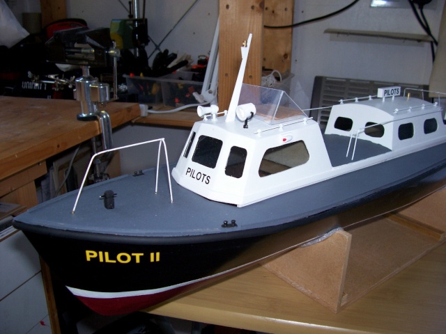

Before painting the deck I decided to varnish the hull after fitting the names which I cut yesterday. The varnish took longer to dry than normal, so I had to find something else to do Smile  I made the mast and also the sign for the roof of the rear cabin.
Given the change in the weather I decided to hand paint the hand rails etc to avoid delay. Thy have had one coat and will probably need another tomorrow.That's all I managed this morning - Grandson comes this afternoon - I have to save my energy lol!  lol!  lol!
Tomorrow I really must sort out fitting the rear well, then I can paint the deck and also fit some rubber fendering.

The rear well is now finished - painted, benches installed and a fixing method devised. The rear hand rails are also installed and the decks have been painted and given a coat of matt varnish.
I keep thinking that I have nearly finished, then realise I haven't Rolling Eyes  I still have to glaze the windows, apply the rubber fendering, make the front hand rails - oh and re-fit the electrics! I have a searchlight and flag staff on order as well.

Today I glazed most of the windows, although its not too obvious from the photo. Just the front ones to do. I also made the handrails for the bow. At the moment they slot into the wheelhouse front, but I think this may have to change. Its quite tricky to get the wheelhouse on. If I can find a way of fitting a switch which doesn't need the cabin removing, then it can stay as it is.
As I was taking the photo I realised that the deck between the two cabins should be grey not white, so that has had one coat of dark grey.

A little more done. Smile  The fittings installed, the remaining windows glazed and the cabin door and hatch fitted. I've started sticking the rubber fender, still quite a bit more to do on that. Rolling Eyes
There is supposed to be a windscreen on top of the forward cabin. Not sure why as there is no steering position there - I'll have a go, but it may not get fitted.

Almost a week gone and I finally managed some modelling 2thumbsup
The Pilot boat is now almost complete. I have fitted the last few items and re-installed the electrics. I have made a windscreen, but its waiting for the glue to dry. Hopefully it will be fitted tomorrow and then a dip in the bath to sort out the ballast. With a bit of luck it will get a run on the lake on Sunday. I do have a feeling that it needs a different motor. Its got a 38x at the moment, which I suspect may be a 383 as it is very high revving - would be better with a 385 I think. I have abandoned the idea of a switch as its just too tight - I will disconnect the battery instead. Since I took the photos I have also cut off the forward rail at the upright as it was too fragile.

I finally finished it today. I've changed the motor to an MFA 385 which I think will be OK on 6 volts. I've fitted the windscreen, and installed some ballast in the stern. All being well - that is if I remember to take the batteries, transmitter etc - I will try it in the water tomorrow. It currently has a 35mm prop and I'm taking a 30mm and a 25mm, although I doubt I will change it at the lake - too cold for that amount of messing about Rolling Eyes

A reasonably successful maiden voyage Thumbup  It sailed very well, although the bow is a little heavy. A little more ballast in the stern and a lighter battery up front should improve things. Unfortunately I can't move the battery, except to put it across the boat, and my 6v NiMh wont fit like that. I do have a 6v AA pack which I will try next, otherwise  I need to buy a lightweight LiPo pack. That would also give me more volts which may be a good thing.
Apart from this the only problem was some water ingress - I think via the prop shaft, so a little grease will be applied Wink

I think you are probably correct. In fact the plans show a white under water with a quite broad red stripe which broadens even more at the bow. I wasn't keen on the white, but may do the stripe in white now I know it sails OK.
Posts : 1300
PostSubject: Re: Pilot Boat II   Tue Oct 28, 2014 2:37 pm
As suggested by David, I have now added a stripe at the water line - it was planned to broaden out at the bow Wink I will keep a look out for some figures - its 1/16th scale I believe, otherwise its finished apart from some possible changes to the ballast and/or battery.
