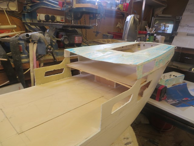

finally got round to doing a bit of work on it....made the two engine room housings that the funnels sit on, glued them in place with 2 part epoxy and then cut out the main car deck ramp doors.
the blocks of wood inside the two housings are to locate brass tubes into which will allow eventually the removable quad mast to slide into when on the lake, but able to be dismasted for carrying in the car.

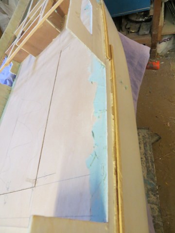

cutting the sections out for the ramps was easy using a drill for the horizontal cut close to the deck and my trusty piercing saw for the verticals .
the last bit of cutting will be the rhomboidal cut outs of the bulwarks and upper casing.. yet to be cut in template form first.

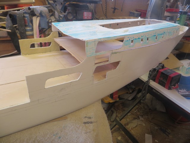

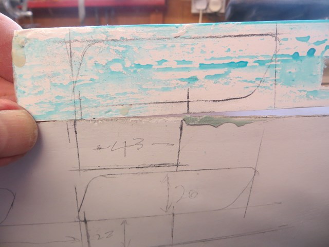

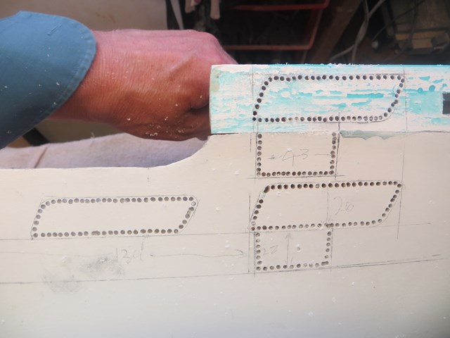

done a little more today.........

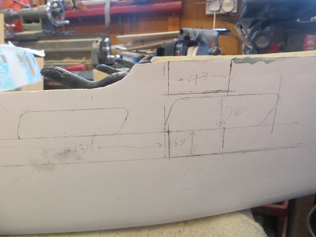

first cut as template for the side openings to the bulwarks and shelter decks where the passenger gates are for the gangways for foot sloggers..........
then it was a case of methodically and carefully marking these out as any mistakes would be a glaring mess.
also contrary to the plans, the two forward openings are the same size, same length and height where as the aft one is same length but of a lesser height than the other two.
the gates are all same width.
the rear ramp was also marked and all were cut out in my usual way of pilot holes and then reaming out using the side shank of the bit

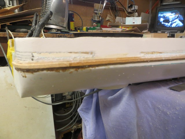

I also marked up for the hull belting onto the hull, and cut the first layer from 1.5mm ply........this will be glued on tomorrow using 2 part epoxy.
all goes well, and hopefully once the first layer of belting is attached and set, a square stringer of obeche will be glued and pinned with brass pins to the wooden layer and then sanded to shape.

anyway today I have been putting the first layer of the hull protection belting onto the ship.........it was marked out weeks ago, so only had to drill between the marks to give the glue some key holes to adhere into and then glue on the pre cut strips with two part epoxy..the stern curve was facilitated by steaming the strip in a kettle and then bending whilst still moist and holding in place till it dried......then glued and held with masking tape.

and another 4 weeks on and only managed to get some  protective belting onto the hull...........as Michael Gove says............I MUST DO BETTER,LOL

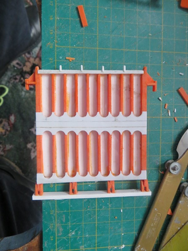

well, spent nearly 5 hours two nights ago constructing the rear ramp for the Jupiter......and then got a text this morning from my Mentor Andrew...........to say that the Jupiter ramp has a different configuration to the Saturn which I based the ramp on................I do wish these ship builders would make em all the same............well at least the new ramp will be an easier one to build, lol
even the Juno and the Jupiter are different in that the Jupiter has some "filigree" running across the width of the ramp, whilst the Juno doesn't.............so I will this time construct the ramp without the "filigree" and mould that plate separately so that it can glued on afterwards.

so, onwards and upwards.............4 more hours tonight and the revamped ramp is almost ready, just the top bracket pivots to put on once I have made the top flaps to the ramp, and will start these tonight, finishing them off tomorrow............all this will then be put into rtv rubber moulds to take mouldings off.............then onto the side port/starboard ramps............will just make one of those which can then be moulded for both sides.
the "filigree" was made using my trusty compass cutter......a great little asset for the workshop.

cheers matey............and todays offerings are the top ramp flaps which are a bridging ramp from main to the harbour ramps...........these will be hinged to the top of the ramps.......the thinner one is for the port and starboard side ramps........and only one thinner flap fits at the end of the row of five flaps on the wider ramp......which I'll be making next.
