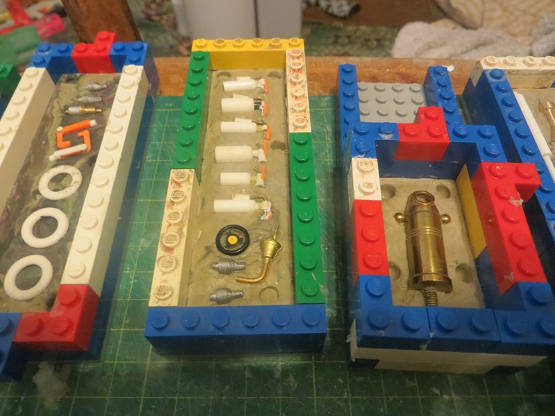

thank gawd for Lego.......115 small items of fittings now entombed in plastecine and lego moulding boxes.
In the main most of these are surface cast fittings, but three boxes will be split moulds.
more boxes yet to fill, but some, being made from timber will have to be sealed with cellulose sanding sealer first before moulding, and others being quite large will need to be fitted in their own boxes, and all remaining will be split moulds.

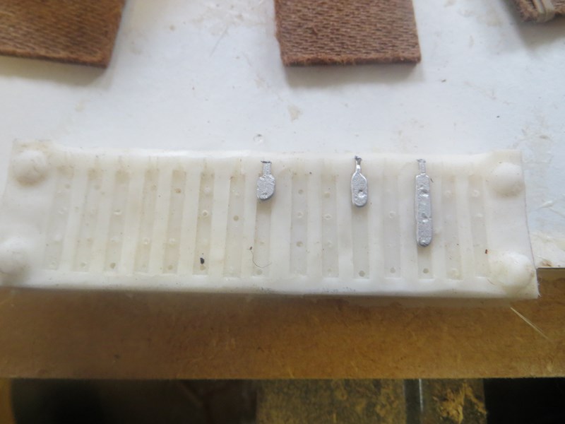

the moulding goes on and every time a mould comes from the lego it has to be trimmed and cleaned up..........plenty more to go but will now cease putting monotonous shots of moulds up on the thread as they are basically now all the same, lol

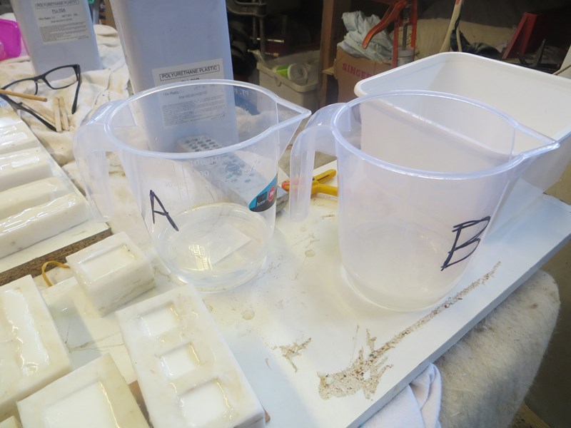

finally got down to somwe casting, and not in my usual style of looks ok, will be ok, I actually invested in a small set of digital scales that cost me 7 quid from asda. I also invested in a couple of jugs which I marked A and B for the two resins and plenty of margarine, chream cheese and other assortment of little mixing pouring pots.
I was fed up of not mixing the exact amounts of each, giving rubbery or bubbly castings because of the imbalance of resin to hardener that I was judging by eye...........
and guess, what.............the mixes went great.
I am also using a new resin ( polyurethane none brittle) from another company and it is far less viscous that the stuff I was using from CFS and actually pours very well.........almost like water up until it goes off..........and hopefully this will help when I pour the split moulds with the large and small thin parts.
It also sets white rather than cream in colour.

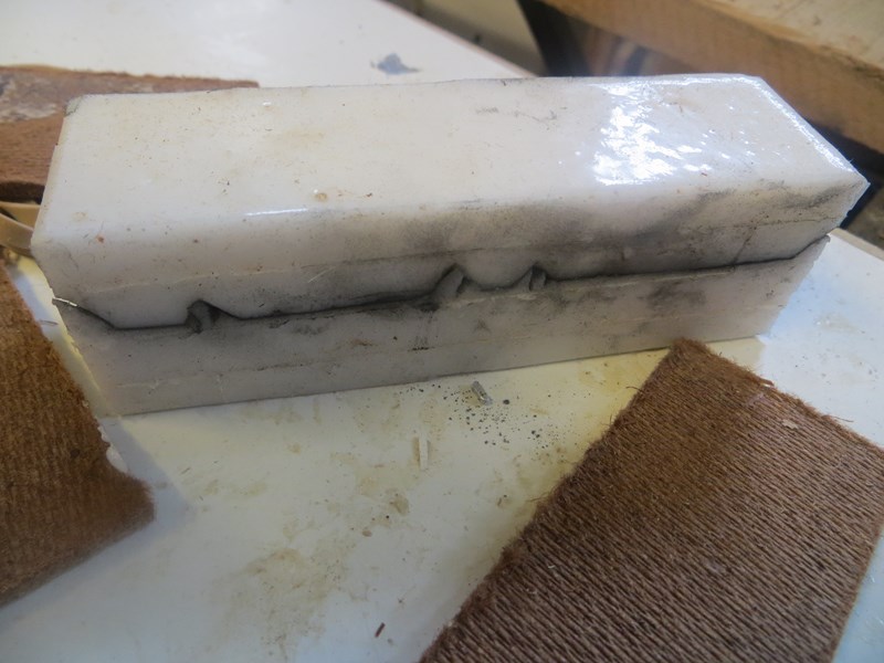

Now then...............I have just pulled the first castings out of the  moulds........and was very very pleased with how my new resin has cast..........the replication of the small detail that I am these days capable of working at 1:43 scale is excellent.........might not please some, but I am happy with the outcome........so onwards and upwards and will now knuckle down to making the three sets needed for me and my friends, who are needing them.

Nice looking casts you have there Neil. Seems to give better results than the other stuff, where is it from??

That looks real good Neil, your casting seem to be coming out a lot better with the new resin. I reckon I will have to give that resin a try...

cheers mark..........it feels a lighter resin as well.......just one thing i noticed though is that there is a very slight shrinkage to it compared with cfs.............try and get a photo of it...............but it's only on the larger block items.

PostSubject: Re: Jupiter, a Caledonian macBrayne Ferry   Sat Jul 11, 2015 7:34 pm
STANCHIONS..........the horror of any scratch builder's life............and these are no exception.
I need a multitude of 3 rail flat bar stanchions for Jupiter, and so decided to make some in plastic so that I could mould them in either polyurethane resin ( the none brittle type) or in white metal.
so I made some from 1.5mm plasticard and set them into a hand pour mould.
Tried casting them in the polyurethane resin a week or so ago with very very poor results.........not one came out.
the feed hole was far too small and when I tried to get what few came out in the mould, they just snapped in half.......the none brittle resin was in fact very brittle, and to be honest, I wouldn't use again preferring CFS resin instead, even though fractionally dearer.
So then I tried white metal.................
got the melt pot going this afternoon, and then brushed the moulds with carbon powder for a better feed for the white metal. Cut bleed holes in the bottom of the moulds for expelling the air, cleared off the slag from the top of the white metal when up to temp. and began casting.
the first photos are of the first cast without carbon powder on the moulds......second set of cast photos are with the powder.............
but disaster .........the moulds aren't playing ball...........and without making a round mould to fit my centrifugal caster for a faster forced cast it's a case of either going down a brass etched set or finding a manufacturer who sells them either in brass or white metal ........I have just enough though to clean up to go on the companionway under the car deck and so be able to put the next deck on where almost all the stanchions are positioned.........bit p**** off to tell you the truth.
