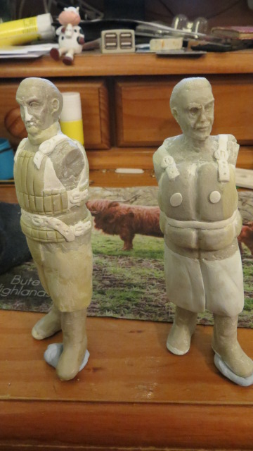

after finishing the transformation of the first set of figures from the 1960's costume to the old cork vests, and before I set about sanding them to a finish ready for moulding I started the other day on the second set of figures with the Kapok style lifejackets from the 1930's.
Had to trim off the shoulder supports and then add the pockets around sides and backs. All takes time with milliput, and was going great guns until my elder daughter came hope with a fever and sore throat..........

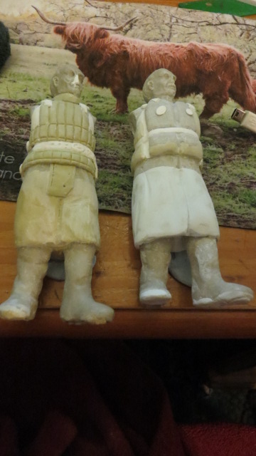

Today I finished modifying the little figures onto their cork and Kapok lifevests.
the milliput has hardened enough to carve and sand the final detais before going too hard, and these two gents were the first two to be almost ready got the moulfing pot.....they are the same figure, but with different vests as per photos found on the internet and supplied by andrew...
a final sanding and a little scraping once I have the other 17 figures to the same state and then I'll start moulding them before handing them all over to Adrian Clutterbuck for production.

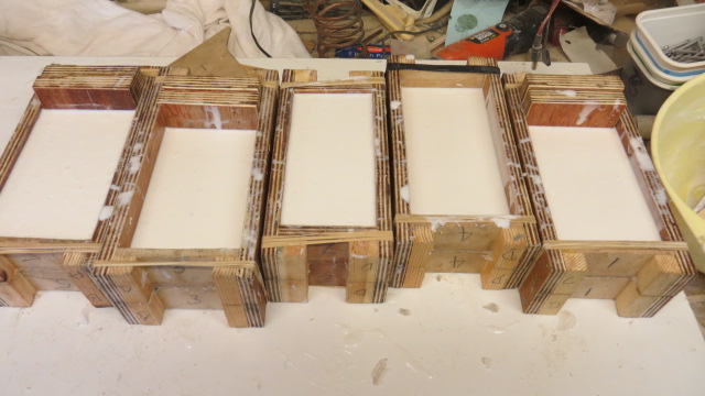

Usually with a small amount of casting I'll make these boxes from Lego bricks ..........but there are so many of these chappies ( think they are hermaphrodite and breeding over night as there were at least 18 at last count ) I decided to make some casting boxes from ply wood.
the astute members will notice from the photos that there is only one length and one side..................errr, No!.........I'm not loosing it quite, just yet!??
those two pieces will be split length ways to make the boxes approximately 3.25inches deep in total and then the ends screwed to the lengths to make a box with an internal measurement of 6" x 3" x 3" in total.
Finally the constructed (but able to take apart) box will then again be split down the middle to make two exactly halves so that the mould can be made and split with ease. the halves will be held together to avoid leekage of rubber between the split by strong elastic bands.(hopefully, and that's the theory .
Posts : 3002
PostSubject: Re: MY NEW PROJECT...or two.   Tue Jan 29, 2013 9:02 pm
Boxes now complete and split into two halves.
a simple jig was mounted on the pillar drill bed to drill all the holes in the ends of the sides and the ends and sides are screwed together so that once moulded in rubber, the mould can be released by unscrewing the box.
they now need sanding down and then waxing and vaseline spreading into the bare timber to act as a release agent before loading up with plastecine, the figures and moulding.

Still at it, getting the moulding boxes ready for use.
Lego boxes are great because the two halves interlock. however once these wooden ones were split, there was mothing to stop the top and bottom halves sliding around when put together, and so drilled at the four corners this morning and glued in some brass pins to locate top and bottom halves together.
then once put together with elastic bands to hold, plus some vaseline sealant between the two halves, the rubber from the moulds technically won't leak out ( well that's the theory but having never done this with rubber moulds)......anything is possible,

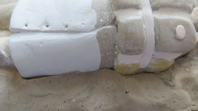

so, this afternoon I have spent the time "loading up" the first two figures into the boxes..
starting with the bottom half..
Place the figure in and set in with lumps of plastecine
Surround the figure with plastecine and make up to the box wall.
Further add plastecine up to the figure.
Using a steel scribe, run around the edges of the plastecine touching the figure to get rid of any gaps so as to minimise moulding flash. One shot shows the gaps that occur between figure and mould and anouther shows these having been illiminated.
Place top half of box on and then run a fillet of plastecine around the edge, covering the joint of the box top and bottom to stop rubber leaking out.
Finally make some hollows in the plastecine which will act as locating lugs to stop the empty mould halves sliding around when moulding.
The first and second figures are now ready to have the first rubber half moulded.

the five mould boxes with the first half of the rubber mould poured in......8 hours now to being cured and ready to split........so will probably let them cure overnight.
Have just made three more casting boxes to speed up the process and am now, when put together, able to cast 8 figures at once.

anyway, today I made 3 more casting boxes, but as they were made the same dims as the 1st 5 boxes, they are too long for some figures such as the seated ones, and so, not to waste costly rubber in making oversized rubber moulds where the rubber is doing nothing but being a "packing agent" I used wooden blanks to shorten the interior of the moulds for casting..
the three boxes below show the packing blanks in place.

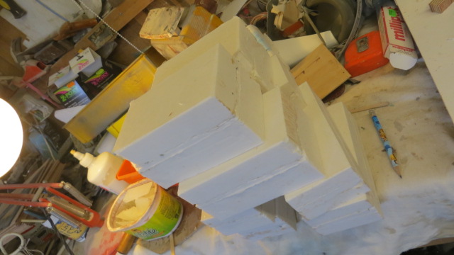

How to use over two hundred dollars worth of RTV rubber in one easy go.
The second halves of the first five figure moulds have beed laid up, but not before the figure and the rubber surface were given a good coating of vaseline as a release agent.
The company did send some release spray agent, and I had used this brand before some years ago, and it didn't work........I had to cut the mould apart, completely ruining it.
So this time I made a small 2,5mm square test mould and used the release agent between layers, and it still didn't work and the mould wouldn't separate, and had to be cut apart, and that is why I have used vaseline.
I have also put it onto the adjoining edges of the mould boxes to act as a seal, and held the boxes together with strong P.O. best elastic bands, courtesy of my postie.
But 3 halves and five full moulds 120 x 70 x 80mm internal moulds, complete with figure trapped inside, has taken a full 5 kilos of RTV rubber........Forgot how expensive mould making can be, lol

Back to the figures now............
I'm like an unstopable train now................crashing on as fast as the rubber will cure.
got the second halves of the seeted chappies done which are curing, along with the first halves of five other figures, while having made the casting boxes vacent for these five, I removed the first set of five figures ( c'mon guys keep up, or am I confusing you all) and split the moulds.
Now this was a little harder than I had thought, as the vaseline had made a really super seal on the edges of the boxes and needed to be wedged apart in the first instance.
Also in one of the shots, you'll see that in certain small areas where I couldn't get my release agent ( vaseline) into the tightest spots the second half of rubber adhered to the firts half and had to be snipped off.
All in all though, the first five moulds seem to have come out jolly well..............am looking forward to "running in" the moulds with some casts towards the end of the week.

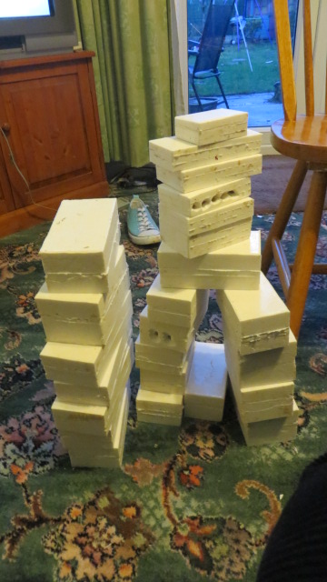

It is no wonder that vendors charge a decent rate for their castings, and I can understand their annoyance when people moan about the cost of items today.
It has taken me some long hours to make the figures that I have completed for Adrian Clutterbuck, and it would have taken many more had I not been able to convert existing figures into what I have now moulded.
Also, the three large moulds shown on the scales each weighs a Kilo, which equates to 20 quid's worth of fubber for each mould.
In total the pile of moulds that can be seen plus toe ones in the boxes this morning's casting session (12 in total have cost, inc. post and packing) just over £10.00p each in rubber to produce..........and that doesn't include time to mould, and develope the figures.
Just another six figures to go!!!
So, when next you see stuff at shows remember what it takes to produce them in the first place, and these moulds ARE expendable after a while.......they don't last for ever.

Just over six weeks ago I started to re jig and re "costume" the set of lifeboat figures I developed, and it has been a constant slog on the road to producing the moulds for some new figures.
countless hours , £300.00p + and 24 moulds later I am now ready to try them out to see if they mould well or not..............I have "cut" the moulds with the channels for the resin to flow, so hopefully tomorrow I'll start "running" the moulds in. wish me luck.

Looks like 2 different photo's there Neil no shoe in the second does this mean you've made to many moulds lol looking forward to seeing these fellows emerge from the moulds
