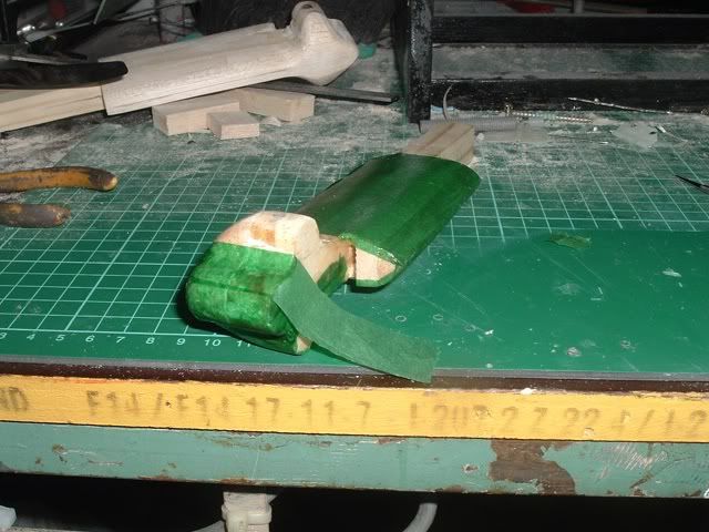

Ok here goes.
Purchased some wrapping tissue at chicken feed ($2 type store) 5 sheets for a $1
I agree with Phil Jap or rice tissue is best however one use what we can get this green tissue is not as porous as i'd like so the technique is as follows for 2 engine towers and rudders.

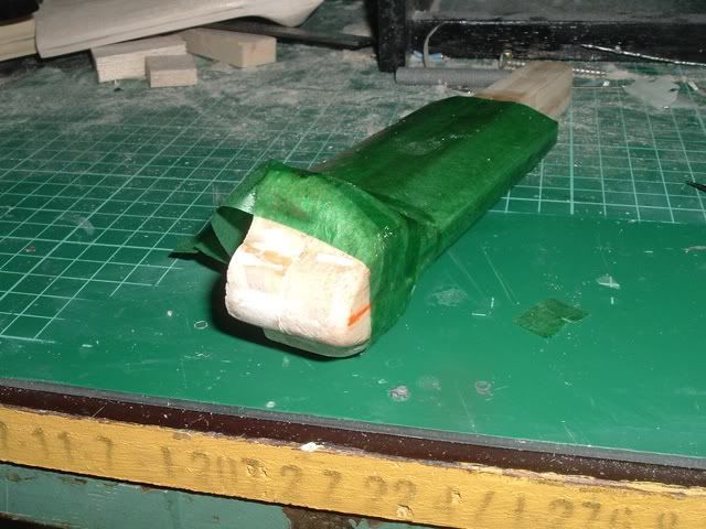

Cut tissue a little larger than required coat object with dope, lay tissue on wet dope and apply dope to top of tissue being careful to avoid wrinkles while the dope is still wet wrinkles can be worked out with a finger.
One side done next over lap fold to the other side I use a No11 scalpel to cut the corners as needed.

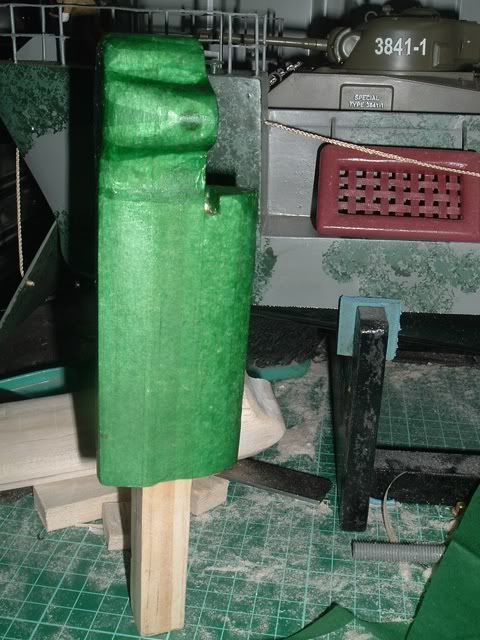

Next to one of the motor towers the lower section although air foil shaped is still flat and a single piece of tissue is laid around it finishing with a slight overlap the top section is cross shaped with compound curves I tackled them with 1/2" wide strips this is where the finger really works to get the tissue to conform to the curves.
This is as far as I got today when the sinus and headache from the acetone fumes got too strong in the shed will do some more tomorrow.

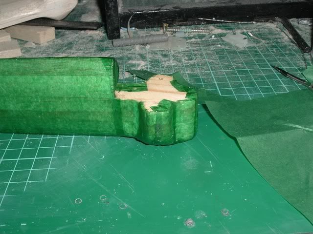

In my comment after the first photo in my previous I should have said after applying tissue and before working out any wrinkles apply top coat of dope then with finger or brush work out any bubbles or wrinkles.
OK so I was bitten by the bug and just had to finish them. lol! lol!
This tissue was not high quality and had small holes throughout so some patches can be seen overall I'm happy with them though.
And final pic 2 motor towers and 2 rudders.
Any more questions just ask.
