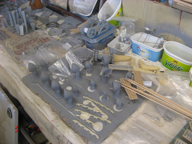

Anyway dreaming of lovely holidays apart, I made an early start this morning sorting my bench so that I could collect all my fittings fogether.
And now the great slog begins.............all building and casting done..........I just have to get all these fittings painted, detailed and fixed to the models before June 20th and Etherow, the National Lifeboat Rally........can it be done.
All of the plastic bags also contain small and minute fittings that have to be painted and fitted, both inside and outside the boat cockpits to varying degrees.

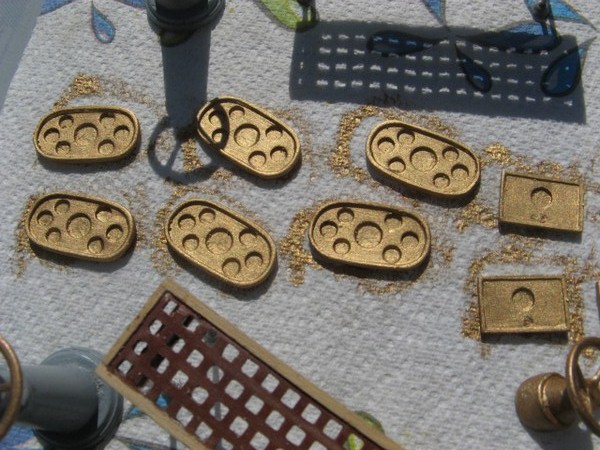

today I fitted the deck lights and surrounds plus painted a few fittings, and fitted the engine reversing wheels to their plinths......the pile gets a little smaller of "to do" things.
The deck lights, although not the right colour ( as I couldn't accertain the right colour do give a little depth to the things, and so, at the moment will do the job until a certainty of colour comes along.....they are easily changeable as they are held together and in their recesses by double sided tape.............so are removeable....but I needed to start somewhere and getting some fittings on deck is better than procrastinating and doing sod all .
