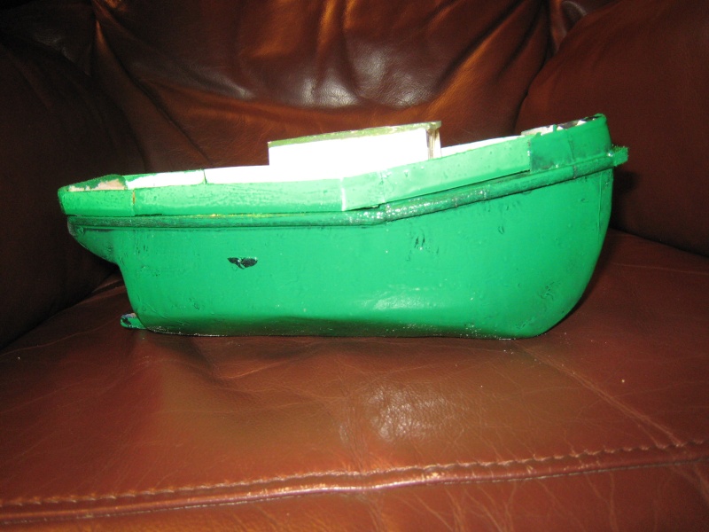

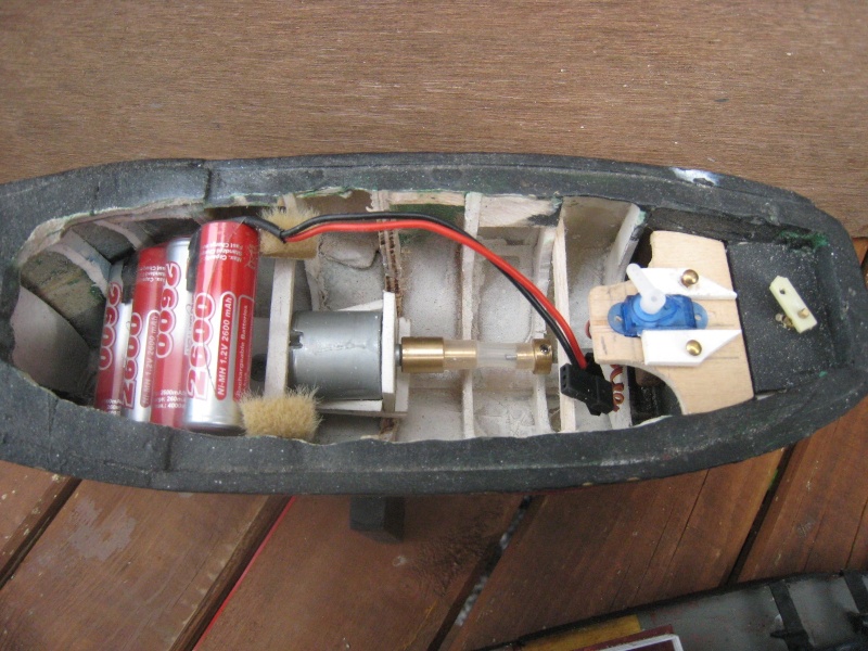

Nearly finished. The photos shows her in the water with lead bits as ballast, but no RC components installed. I was warned she maybe
top heavy, and I think I have a problem. There isn't too much room for anything, see photo. So when the ESC , RC Receiver, battery, are in and the biggest problem the cables she topples over. I have heard of Liquid Gravity which may help with ballast but I am going to try smaller battery, or a iron bar on the bottom of keel, I think she will sink then. I think its a case of "Watch this space"
Battery and Servos

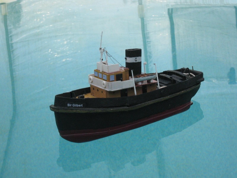

Sir Gilbert
Sir Gilbert and Furness Withy Cargo "Pacific Envoy" in Manchester Ship Canal !!!

She is brilliant. I love her..

She looks a picture mate,
One way round the stability problem is a removeable keel that bolts to the keel proper to get the ballast weight below the boat, this can be removed when not sailing and one advantage is it requires very little weight to keep the vessel stable. Its all down to leverage and moment arms and in the case of your tug would prob only need to be about 2" deep with a lead bulb equivilant to what ever ballast weight you have used to get her down to water line and by removing that ballast you would also have more room inside the hull for bty's etc

Try using a square battery pack instead of a flat one, it seems to be sitting really high like that, a square one might sit down in the curve of the hull better.

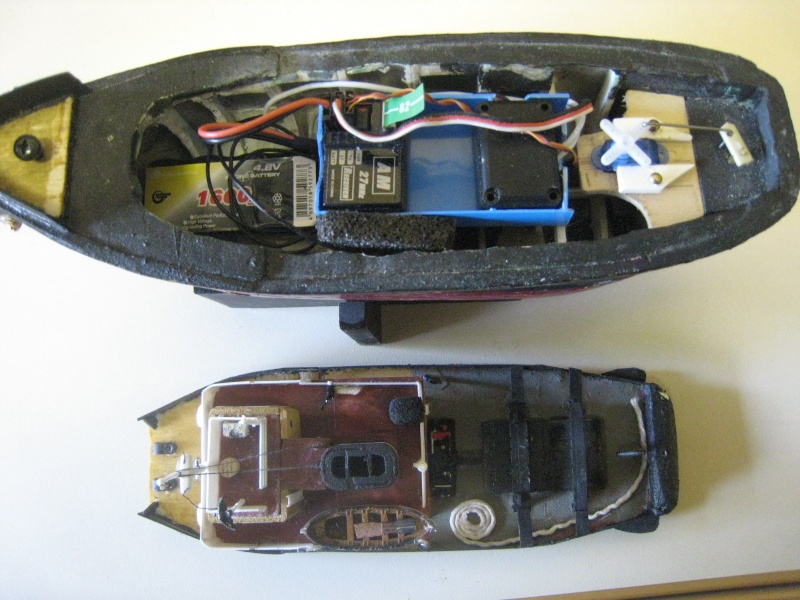

All the bits are in, with new battery now sitting on keel. Liquid gravity i.e small balls of weight shot glued in as ballast.
Not Happy ....Cables on top causes problem with sitting deck back on.
RC servo twitches like mad, not all the time I suspected its the aerial being to close to battery.
Also not happy when in water: as she is very low, and panic set in as wind came across pool. ..... may set ESC under prop shaft there maybe room.......
affraid

Thats turned out better then i expect, Weldone on your build!
With regards to your stability, tugs do sit low in the water, especially ones like yours, remember a tug sits low to maximise pulling strength , the deeper the prop the greater the torque pull!
However , i recently saw a mini tug smaller then the one you build and it sails beautifully, but his did have a false keel, so this probably where you should be looking to fix.
However sometimes some models just never sail right, i have had a few, and spent weeks and weeks trying to make sail right and failed no matter what i do, tugs are prone to that even more so given there rounded hull shape, they will role badly and more so at very small scales the effect look dramatic, just remember you cannot scale water so any scale model is still subject to real conditions, it may just be one of those boats you can sail in very calm waters.

I have reconfig. the setup inside, and stopped the engine vibration with padding on each side, and the ESC is now on top of the battery so I don't get the servo twitching. But I do have a problem : it goes out of range of the transmitter at about 6 yards !!! It just stops until I move the signal closer and off it goes again. The receiver is a AM 27MHz (from Ebay) I have 3 other models which have a different receiver, with no probs. which I bought from a local dealer, I am wondering if the AM is an poor product, it was cheap. Six yards is a joke. I have moved the aerial around but its still in the hull, getting it above the deck will be difficult. The pool has a steel frame above it like a tent structure for a plastic cover during the Summer, I understand that this may not help the receiver. Any ideas please.

I would suggest possibly a duff receiver as you should get way more than that range, even with the aerial coiled up in a tight knot.

Since my last message I have found out why the Transmitter was losing
the receiver. The crystal I was using in Trans and Rec was 40MHz but the
receiver was built for a 27MHz. Should live and learn !!!

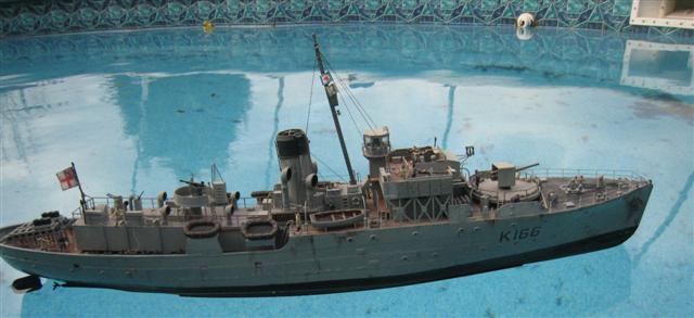

also finished the RC'ing of the Snowberry, she sails well until a wind
whips across the pool, so she certainly not suitable for convoy duty !!!
I think I will get a bigger prop as this may help.

Forgot to upload pic
Posts : 554
PostSubject: Re: Small Tug "Sir Gilbert"    Tue Jan 10, 2012 7:28 am
She certainly looks well. Any chance of seeing some detail photos??

I put 3 photos on "WAR SHIPS" back in August.

PostSubject: Re: Small Tug "Sir Gilbert"    Thu Feb 02, 2012 2:29 pm
Despite the crystal change the servo still "twitches" like mad, when the prop is run, or even when nothing is touched. I have a P38 ESC, and I switch on the trans. before plugin the battery, also I extend the ariel. Move the Rec. around also the ariel wire, sometimes the prop starts moving, and the sometimes the prop runs off and does not stop even after the trans is switched off. l had a the Rec. replaced even though I caused the problem.
I love the little thing (talking about the Tug) but she is a pain, any ideas chaps. Thanks
Pete
Posts : 2682
PostSubject: Re: Small Tug "Sir Gilbert"    Thu Feb 02, 2012 10:15 pm
I doubt there is anything wrong with the receiver it will be the antenna coil shown in the pic in this situation the antenna is effectively only a few inches long, for full range the antenna needs to be kept full length and straight every fold or coil shortens the antenna and subsequently the range. Only 2 choices in a tiny model 2.4gig set or accept the limited range.

Posts : 1264
PostSubject: Re: Small Tug "Sir Gilbert"    Fri Feb 03, 2012 7:25 am
I have to slightly disagree with Damien. Take a look at this installation in my 18 cm French ferry. I had no problems with this set-up - only finding somewhere to sail it apart from the bath Very Happy
This was on 40Mhz and the motor was suppressed.
Posts : 2682
PostSubject: Re: Small Tug "Sir Gilbert"    Fri Feb 03, 2012 10:06 am
Barrie assuming the green wire is the Rx antenna you have an effective ant. length of 6 - 8"
The antenna length as supplied by equipment manufacturers is the ideal for that frequency shortening it or coiling it will reduce the range and sensitivity of the system, bath tubs or garden pools you may get away with but with other RC sets on close frequencies will cause interference.
Different frequencies will present different problems eg. I believe 2.4ghz must have the short antenna above the waterlineand therefore the Rx as well.
Posts : 1264
PostSubject: Re: Small Tug "Sir Gilbert"    Fri Feb 03, 2012 10:16 am
I know the theory Damien, but I can assure you that I used this technique in a number of boats when I used 40Mhz with no range problems. The aerial is not shortened, so there is no problem with matching of the aerial to the receiver, and provided the aerial is spaced out on the former, I did not find any loss of range. In the little tug I did not space it out as range was not an issue.
Posts : 2682
PostSubject: Re: Small Tug "Sir Gilbert"    Fri Feb 03, 2012 10:27 am
Barrie what is the max distance your model gets from the transmitter?
PJG1412
Posts : 33
Join date : 2011-08-07
Age : 73
Location : Surrey
PostSubject: Re: Small Tug "Sir Gilbert"    Fri Feb 03, 2012 11:30 am
Suppressor ....sounds good ......I have only got one 1KV from pos to neg, I will change to 2, watch this space. Pete
Posts : 1264
PostSubject: Re: Small Tug "Sir Gilbert"    Fri Feb 03, 2012 5:21 pm
Damien, When I was using a coiled aerial, I guess about 100 to 150 yards. The water I was sailing on then wasn't much bigger than that. I also have difficulty seeing what the model is doing at a greater distance Shocked
Posts : 2682
PostSubject: Re: Small Tug "Sir Gilbert"    Fri Feb 03, 2012 9:37 pm
I have that the same problem with distance I keep my models within 50mt even at 20mt i can't tell which side of a buoy it's approaching.
Posts : 601
Age : 61
PostSubject: Re: Small Tug "Sir Gilbert"    Mon Feb 06, 2012 9:43 pm
The thing with suppressing that's often missed is even two or three suppressors does not give guaranteed results unless the motor case is earthed to the prop tube or shaft giving effective grounding through the water also watch for metal to metal joints that are not a tight fit ie steel control rods on a brass servo horn as the dissimilar metal interaction can cause electrical interference. not such an issue with the prop shaft to tube interface as both are grounded in the water
