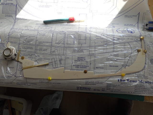

Thanks Dave - it certainly looks to be a quality kit. Most of the wood is a version of Liteply. I'm not sure how it has been cut - they call it Micro Cut which just leaves a slight burr on one side. The plan is good if a little cramped, but every thing appears to be there. There was no prop shaft supplied as they expect you to buy either the electric or steam pack, so I bought a 3.5 inch one from MMB.
Its just been fitted. A slightly strange method of gluing it into the keel when the latter is flat on the board. It seems as though this ensures it is slightly off centre, as the keel thickness is less than the diameter of the tube. I have tried to centre it by packing up the keel.
The rudder tube has also been fitted. The rudder is made from a brass rod and liteply blade, so I have drilled the rod to take some brass wire into the blade.

The Lobster Boat also has that slightly off-centre way of fitting the shaft, and I too packed it out so that it was central with the skeg. I've been trying to read the plan ref length and beam but your picture isn't quite large enough for me to make them out. Could you tell me the numbers, please?
Here is the CMB website's piccy of the Victory (cute, huh?) which totally belies the chaos awaiting any buyer. Apparently it's "now better than ever" since a redesign in 2012 - Lord ha' mercy!! BTW the real one isn't a tug at all - it's a rich man's weekend cruiser made up to look like one (complete with the option of a BMW diesel engine). I'd sooner have a Fairey Huntsman.
Don't lose that Midwest plan - I might well come to you for a copy at some time.

The keel has been removed from the building board and the keel strips fitted. All the bulkheads have been removed from their boards and edges tidied up.
Before I started assembly I drew round the bulkheads so they can be used as templates should anyone else fancy building this.
This version of Liteply is very weak - the narrow bulwark supports are particularly fragile - I've snapped two of them already just trial fitting them to the deck. The main and sub-deck halves have been glued together and I am ready now to assemble the bulkheads to the deck.

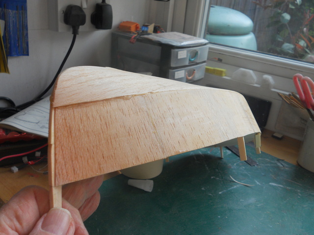

The other side has been planked. Before doing so I gave the inside and out of the first side a coat of EzeKote resin. I wont be able to do all the inside of the second side, but as its going to be covered with tissue and more resin it should be OK.
I have also fixed the bottom skin on one side. This is quite tricky as there are some sharpish curves, and not much opportunity to clamp. I used aliphatic glue, maybe CA would have been better  Rolling Eyes  The instructions say to spray with Windex which I assume includes ammonia in its makeup to soften the wood. As I didn't have any - I didn't use it lol!   There is quite a lot of material to trim off when its dry.

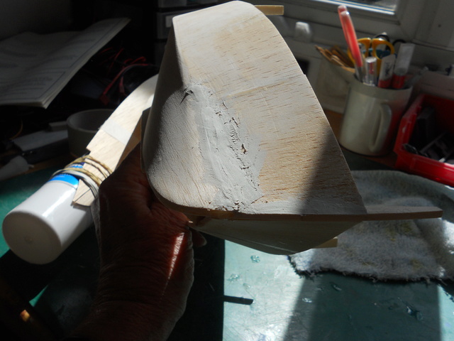

This morning, the very front of the skin had not stuck, so I attacked it with super glue and eventually got it fixed. As you can see, there is an awkward overhang to remove
After sanding, I was still left with a problem from all the superglue Embarassed Rolling Eyes, but also the shape didn't appear correct, so out came the filler lol!
after several iterations of filler and sanding I have an acceptable shape - which I forgot to photograph Shocked
The second skin gave me lots of trouble - in fact it split. I tried to glue the split but it didn't hold. I have some 1/16th balsa, but its only 3" wide and the skin needs 4" bounce bounce As previously mentioned, I have some 0.8 mm ply so I decided to try that, the alternative being a 50 mile round trip to buy one sheet of balsa.
This has now been fitted.
using super glue this time. As you can see, there is a lot of work required to bring it to the same profile as the other side Rolling Eyes This is supposed to be a beginners boat, but this area is actually quite tricky unless the Windex makes it easy lol! .
One other problem - most of the bulwark supports have now broken off. bounce bounce bounce They will be replaced with wire stiffening when I'm ready to fit the bulwarks, but only after I've finished shaping the hull.

The excess ply has been trimmed and  filler applied. I think that the two sides are more or less even, although it not easy to be sure until I get some paint on. By then it will have been covered with tissue and resin and may not be able to be corrected. Rolling Eyes
All the bulwark supports have been removed and will be replaced with suitable sized strip wood. These will be glued and pinned to the deck before I fit the bulwarks.

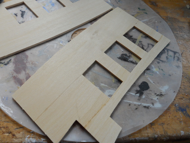

Looking forward to the cabin, I think I have a problem. The sides are made from die cut basswood, but this is already split in the box. Both sides are the same - I have tried a repair but think it may be better to re-make them in Liteply.

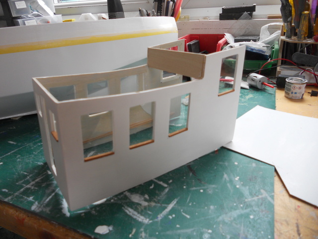

When I came to examine the cabin sides this morning I found more cracks, so decided to make new ones in Liteply. Its slightly thicker and will need more finishing, but should be stronger! The bulwarks have been finished - had to replace a small piece this morning. I just have to bend and fit a bit of strip to the Stem, then it will be ready for resin and tissue.

I finished cutting the windows in the side of the cabin, and decided to cut the front panels in Liteply also. The kit has the rear wall of the cabin blank with a door stuck on, which I didn't like, so I have cut windows in the wall and the door. Rolling Eyes

I set out to build the cabin while waiting for the tissue to arrive. For some reason, the die cut sides were not made full size Shocked It is necessary to add some strip wood to extend them. Rolling Eyes I can only assume that it is because of lack of availability of suitable sized basswood. So I had to use some strips of ply as the ply I used is thicker than the supplied strips bounce I think you can just see the join in this photo lol! The second photo shows all the components of the cabin after treatment with resin.

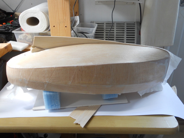

The postman then brought my tissue, so I was able to cover the hull. Quite an awkward shape, so rather more cuts and overlaps than I would like.
And after trimming, sanding and more coats of resin. It will require more of both before its finished Thumbup

The hull has been thoroughly sanded and a final coat of resin applied. It is now ready for painting but its a bit difficult to wear a mask for spraying when your nose is constantly dripping lol!, so it will have to wait a day or two.

Well I actually got some paint on at last. Both primer and two coats of Appliance White. Most of the boat is white with a red stripe and dark underwater, so I sprayed it all.   2thumbsup Just two problems though
I got some runs  Embarassed bounce bounce bounce
The photo I took is out of focus Embarassed Embarassed Embarassed
When its had time to harden, I'll attack it with some 1200 grade wet and dry, then re paint. As most of the hull is white I just sprayed it all. It wasn't worth masking. The other colours can go over the top of the white.

PostSubject: Re: American Coastal Tour Master   Wed May 24, 2017 1:51 pm
Runs sanded out and some blemishes filled. Sprayed primer again and now waiting for top coat, but it turned very warm here, so will leave for another day.
I also painted the stands for the seats, and also the outside walls of the cabin and the window reveals. I need to get these painted so that I can glaze the windows.
I cut a new cabin floor from 1 mm ply, and fitted strengtheners underneath as it was a little bowed. Its had a coat of sanding sealer and is ready for painting.

I was pleasantly surprised when my double sided tape arrived today Thumbup I have glazed all the cabin windows, including the front ones. I have taken the easy way out and used thin acetate stuck across the three windows. I have added window sills on one side only at the moment, but it now looks like this.
I can now fit the floor and seats and probably the front windows, then I have to wait for my figures to come from China!
I have also masked the hull ready to paint the red band. I have painted the edge of the masking tape with white paint which I hope will seal it and prevent the red from seeping under the edge. It worked on the Fishing boat   -  when I remembered the trick half way through painting her Shocked
