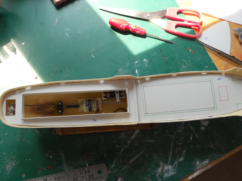

I have finished the installation of the rudder and prop shaft, made a battery box, and fixed a plate for the motor to affix to. I shall probably use silicone for that.
I will be using one of my <£5 Chinese 10 amp speed controls, and the receiver I plan to use is not much bigger, so plenty of room. Thumbup
Next job is to find somewhere for the servo - I think possibly alongside the motor - and make up a linkage.
For a small model this has quite good access, providing you have child size hands  lol! I will have to borrow my Grandson if I need to make changes once the decks are on.

I have now finished installing the electrics - and I have to say I'm pretty pleased with the result.There's not much space and finding a way to hide the cables was tricky, but I think it is quite neat. Thumbup
I've also fitted the coamings round the rear deck hatch and fitted the bearers ready for installation of the deck. In the photo its only laid on for the moment.

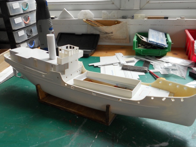

Because nothing seemed to fit, I decided to make the bridge structure to see if that would help. Well - it didn't really because some parts of that didn't fit either bounce bounce. I have now managed to decide on the length of the aft deck, and got the fore deck more or less lined up, but getting the bridge to fit is going to be a challenge as some of it is only 0.5mm plastic card so is very fragile.
The first job this morning was drilling for the portholes, and cutting out incredibly small windows.
I then started assembly. It was not until the sides and back were in place that the front is added. Its only then that you realise that the cabin sides aren't long enough, so there is a gap bounce bounce bounce. I will have to fill it with a small strip. The wheelhouse doors are not in the correct place either - I think I may remake those as they will still come off without too much problem.
I'm also thinking that one reasons for the problems of fitting the bridge to the hull could be that the hull has 'closed up', and it might be an idea to add some beams to widen it a little., although the bridge will still be too long.

I decided that I needed to remake the bridge structure and reduce its length. It really has to fit between the raised part of the bulwarks. This meant making new sides for the wheelhouse - it wasn't possible to shorten the existing one. You will notice a slight change of design Wink
The whole thing does now fit after lots of tweaking, but is looking a bit rough. I hope a coat of paint will hide some of the problems Rolling Eyes. To help decide if the bridge was now the correct length, I made up the main superstructure as well. These now fit together more or less in the their correct places.
I have stuck down the aft deck, after doubling up the bearers fore and aft. The main deck is ready for sticking, I have cut out the hatch opening, which showed up another problem - I cant get my battery pack through the opening bounce bounce bounce bounce I will have to use one of my LiPo packs, possibly with a voltage reducer.
Since taking the photos I have adjusted the fit of the bridge.

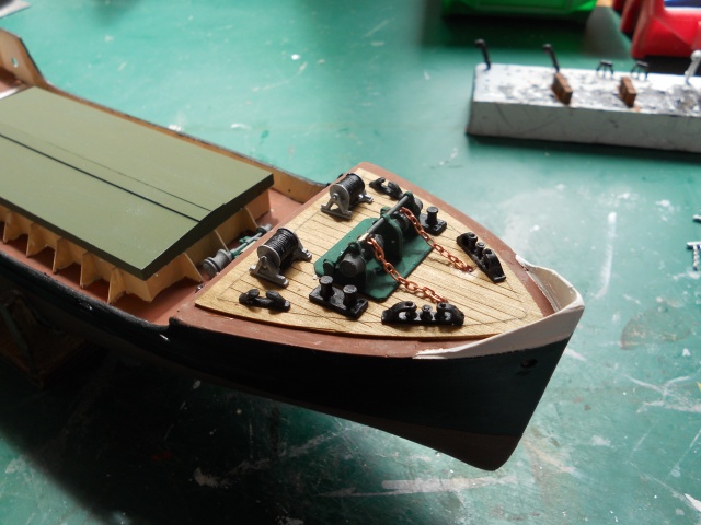

Not a lot to show for the last few days work - I've started painting and have been cleaning up fittings - there are quite a lot Laughing.  Because I built so much of the decks etc, I decided it wasn't feasible to mask things off and spray the hull, and anyway it was raining too heavily today to think about it. So I have started painting the hull by brush. Shocked
I had fun making the two winches - there are no instructions and the photos are not clear enough to see how it should be done Crying or Very sad. I think these are about right, although one of the drums on the cargo winch looks a bit on the big side.

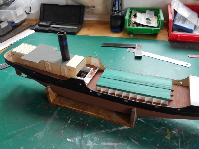

A bit more paint applied today. I touched up the very small areas missed on the hull, and also around those portholes which gave me the trouble. In fact I decided to paint those black. As they are in an enclosed part of the hull, they did not show any light, so decided the best solution was to paint them black Rolling Eyes.
The biggest job was painting the decks. The rear one was not too difficult, but the main deck around the hatch was very tricky. Shocked I will have to re-paint the bulwarks, and some of the hatch supports. The funnel is now fixed, and some pre-printed vinyl which is supposed to represent planking has been fitted. It looks quite ridiculous bounce. I will over paint it brown when my paint comes. There is more of this stuff for the forecastle and I can't decide now if I will use it. I may try to use some 0.8 mm birch ply instead.
The hach cover is NOT the final colour Smile

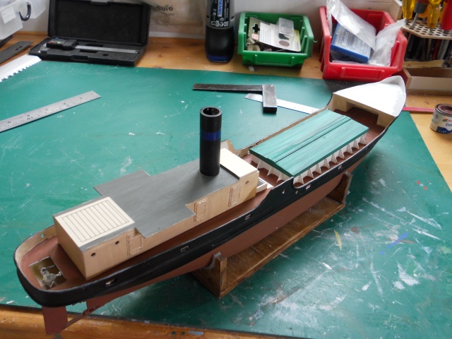

Some more progress! I have replaced the naff printed vinyl deck material with birch ply lined and stained teak - I think it looks much better  Wink
BEFORE
AFTER
and where I've got to today.
I think I need to paint the sides and supports of the forward hold buff instead of white. Rolling Eyes

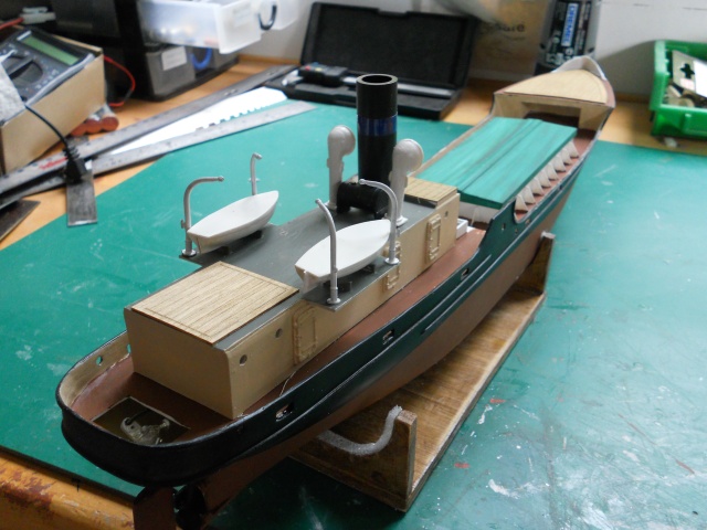

Don't you just love it when your photographs show up all the paint areas you've missed. I am still painting fittings, and seem to miss more than I hit Crying or Very sad A few fittings now installed on the main cabin. It is a little difficult to know where some of them go - the side and plan views on the drawing are different, and both models photographed for the instructions are different again as far as you can tell Exclamation Exclamation For example. the plan view shows a total of 8 cable reels, although there are only 4 supplied, and there isn't actually room for more. bounce I fitted the portholes to the main cabin - lengths of acrylic rod again.
As well as painting and installing fittings, I've given the hatch a coat of buff paint which I think looks better than the white. Hopefully I will have some green and some brown paint on Monday and so will be able to get on with the bridge.
Next job is to drill and pin all the ventilators, paint them and work out where they all go.I also have lots of stantions to clean up and paint.

More progress today. Quite a few fittings now fixed in place. I've left off some of them as it is looking too crowded already Crying or Very sad. My paint came, so I have re-painted the hatch cover, painted the lifeboat covers, and started on the bridge - that requires another coat of brown, then I will have to look at the white areas before I can glaze it.
I started to clean up the stantions ready for painting. The anchors are painted ready for fitting - I think I will need to seal them in the holes otherwise the boat is going to flood Shocked.
Main jobs left apart from the railings, and fitting the bridge, are the mast to taper and the boom to affix. I think I need to be able to move the boom to allow access to the battery etc through the hatch.
