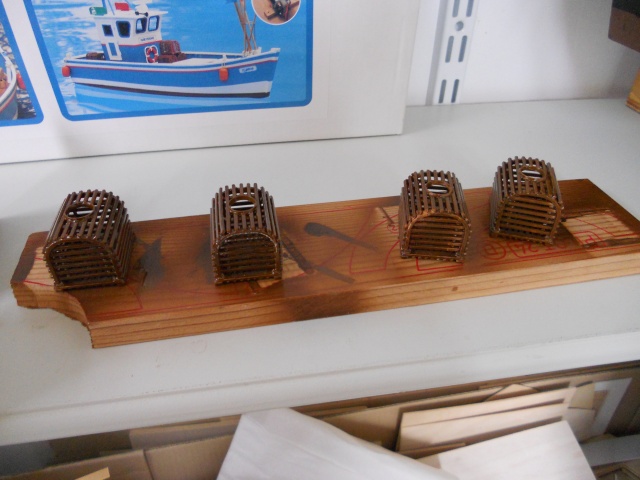

Next job is to fit the bottom skins. Rather strange material is supplied for this. Its like thick veneer - about 1.3mm with a surface which is not very smooth. I think it will require a layer of filler. Rolling Eyes

I love those pots.............absolutely superb.
......but why didn't they mould them in black or brown? They are going to be a devil to paint. Surprised Shocked Mad

I also sprayed the lobster pots with a brown paint bought at B&Q.They are a bit shiny, so will get a coat of matt varnish. Very Happy

You may want to try the dry brushing technique on the pots with browns, blacks and yellows maybe even some green in places to simulate more realistic wear/use on them.

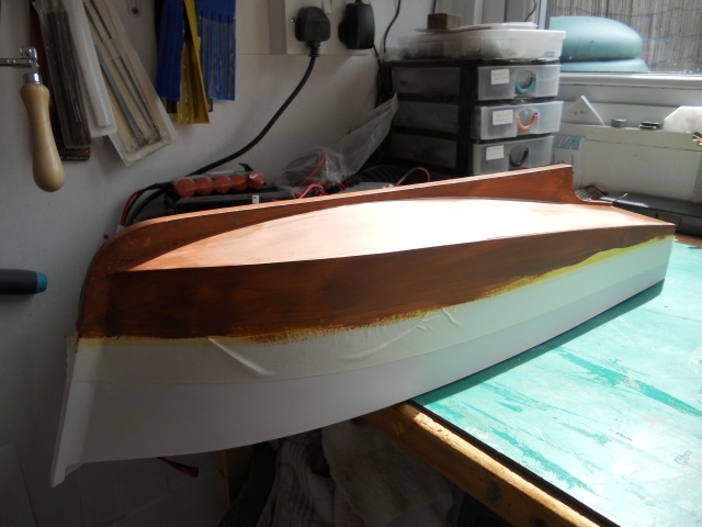

Things are slowing down now as its painting time and I keep needing to wait until the paint hardens so I can mask up for the next colour. The insides of the bulwarks have had one coat of blue - I think this is probably too light, but the next darker one is too 'blue'.
The underside has had a second coat of paint, and when its hardened, I will mask off and paint the top part white. That will probably need two coats before I can mask up for the other colours.
I did give the cabin front and sides another coat of satin white, and treated the other cabin parts to some sanding sealer.  When the white is hard, I will try out my idea for the windows and frames.

The painting continues Rolling Eyes  The top of the hull has had two coats of satin white, and now has a blue stripe just below the top of the gunwales. Next up is the broad blue band. I will paint the red stripe over the blue. The insides of the gunwales have had a second coat and the masking tape removed from the deck. The are a few patches to clean up. Embarassed

The hull has now acquired another stripe Very Happy  Some work is obviously required at the bow where my masking has failed Embarassed Just one more band of colour required.

The hull painting is now almost finished.
In fact, since I took the photo I have sanded back the Stem and repainted it all white. I wasn't too happy with the stripes. The stripes are not as clean as I would have liked. The masking tape I was using claimed to have a paint stop formulation, but it still bled even though I was rigorous about pressing down the edge. bounce bounce
As some of the paint is satin and some gloss, I will be giving the whole a coat of satin varnish.
