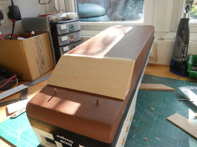

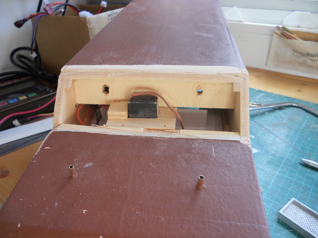

Well - after quite a while I have decided to try to fix the going astern problem. I have taken the saw ( and other tools Rolling Eyes) to the hull and removed the 'step'.
This is the angle I'm aiming for
I have fixed some filler pieces to give the required angle.
I have no access to the inside in this area so I will have to be creative in sealing it up. Much filler I think as I want a rounded transition from the slope to the flat hull.

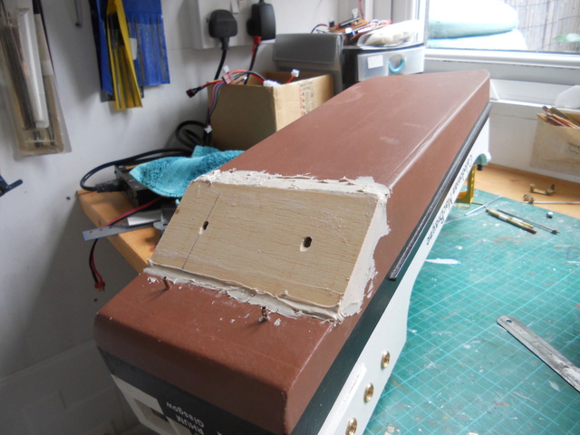

The new piece has now been fixed in place after drilling the holes for the prop shafts. Filler has been applied - and it will need more Very Happy Next job is to sand to shape to blend the new piece into the hull - as I say I am sure that more filler will be required before it looks right. lol!
