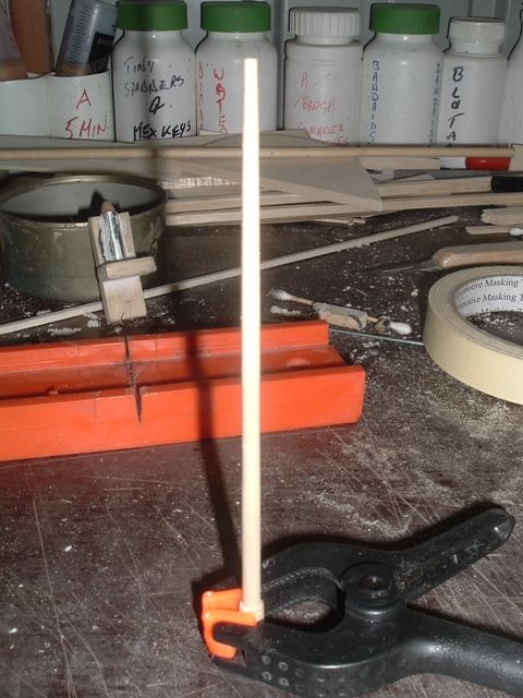

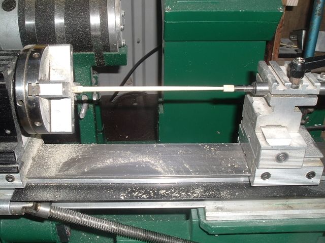

Today I thought I'd do something different, the wooden mast 120mm x 4mm at base and 2mm at top starting with 6mm dowel with 10mm extra each end.
With 1mm centre drill in my lathe I made a pilot hole for the live centre in the lathe put the dowel in the lathe and with 2 - 30mm wide finger nail boards went to work I had to frequently clean the nail boards with a brass wire brush as they clogged up quickly.
2 pic's
Posts : 2964
PostSubject: Re: Josie Olsen   Sun May 21, 2017 11:19 am
luvvly job matey.............usually takes me 2 - 3 attempts as I end up snapping the sodding things towards the end lol.
Posts : 3021
PostSubject: Re: Josie Olsen   Sun May 21, 2017 11:33 am
Talc on finger and supported it from underneath while one handed sanding the top.
It's good hard dowel too Birch I think.

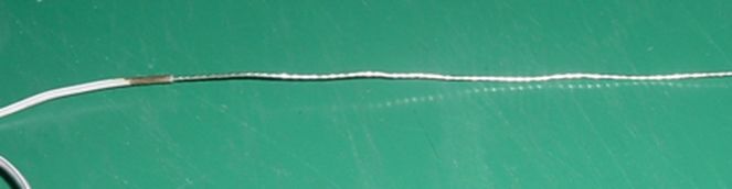

While thinking of the railings I decided not to make the timber ones shown on the plan, instead thought of stripping some fine wire and twisting it to look like wire rope while searching my wire draw I found some flat computer ribbon cable.
The insulation was a tad difficult to remove until softened with heat I was really surprised and pleased to find it already twisted and fully tinned with solder.
Posts : 2964
PostSubject: Re: Josie Olsen   Fri May 26, 2017 10:23 am
that's interesting, Damien..........I've thrown that stuff away before now thinking that I'd never had use for it.
it's amazing what we can salvage and use for modelling when "thinking out of the box" as the "Americanism" states.

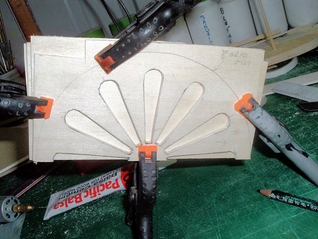

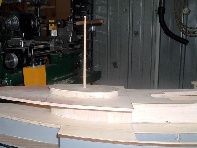

Mast installed in the aft top nott (plan doesn't say what it's called) will be painted and have the have stays added before installation.

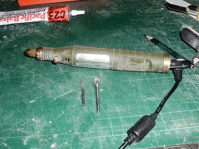

The wheel box fronts have been machined to shape using a handheld elec tool with carbide tipped tools and emery boards.
Fronts and backs temp glued together prior to band saw cutting the outer curve.
Posts : 2964
PostSubject: Re: Josie Olsen   Tue May 30, 2017 7:52 am
lovely work there Damien.
do you drill most of it out and then use the tipped bit to take out the rest, or do the whole lot with that bit.
Posts : 3021
PostSubject: Re: Josie Olsen   Tue May 30, 2017 8:23 am
10mm wood bit at top and 3mm at bottom the rest with the 3mm and 6mm burrs.

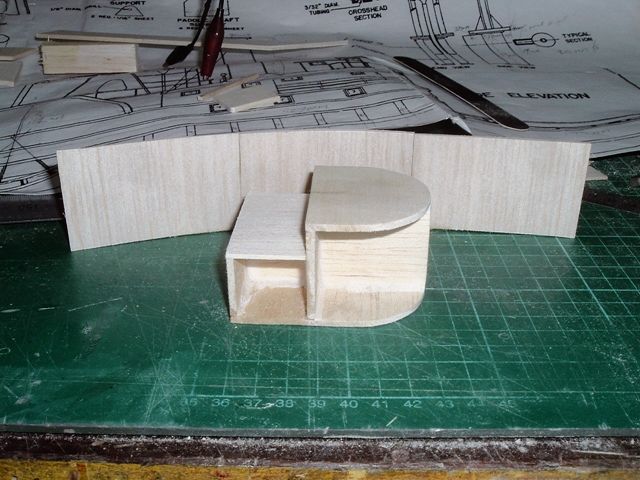

Didn't think I'd get to the shed today  after -2.5c or 27.5F coldest night for more than a year, the day's been a tad warmer.

Braved it for an hour or so until my feet went numb.
Managed to get the wheelhouse structure made and 3 pieces of 1.5mm x 3" balsa  glued side on for the skin.

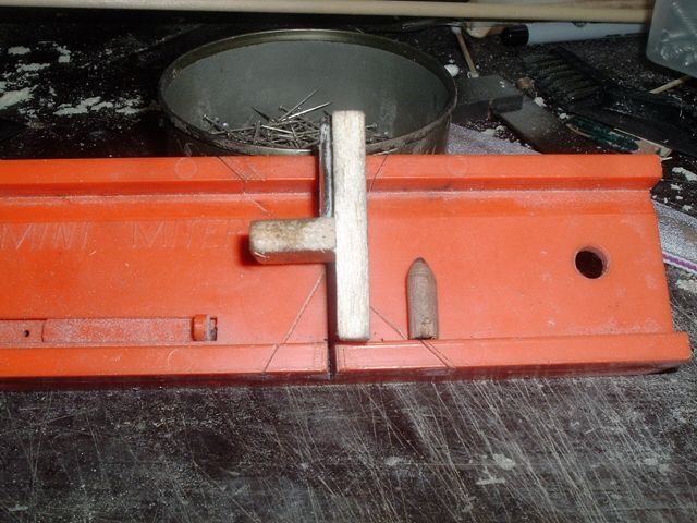

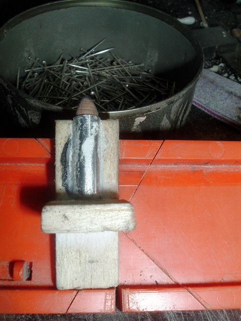

Tomorrow was a week ago came down with some bug not pleasant now wifey has it, got an hour or so today cut about 70, 4mm dia biscuits from 1.5mm ply with a Wad punch, to sit at bottom of the handrail stanchions they still need a 1mm hole drilled in the centre, I'll mount them on some board with double sided tape for the drilling.
Posts : 3021
PostSubject: Re: Josie Olsen   Wed Jun 14, 2017 8:40 am
Mounted and 28 x 1mm holes drilled a few off centre will be discarded.
I'm amazed that the top dollar 1.5mm ply delaminated on numerous occasions whilst punching and drilling.

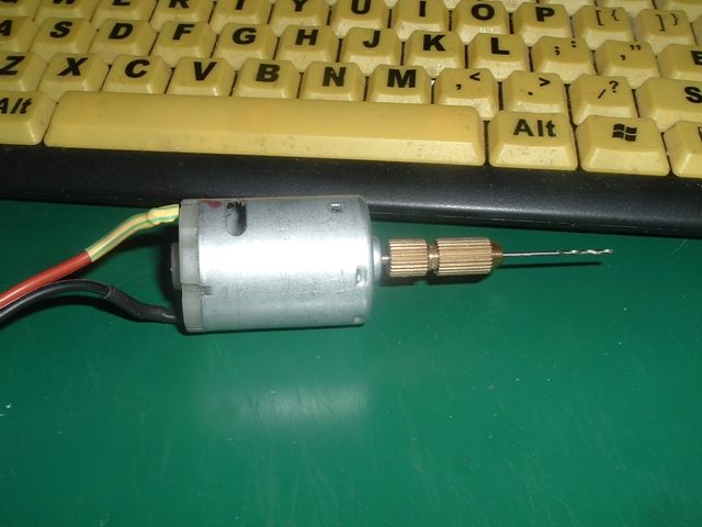

Made easier with this mini 12v 380 sized motor with a chuck with  to 2mm.

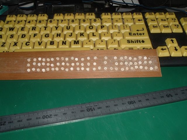

Seriously wishing I'd used thick card or styrene for the stanchion feet after another eight delaminated while preparing them today.
The dark ones at the rear i've coloured with Jacobean stain for use on the lower planked stern deck.

Found I had some .8mm from the back of a book of art paper I laminated 3 pieces with some sticky glue my wife Jo uses for her craft endeavours should be able to punch out a bunch of them tomorrow.

Grrrrrr the card also delaminated, searched my styrene bits draw and found some 1.64mm scrap as I need 46 I punched out 60 and marked centre with a fine point marker hopefully to find centre easier while drilling 1mm holes for the stanchions.

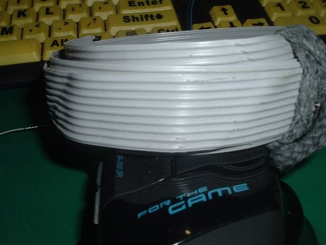

I'll start the railings tomorrow I had some old 20 wire computer cable after striping the outer I found 4 or 5 strands twisted together and tinned full length and around 1mm dia it'll make soldering them on a lot easier.

The aforementioned computer cable.
The wire being pre tinned was more difficult than I imagined it didn't like tight 90 deg bends, the beam fence is as good as I can get a bit of hand filing will make it look cleaner.
Posts : 1429
PostSubject: Re: Josie Olsen   Thu Oct 26, 2017 7:11 am
I've tried using something similar - it looks good but not easy to use.
Glad to see you've started modelling again Damien.

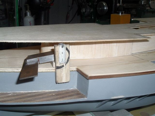

I'll have to paint behind the paddle boxes prior to fitting them as it will be almost impossible when fitted, hence the masking where they'll be glued down.
